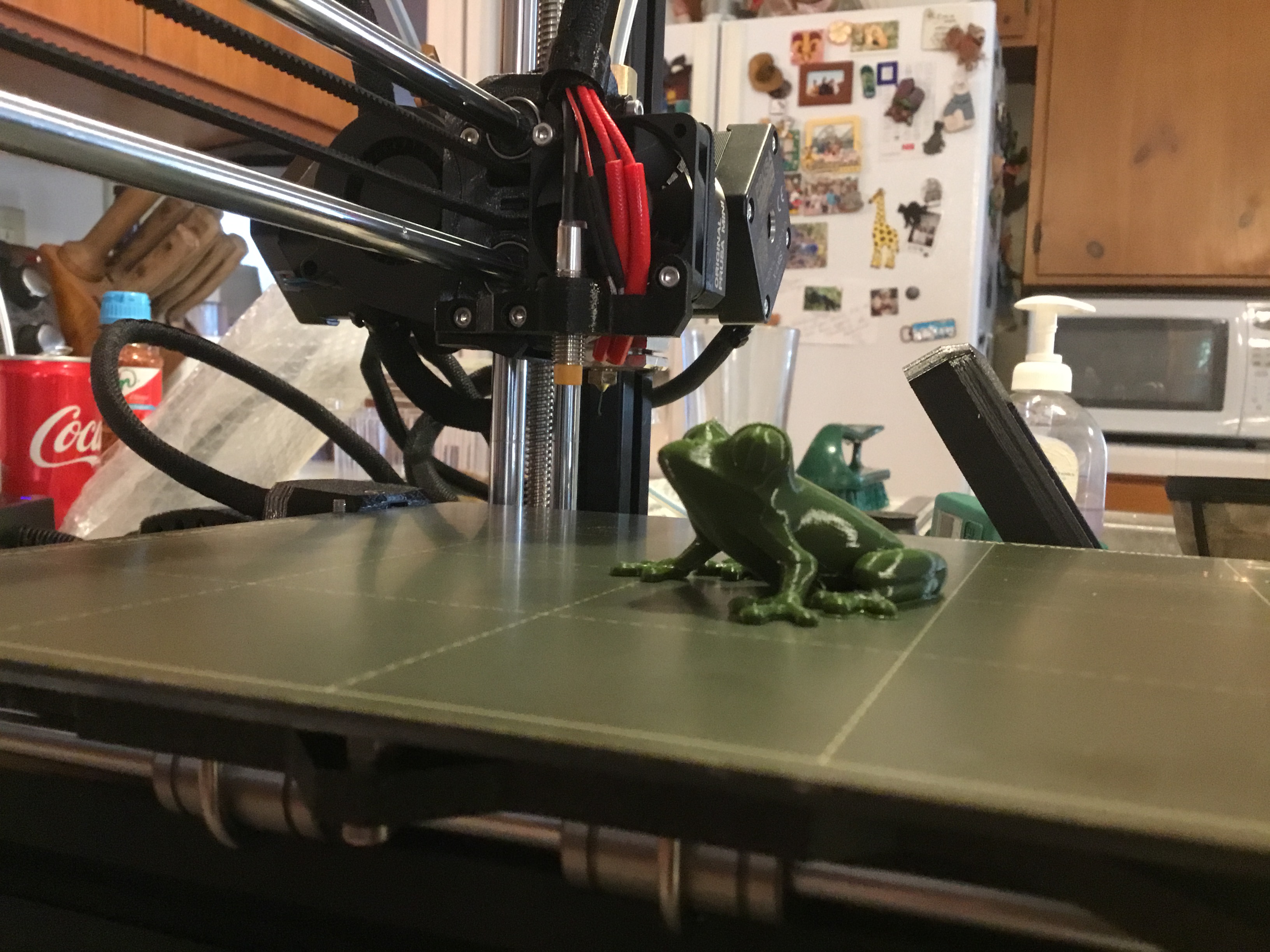

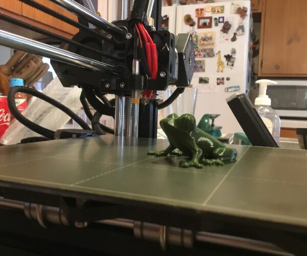

A big thank you for this thread! I downloaded and ran the calibration programs and discovered I was a close, but a bit too thin for PLA and PET-G. It only took a couple of runs to get right both sheets at .2mm. Then I discovered my extrusion rate was a bit too thin. A quick bump by 10% up in flow, and I'm getting an excellent first layers.
Now, I just need to work on dimensional accuracy in my printed models. Those aren't real stable yet. Are there any tutorials I can read or watch on the subject?
P.S. I love the title of the thread. I would have probably passed over it had it not been for "Life adjust z"!
