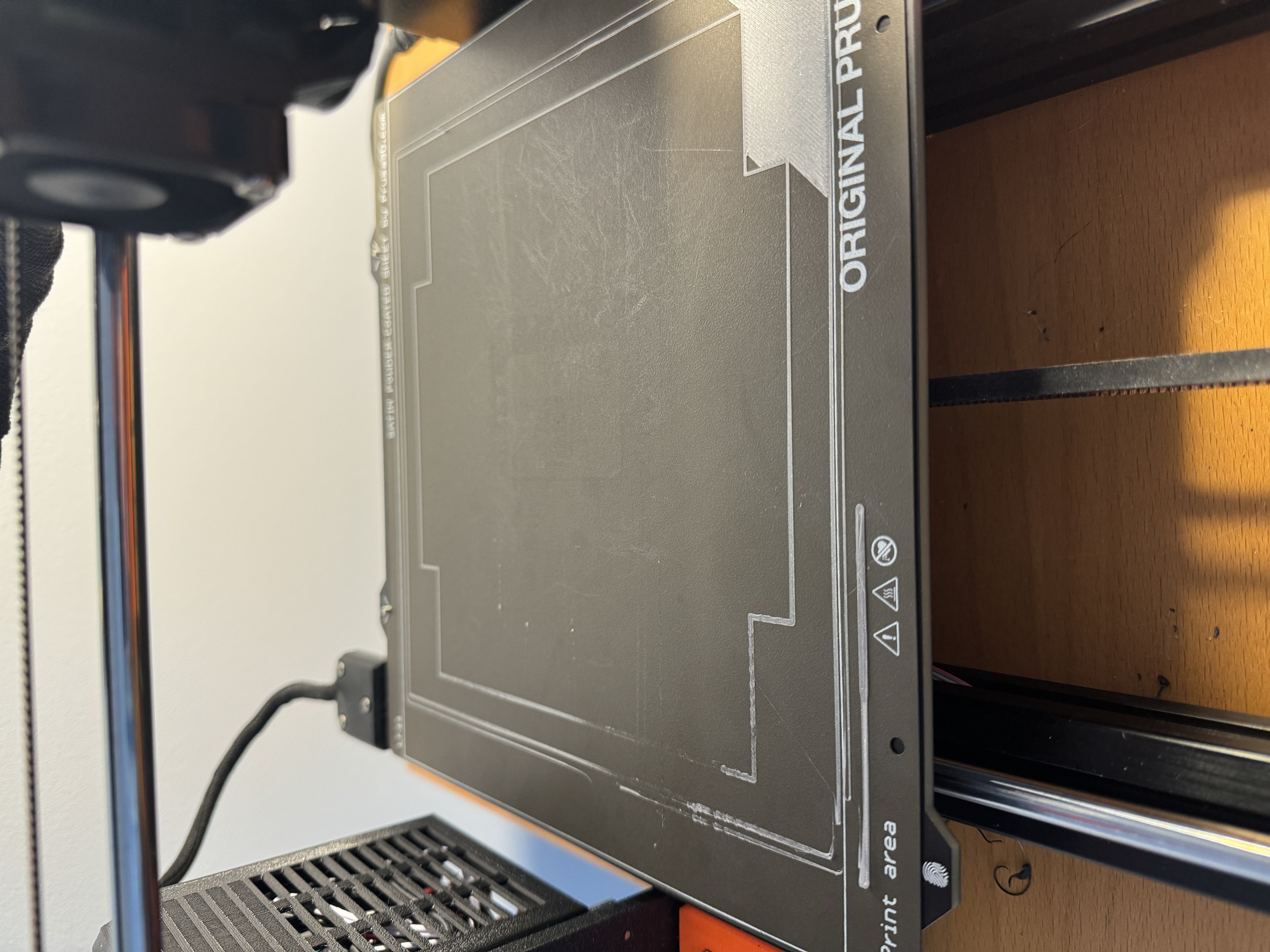

When i print in the middle of the bed parts are good, however when i tried a 1st layer test on the outer edges of the bed i get this as shown in the picture
i used bed visualizer to get within a variance of .04

Your first layer is a little too low and there are some visible fingerprints on the bed - try a thorough clean and run the built-in first layer calibration then show us the result *on the print sheet.*

its not too low on the right side only the left

Your picture doesn't show the far right ... at the edge of the picture it's still a fraction low.  Are you using 7*7 mesh bed levelling?
