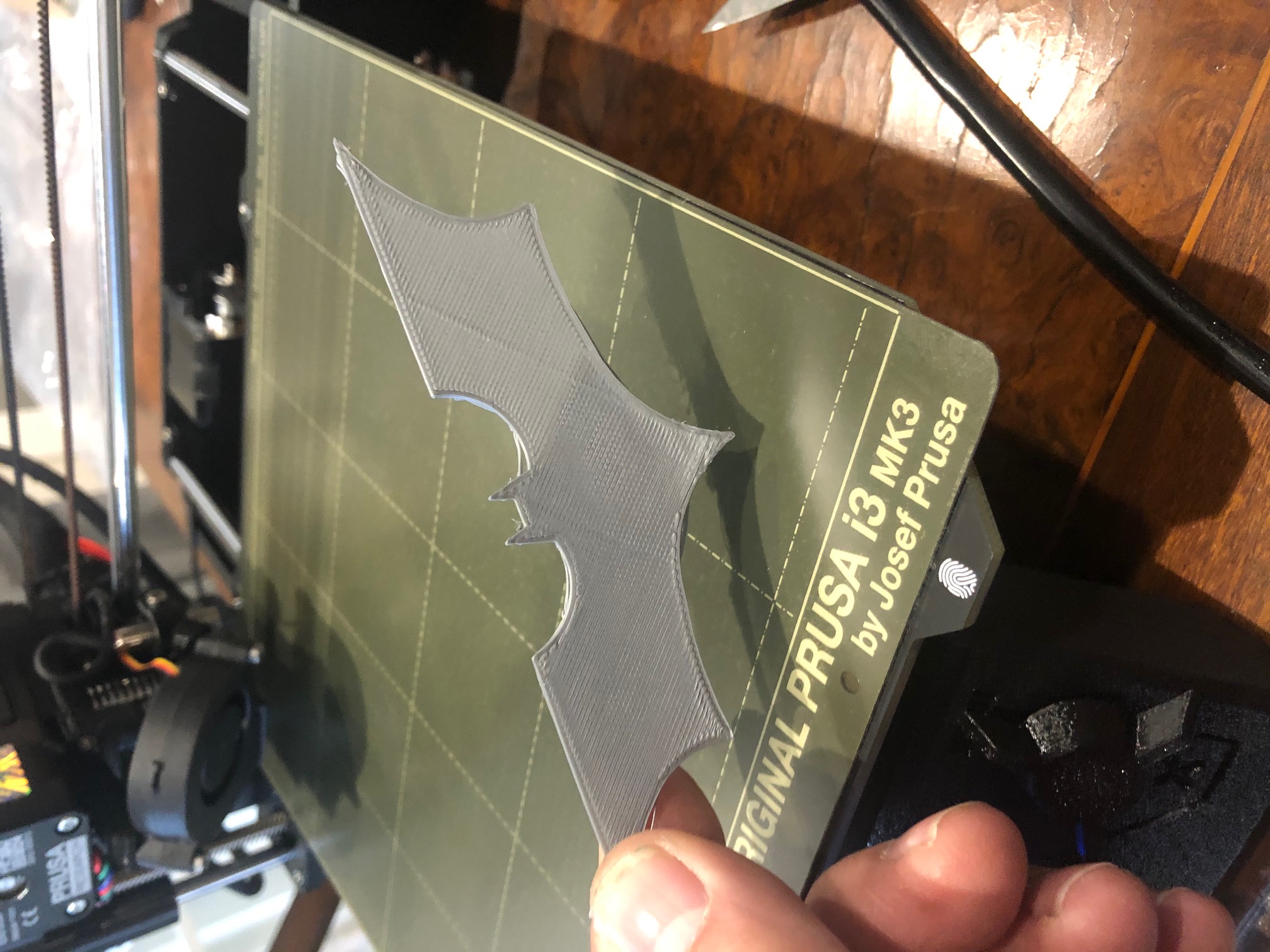

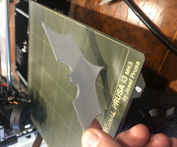

It took a bit, but I did get it connected and printed the batman logo provided the card. The bottom half was a mess but it seem to catch up and build the top very well. I tried printing something from Thingiverse.. and immediately the fail began. It seem to start.. I walk away, came back to a small rats nest underneath. I tried several times, after cleaning up.. I tried wiping the bed a couple times, flip the bed.. tried going back to the batman logo that printed-ish the first time.. and the fail continued and worse. I can get about 5-20 seconds of adhesion then it will pop off the bed and start the rats nest. I AM A TOTAL NEWBIE... sorry, I am smart but this isnt solved without help. First print top side

Looks like you might have skipped a few first-steps 😉
Do a first layer calibration.  Your goal is to get a perfect square.  During calibration you will  have to learn how to set Live-z. It will take a few repeat tries before you have the height dialed in.  Lots of how to here on live-z adjustment - it is your path out of the spaghetti bowl.

Here is my take on things for you right now.  That first layer is a mess - and until you master the live Z, you'll be a frustrated printer.  The very first automated calibration - the one with the sheet of paper - assuming you did that - is not the end of getting the new printer ready - it is the beginning.
What type of material are you trying to print - assuming PLA, and what sheet are you trying to lay a print down on.  The best combo for a newbie is PLA (not PLA+) and the smooth PEI sheet.  I'll assume you have that.  If you have the textured or powder sheet and no smooth PEI sheet, take a breather and order a smooth PEI print plate.  You can get them from Prusa for about $35 and $14 shipping (Special sheet pricing) or you can get them from Amazon from a number of vendors.
There is a choice on your calibration menu called "first layer calibration" - which is different from initial calibration.  You need to think of your printer as a highly specialized robot that needs two or three adjustments from the out of box state.  Initial calibration gets the head to be able to stay within a piece of paper from the bed.  First layer calibration lets you dial in a specific filament/sheet material type combination.  And that gets you ready to start trying to print a thing.  Live Z is your friend - for example, suppose you have a buddy that sent you a pattern that they print all of the time.  They may send you a .GCODE file (throw that away if you have a different printer, or are using a different brand of filament).  GCODE is printer/filament specific.
So what you want is either an STL, or a .3mf file.  Load that into prusa slicer.  Let's start with a 20x20mm 6 sided cube.  That kind of design helps you dial in a number of settings.   Keep at that one design (cube) until you get it perfect.  Dial in first layer calibration first.  You are going for a solid one layer sheet and good stick.  There is a knob on your printer that allows you dial the head up or down 1/100 mm at at time - it is called live Z.  You cannot do a effective first layer calibration without using it.  You could watch it print the calibration pattern and never know about live Z, and then wonder why your prints crater consistently.
To use Live Z, the printer has to be past the wipe and past the bed mesh leveling seq.  At that point, while the calibration print is starting, click the knob on your control panel.  Then scroll down to the "Live Z adjustment" setting, and push on the knob to select (it will click).  Now you are able to adjust Z
Counter clockwise will take the head closer .01 mm at a time.  So be super-aggressive    It isn't unusual to change the Z value by 30, 50 or even 100 little moves.  You'll probably have to do the first layer calibration sequence over a few times before you even get close to the best live Z for your situation (combination of printer, material type, color, brand) - but at some point the lines start to not fall off the bed if you push on them.  And the final square starts to actually print.
I assure you, looking at your pictures, that you are in the ball park.  You just haven't succeeded in getting your first layer down to having the head close enough to the bed to successfully print.  That first layer determines how much "stick" the print has to the bed - so if you don't get it stuck enough, at higher heights your prints will always fail in a variety of colorful failure modes.
For now, focus on getting a first layer far better. That bat-man symbol with the icky down side.  Concentrate on that until the bottom layer (through live Z) is better than the top layer.  You can even use the batman pattern to try to calibrate - live z is available to adjust any time after a print is past the mesh calibration and the initial wipe.  Push the rotary knob to get that click - and you'll see you can adjust live-z on any print.
Dial it in until it sticks.  Then after the print, see if it is smooth on the bottom layer.  If not, dial it closer. Until that first layer starts to have waves in it and filament globs up on the nozzle (you'll need a good nozzle cleaner - good patterns on the prints site for ultimate nozzle cleaner, etc).  If you see waves in the fist layer, clockwise live Z by .10's.  If it's not sticking, counter clockwise .10's at at time.
What you need to do is become proficient at calibrating your fist layer.  We're looking for no stringiness (too high).  Forget about any pattern any buddies send you until you can do this.  your printer is unique.  Your filament brand effects the outcome.  The color effects the outcome even within the same brand.  This is not easy = but it becomes second nature once you master knowing the importance of a good first layer.
If you can print a calibration cube and it has a nice bottom layer, and a nice top layer (at 20mm) - get there.  It may take 1 print.  It may take 100 - depends on how bold you are with adjusting your Z.  Aggressive moves in Z pay off quickly.  Sometimes I need to change my Z by .50 mm (which is extremely aggressive - lots of turning of the knob in live z node.  Remember counterclockwise is closer to the bed.  Clockwise is further away.  If you are seeing your bottom layer in separate strands, rotate that knob counter clockwise three of four full turns at a time - that is what I mean by being aggressive.  It is too easy early on in your learning curve to be too mamby-pamby with the live z.
