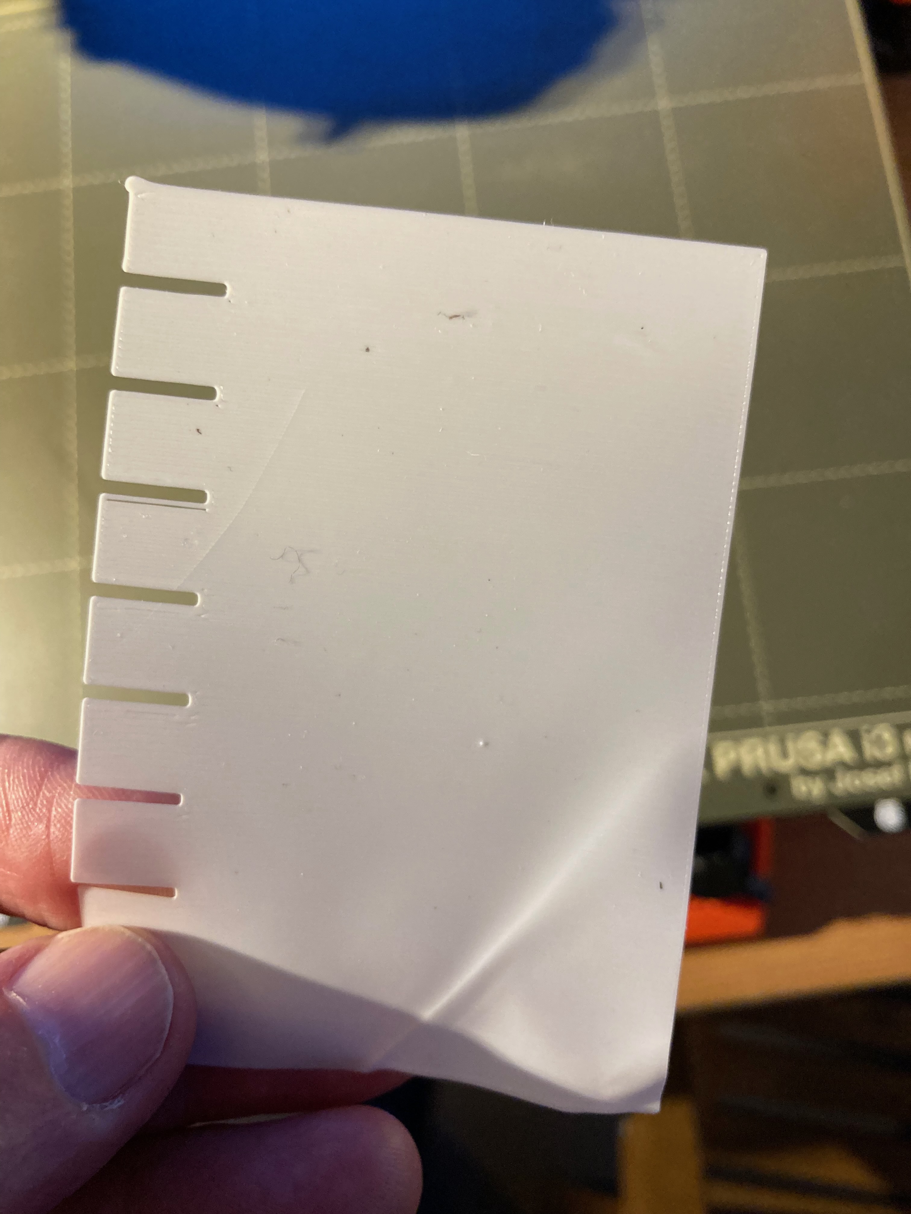

I run this when I want to get my Z-offset dialed in. Takes 11 minutes. I now start the Z-offset at -1.6 and I may not have to move it from that value.
The design is such that you can make an adjustment for each section, delimited by those little cuts. So start where you like and adjust by .50 or .10, whatever you like.
This is a result from today on a newly arrived pre-owned machine:

Thank you for posting Paul. I have downloaded the file and will work on it. Being a relative newbie to dialling this in, it's taking me some time (and probably to the amusement of others). But the education is invaluable. 🙂

first-layer-adjustment
I'm pleased with that. It almost looks like to was done by someone who knows what they are doing. lol Thanks again Paul.

That looks very good. You may find you need to do that for every sheet or type of sheet. My genuine Prusa sheets are -1.6 but my 3rd party ones need to go down -1.825. But it's nice to have something reliable in all of this.
