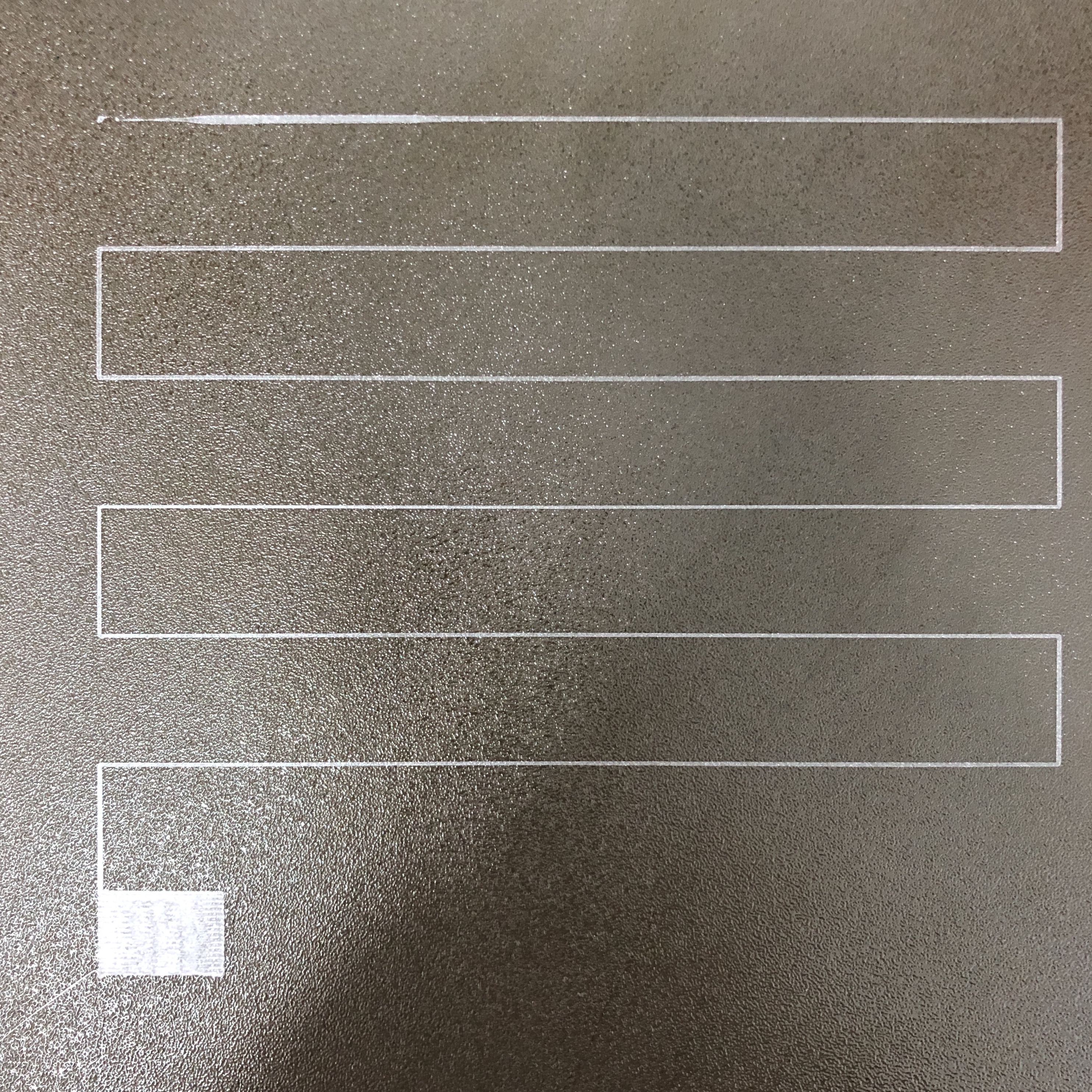

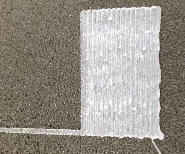

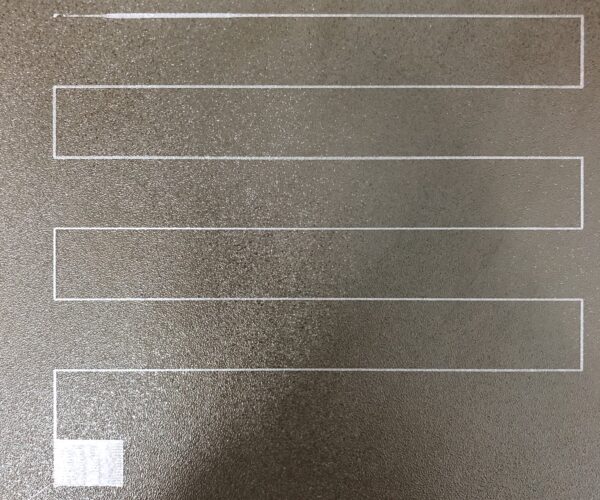

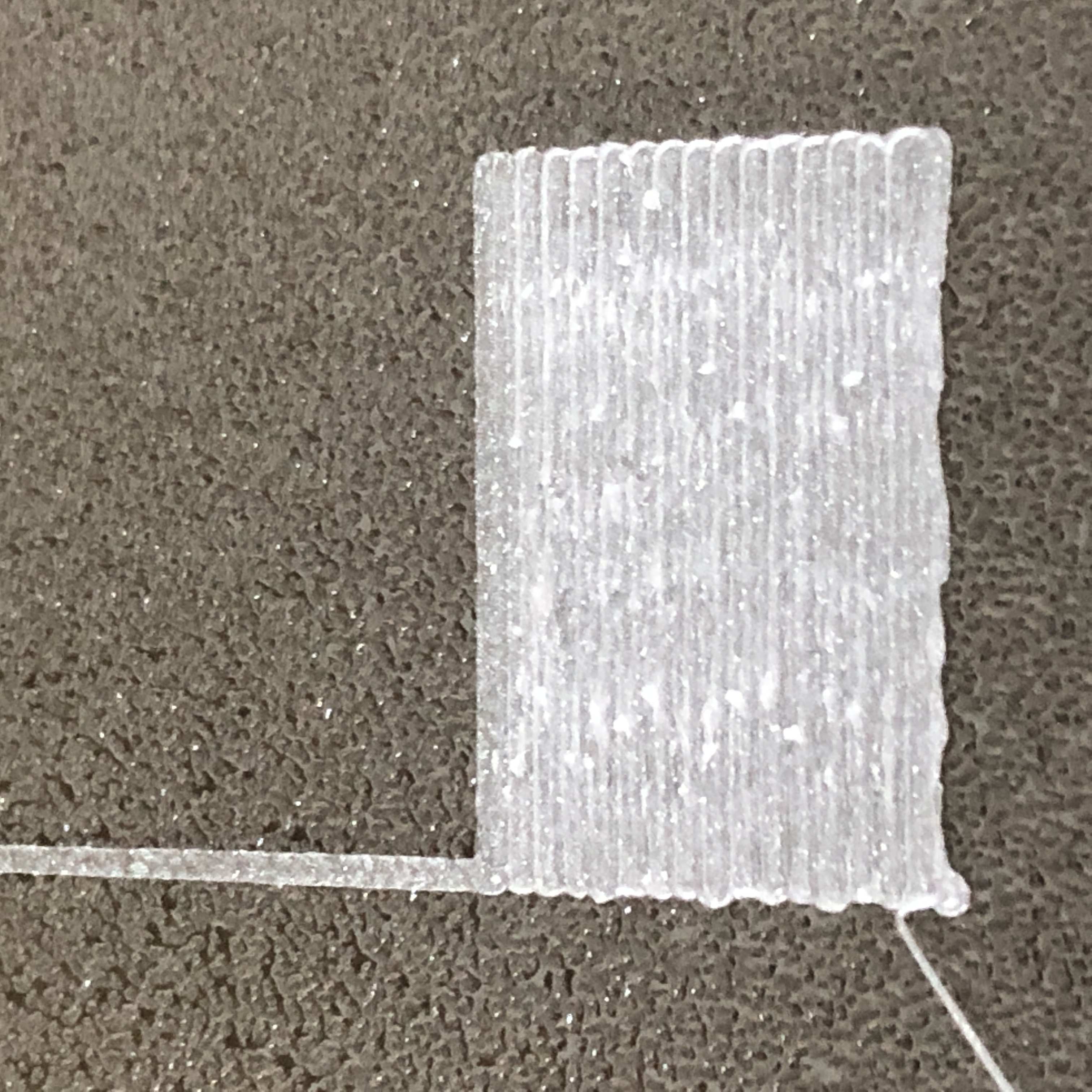

Trying to get the first layer right.
I thought it looked ok. I didn’t have a tool to measure it.
First layer adhesion First layer
that square does have one straight side and one janky side.

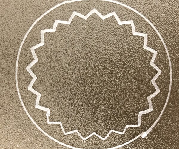

Then I noticed a shift while making circles. There is a shift on the low left and upper right.
Circle shift Circle shift
I just cancelled the print to focus on the shift. If I let it keep going, some of the gears end up connected
I double checked the xyz but it just reports ok.
Best Answer by WgnMn:
I might have solved this. I started going over the x/y movements very carefully and realized that the x axis motor gear was not completely tight.
This caused the small shift while moving diagonally.
