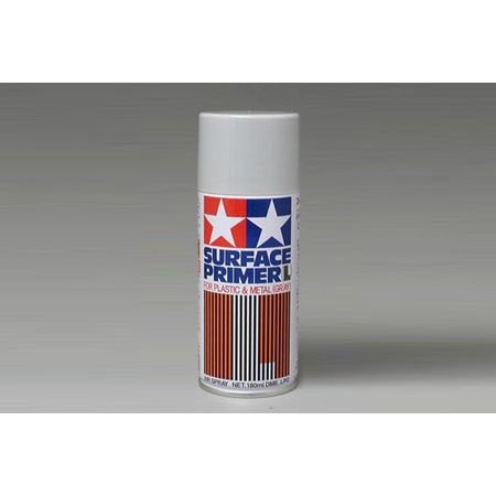

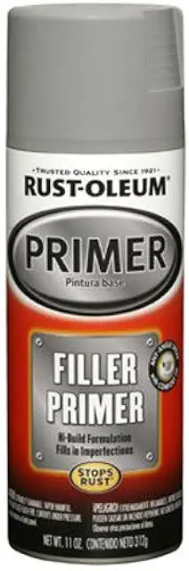

you don't need to fully sand away every trace of the layer lines, use a high build or regular spray on plastic primer as folks that make plastic model kits use as their first step after light sanding I tend to use this primer for everything I paint
modelers tend to use this
Tamiya TAM87042 87042 Surface Primer L Gray, 180ml Spray Can, Light Gray
https://www.amazon.com/Tamiya-Primer-Gray-180ml-Spray/dp/B0000WS014/ref=sr_1_fkmr0_1?keywords=tamiya+high+build+primer&qid=1555008691&s=hi&sr=8-1-fkmr0
