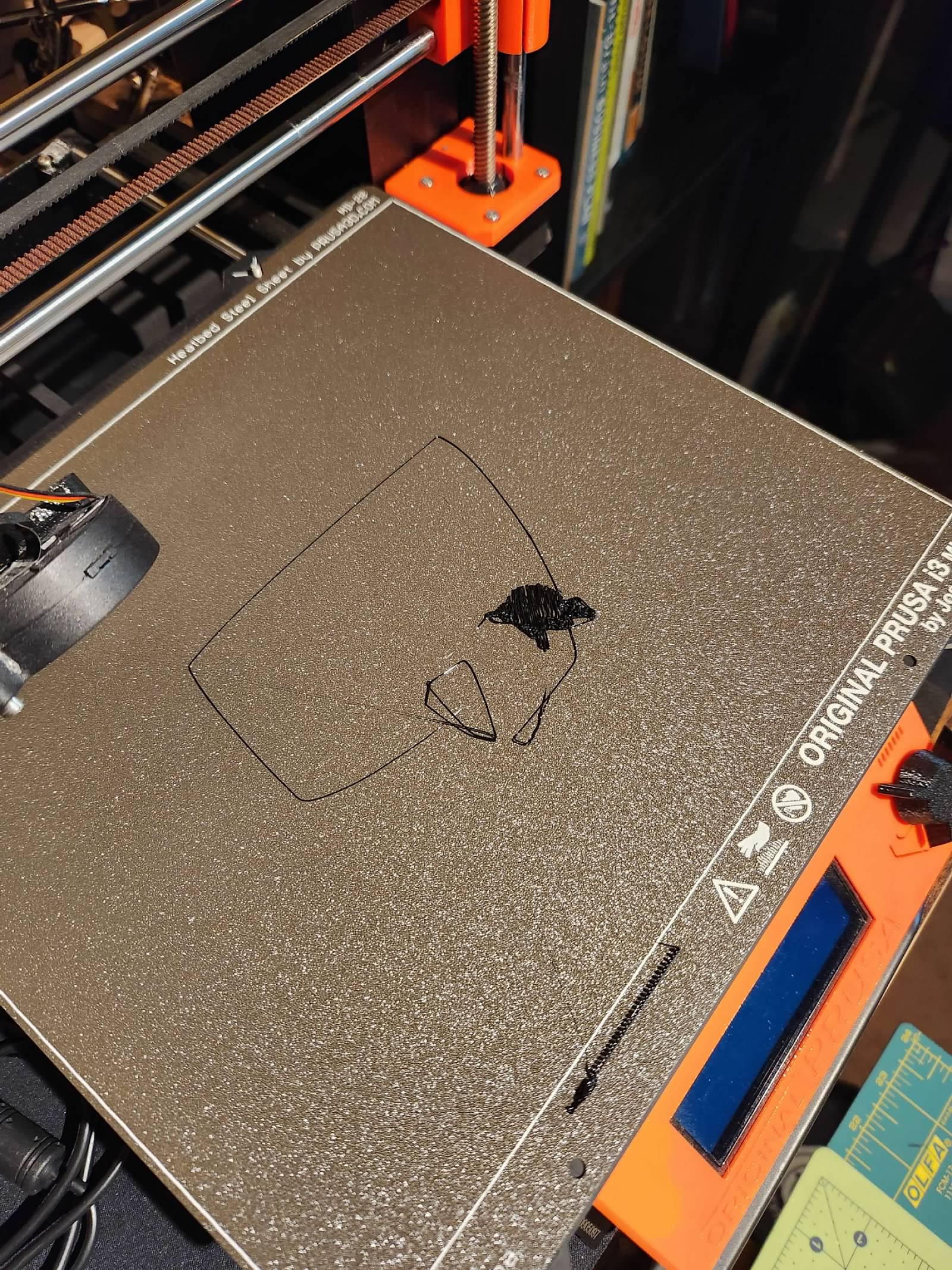

Here's the first layer cal - what a mess... I wonder if something has gone pear shaped with the tip - it's still the original one...

Maybe the tip has  worn shorter ...  that looks like your Live Z height is too high.
Have you by any chance changed the build plate?
If you were previously using a smooth build plate and you have changed to textured build plate without re adjusting the Live Z, you can end up with this sort of problem because the smooth build plate is thicker than the textured build plate.

Agreed.  Go closer. At the end of the calibration you are aiming to print a single layer postage stamp sized *sheet*. It should be possible to peel it off in one and fold it without the threads seperating. If it breaks into lines it is too high, not squished enough. If it is a single sheet but with wavy lines or drag marks on it you are too low.

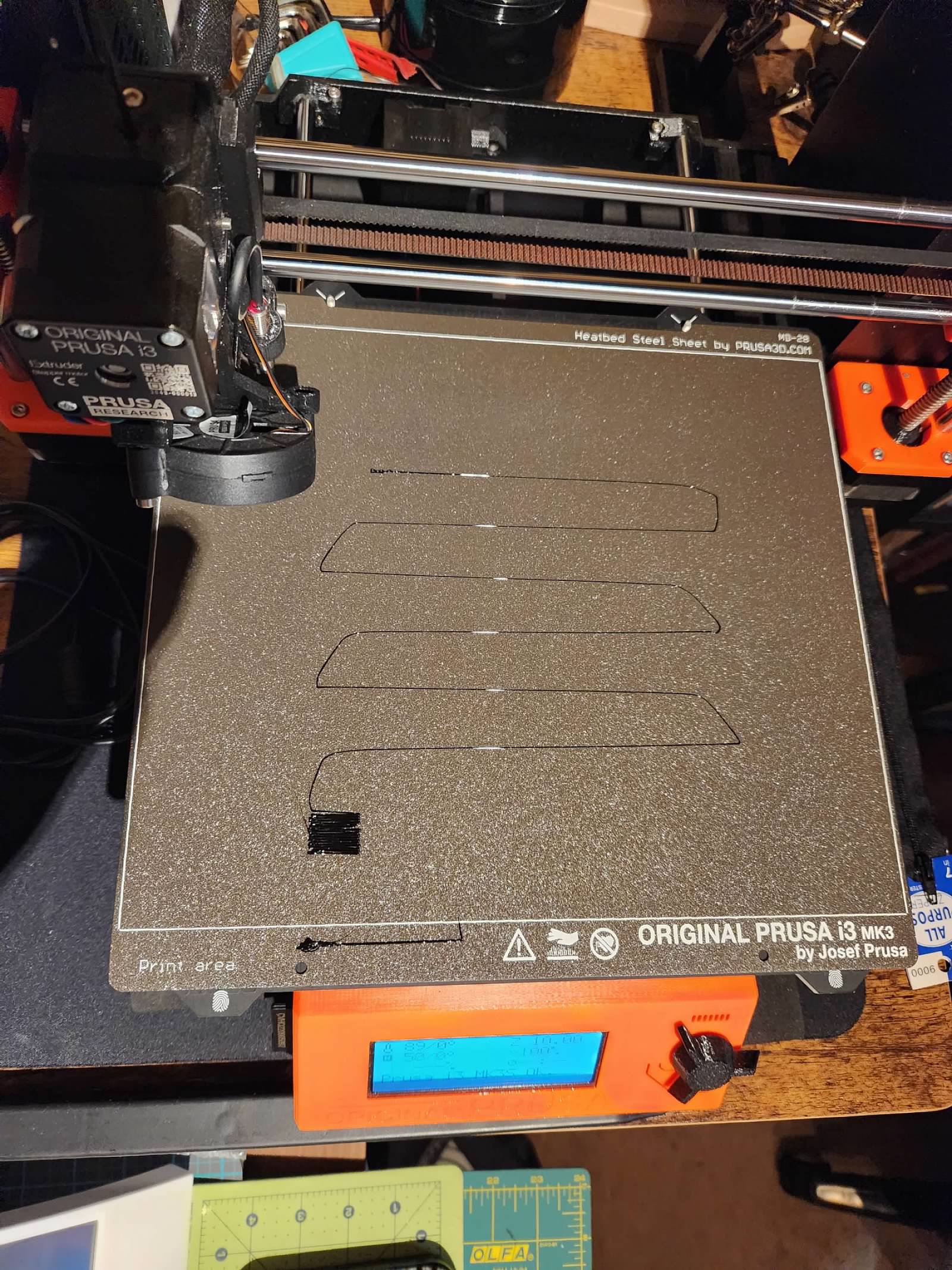

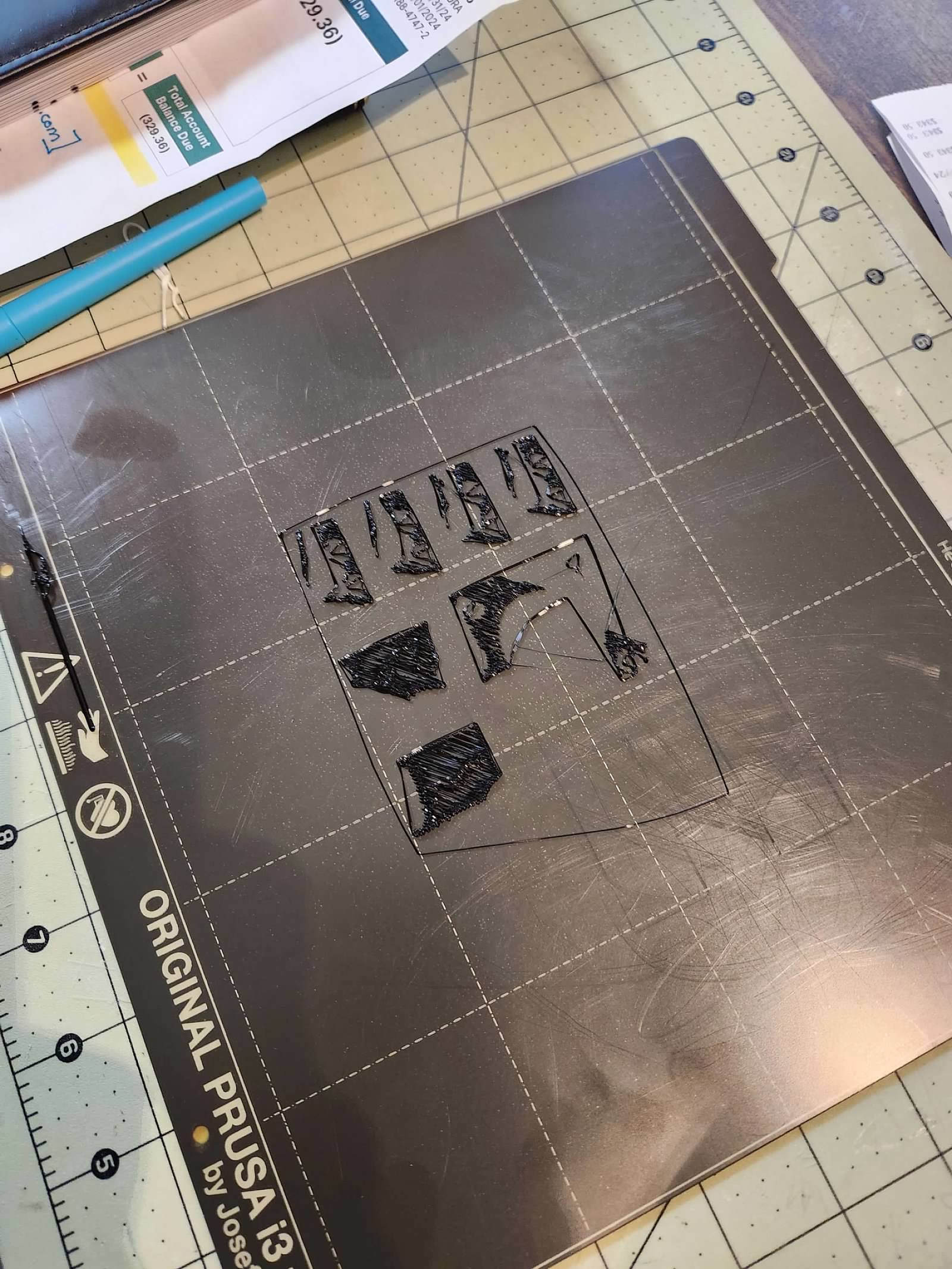

I've tried the first layer calibration several times at this point. Either it spaghetti prints too high, or there's a brief window where it spaghetti prints and sort of sticks, or you go to low and it starts printing around the nozzle and pulling everything off as it goes. I'm at a complete loss at this point.

Most probably still way to high. You are still printing "in the air" thats why this strange stuff happens (sometimes sticking, sometimes wrapping around the nozzle...)
Redo the build in first layer calibration continue to go lower (increase the value displayed), take a pic, post it. This is the way!

If in doubt run the built-in first layer 'Z' offset calibration and show us the result *on the build sheet*.  You are probably still too high.
