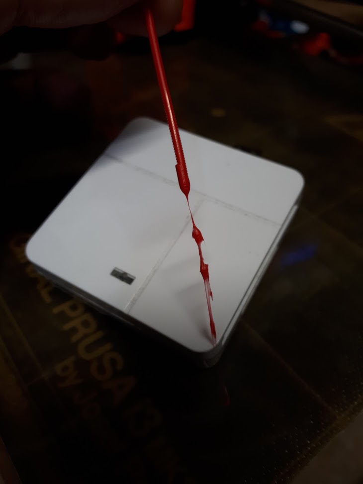

Sorry for joining this conversation. I started reading this thread some days ago, but it seemed to be a other problem. After annoying days of pain and try and error, I restarted reading and found travis' description of the problem, an his pictures. And it IS the same problem.
So ... sorry for bringing in new problems 😉 but perhaps they are already solved.
I enter the same problems while printing ONE color. 4 colors are actually far, far away ... 😉
Printing starts, all fine. After about an hour the extruder motor starts skipping, even more, until everything is jammed, the result in the heatbreak looks like that.
I tried higher temperatures. No luck.
I tried less retraction, reduced from 4 to 2. Works a little better, but stucks anyway.
I tried less retraction, reduced to 0.8. Bad idea, same result, but strings added.
My next try would be to improve cooling of the extruder. A bigger fan or something.
But when I understand right, the speed of retraction is the problem? 😮
This would be an awesome easy solution.
Postato : 27/07/2017 2:46 pm

Hi Daniel
Not a problem, this is the reason for the thread.
I don't think your problem is related to slicing, but it may be. I think the first thing you have to look at is the interface between PTFE tube and heat break. You need to find out if the heat break has a chamfered seating for the PTFE and if it does, the PTFE will need a ma matching bevel/chamfer.
Then you need to insert the PTFE tubing so it fits tightly against the heat break - unscrew the heat break fromt eh heat sink by half a turn, insert and lock the PTFE in place and tighten up the heat break into the heat sink.
As for retraction speeds, you could try setting 25 or 30 mm/s and a distance of 3.5mm. As this is the easiest thing to do try it first to see how it goes.
Peter
Postato : 27/07/2017 4:39 pm

Hmmm. I got it to remove the nozzle. It was very thight, even when it's warmed up.
But I wasn't able to separate heat brake and heatsink. No way. 😥
I'll reassemble it, an try a lower retractionspeed.
I think that sometimes, if the top of the heat break get a bit too hot, the thermal paste can harden a little.
