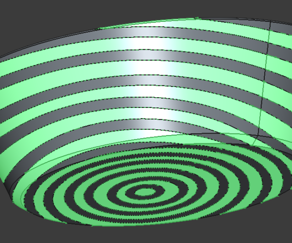

Hi, printing bowls and larger radius edges never turn out well Supports do not seem to help at all.
The lid was printed top down onto the bed.

The Slicer can't fit support under the lower part of the curve - there is no room.
When designing for 3d printing avoid fillets and use chamfers instead.

Thanks, I guess printing bowls is just not a thing then.
