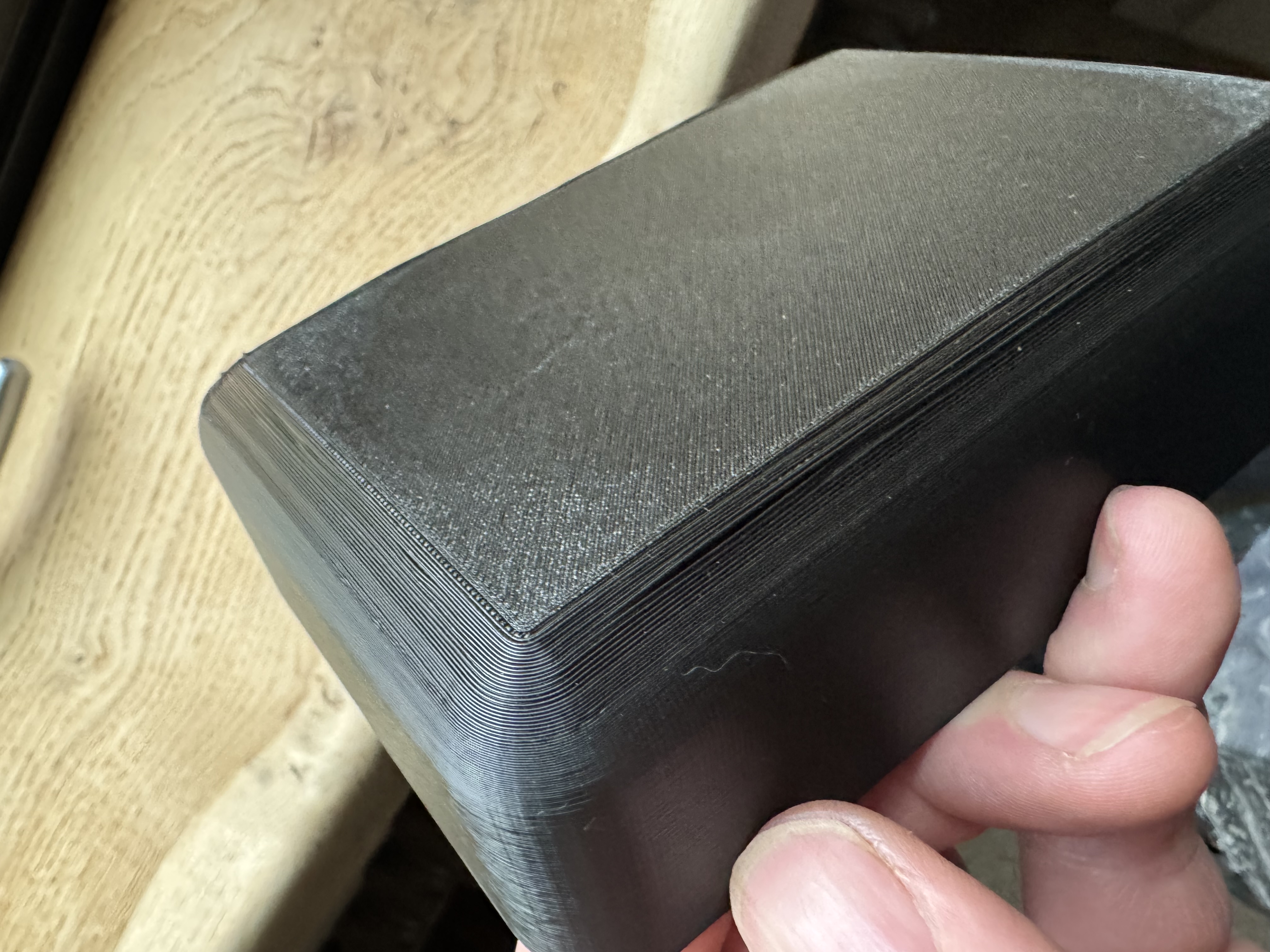

Hi, printing bowls and larger radius edges never turn out well   Supports do not seem to help at all.
The lid was printed top down onto the bed.
Thanks.
Posted : 03/10/2025 3:05 pm
The Slicer can't fit support under the lower part of the curve - there is no room.
When designing for 3d printing avoid fillets and use chamfers instead.

Thanks, I guess printing bowls is just not a thing then.
Posted : 04/10/2025 9:38 am
Bowls are OK, but you need to consider profiles like these:
Vertical base and 45° chamfer.

Or use sanding.
E.g. a bowl I designed: The problem is inherent, I made the color thicker at the edge to allow sanding
https://www.printables.com/model/1537173-patterned-small-bowl-for-mmu#description-images.cc153822-a31d-4c64-9b73-3e9edaaa2449
The green one comes straight from the printer (still shows some traces from supports). The red bowl in the background has been sanded, and this could be done more diligently (most importantly, wet).
Posted : 11/01/2026 11:55 am
... but these would also print better if the curve was replaced with a chamfer.
