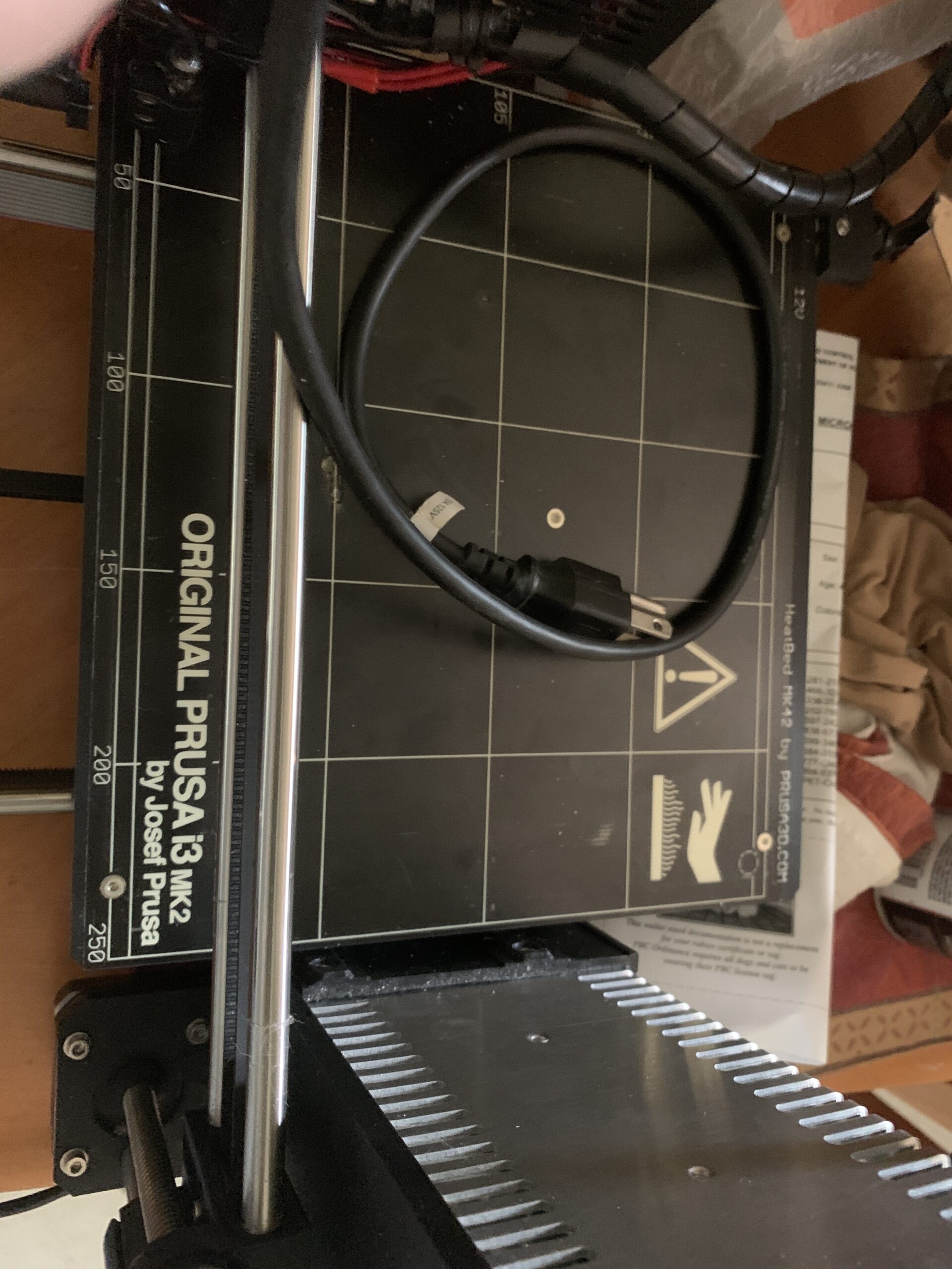

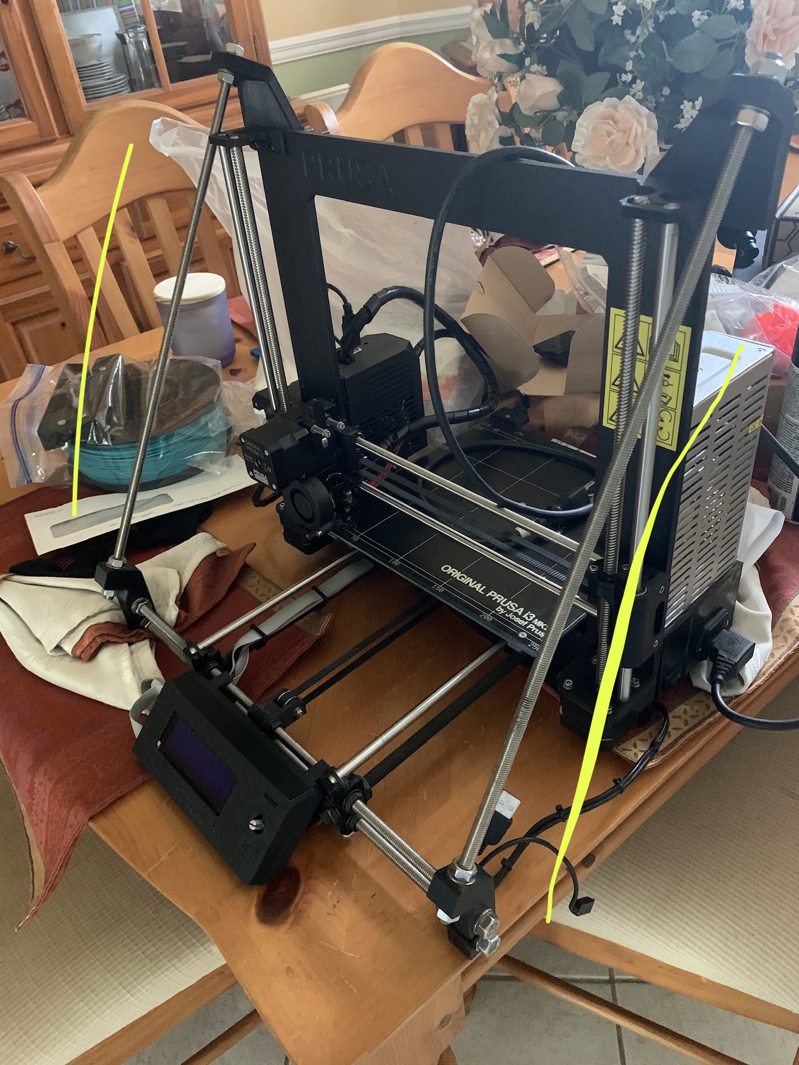

I try to go online to look up what the orange stuff is (I’ll provide a pic) and etc. But I realize that the printer I have had a diagonal bar while others do not. Is it put together wrong? When I look up the words below, the diagonal piece isn’t diagonal (I tried showing you in yellow lines)

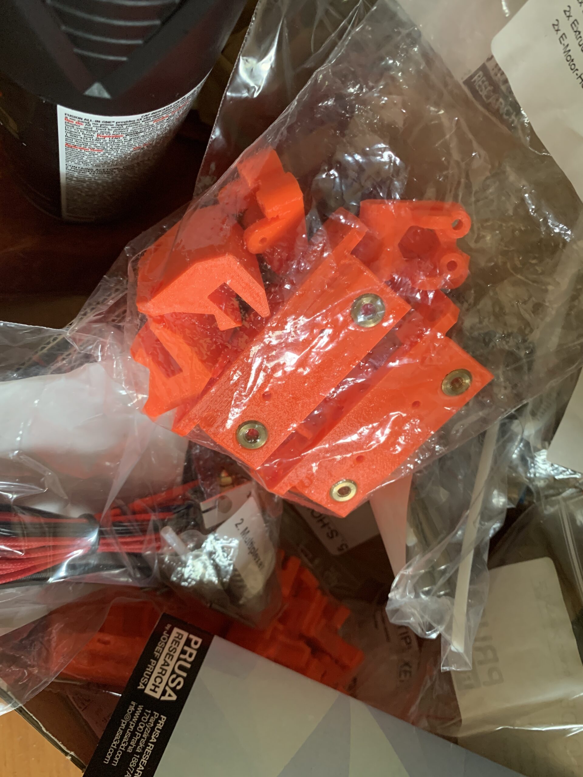

I have a box of orange different pieces. Can you please tell me what these are? The box doesn’t say what they are (another box says ‘motors’ on it but this box with orange pieces doesn’t say anything). Are these pieces an upgrade kit or something? Or are these just like for decoration?

The diagonal bars are a community instigated upgrade, designed to make the main frame, more rigid.
the orange parts appear to be the parts for a multi material unit version 1  (MMU1)
 a 4 filament automatic filament changer
Mine, doesn't have the extra diagonal braces that yours has.

RE: Hello. I’m not sure where to post but I have a box with orange pieces
Oh so it’s not built wrong, it just has extra braces. Cool
oh so it’s like an upgrade kit? ‘It is supposed to print only one color but u assemble and make it do more than one’? Oh cool
thank you
Now that I know what it is, I can look how to assemble it.

https://help.prusa3d.com/wp-content/uploads/2021/05/Original-Prusa-i3-MK2S-to-MMU1.pdf
difficult to find assembly instructions these days!
