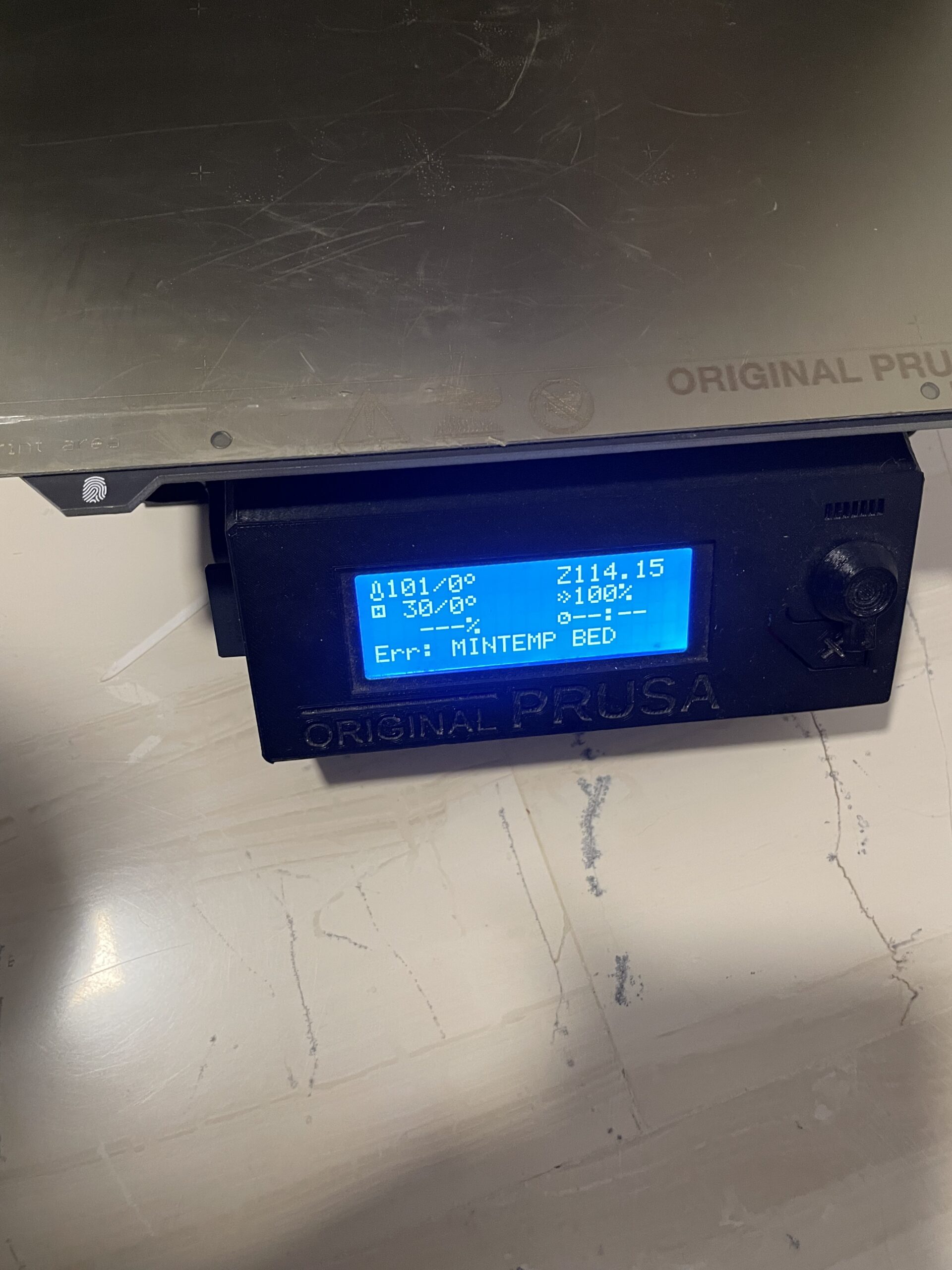

Now to the issue at hand, since then, each time I print or try to load/unload filament, I get the mintemp bed error (around 30-31C), but if I power cycle/restart the printer and try again (while the bed is still warm from the first try) it does successfully finish the print. If I let the bed cool down  (around 18-20C bed temp) and retry I get the mintemp error again. Attached are images before (idle printer) and after (the moment the mintemp error appeared).

From my understanding, the Mintemp error will fire if the bed temperature readings seem erroneous (the purpose is to protect from fire if the thermistor malfunctions), e.g. the thermistor resistance reading is off the charts. This may happen if the ambient temperature is too low (falling in a temperature range that the thermistor does not read correctly, this is what you are describing) or the thermistor is faulty. My case, I feel, is somewhere in between, the ambient temperature is not that bad and the thermistor does work if preheated. My guess, answering my own question, is that the thermistor is malfunctioning in the 3-30+1 C range, or there is something going on with the firmware that I used.
If I remember correctly, the thermistor is part of the bed, since the printer is so old, I will probably leave it as is and live with it.

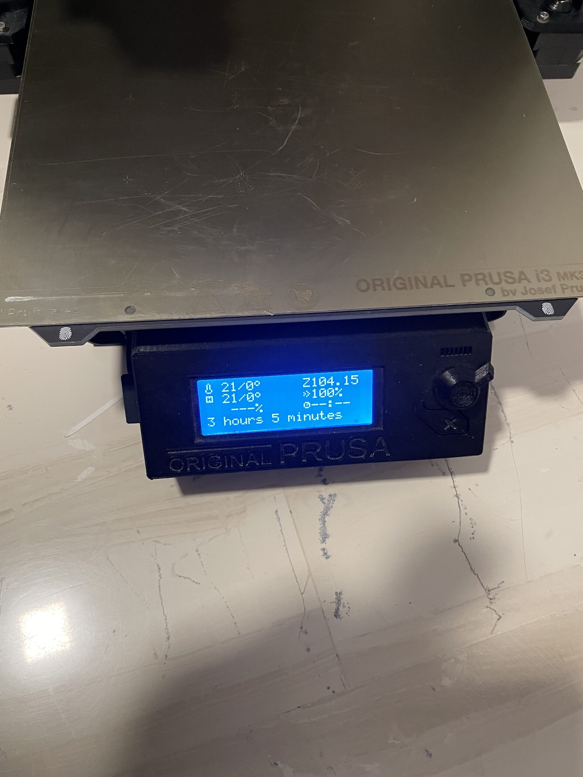

Update: I remember I ran a diagnostic before updating and it passed.
I ran it again and it failed with 'sensor not connected' error, but the selftest will pass if the bed temperature is preheated ~30C.
I tried re-flashing but I had the same results, it keeps nagging me that before the update the selftest was a pass...

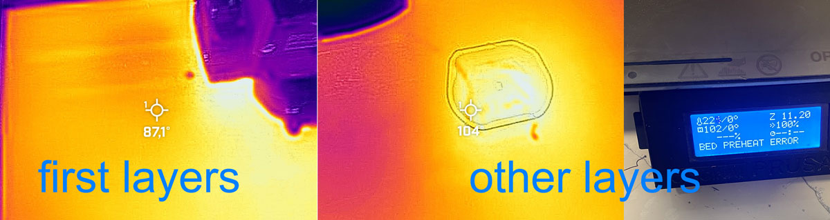

I took some pictures with a Flir One that has a accuracy of +-/3-5%
1. During the first layers the Flir reports a temp of 87-93C depending on the area of the bed, in the printer lcd the temperature reading is 100/100C
2. When the printer entered the 'other layers' phase the Flir device reported a max temp of 104C (center of the bed) and the printer LCD 104/110C (the moment the printer threw the BED PREHEAT ERROR).
So it seems that the printer fails to reach the 110C bed temp and then, after a while, throws the BED PREHEAD ERROR.
Given a maximum 5% error to the Flir readings it seems that the sensor is somewhat reading the bed temperatures (albeit on the low side and after the bed reaches 30C, see the Mintemp error above)
