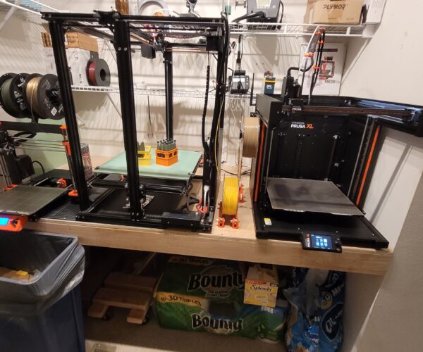

P.S: I'm attaching a pic of my print room just for giggles. The "room" is actually a spare closet  I commandeered. And yes, that Mamorubot SX4 is a dinosaur - it doesn't put out the prettiest or fastest of prints, but the old man hasn't let me down especially at it's 400mm x 400mm x 500mm build volume. I really wanted to put the two Prusas next to each other, but the filament roll locations and limited space make it tricky ... rearranging (and organizing my shelves - geez!) will be my summer project

Ok so first of all - sorry for messing up the last transmission and not posting the picture of my setup, apparently I'm not proficient enough to do this entirely from my cell phone, so I have to do it from my desktop. Anyhow, here are the pics I made reference to last time ... and actually are incredibly relevant to what I found out today!!
Ok so - I SOLVED THE ISSUE!!
Since my last posting (again sorry for the tardiness, but I've been on travel quite a bit and truth be told - also easily distracted).  Yes yes whatever, get to the point man!  ... so there is absolutely nothing wrong with the PrusaXL - the problem is it's neighbor!. Yeap that big Mamorubot SX-4 (now Hieha) right next to it shakes too much while printing that it throws off the very sensitive load sensor on the PrusaXL!!
This is what the Prusa knowlegde base page says online (at least as of today - not sure when they updated it, but have a feeling others may have had the same problem and they had to post something about it)
so there is it - problem solved ... ta daaaa!!
I've been running all three printers at the same time, so that's not an issue - it just means that I can't "start" a print on the PrusaXL if that big Mamorubot is printing at the time - which is ok, I just pause it until the PrusaXL finishes it's start up sequence and then all is well in the world after that 😉
