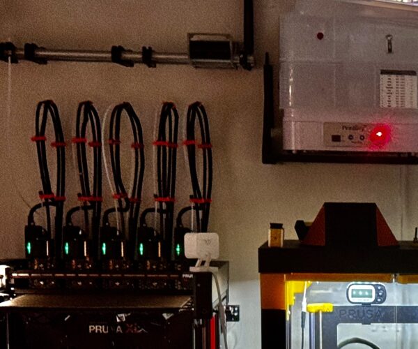

Because of my constraints I can only use three spools on the left (but with a different spool holder https://www.printables.com/model/757248). For the other spools I use a RepRack system wallmounted above the printer https://www.printables.com/model/129024 with a simple PTFE tube adapter https://www.printables.com/model/485092
I also use a RepRack based shelf https://www.printables.com/model/478493 to for a PrintDry dryer to feed from the dryer as needed.

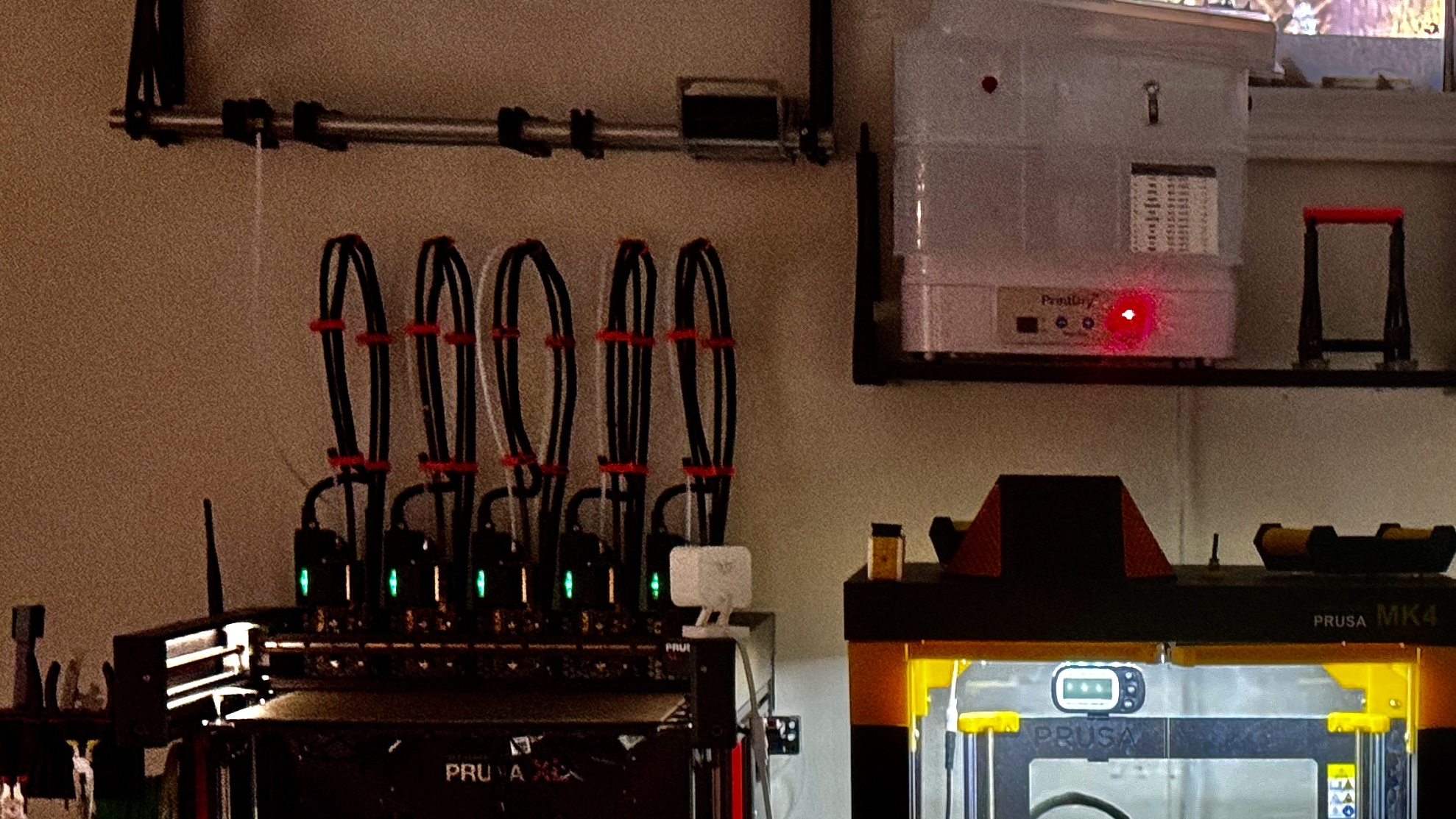

All mine are mounted above the machine on a backing board.
In the picture three are on Prusa's own spool holders, they mount easily with a #8 pan head screw; the loose filament at lower left is on a modified holder with skateboard bearings, it tended to overrun and tangle so that has been replaced with another Prusa mount.  The two centre mounts are for feeding flexibles direct to the nextruders bypassing the side sensors.  One of them will be replaced by a drybox 'real soon now'. (click picture to expand)
The side filament sensors have been rotated and moved to the horizontal rail above, the cables are *just* long enough:
"But", I hear you say, "The calibration pin drops out..."
Conveniently the right hand sensor has an unused tunnel *just* the right size, ready decorated with a 🙂
Interestingly, the Mk3 on the lower shelf requires the same width once all the cable are allowed for and it's only a little smaller in the Y direction so, although it's subjectively huge, the XL takes up very little more bench space when arranged like this.  Currently the Mk3 is fed from one of the spool holders above the XL, the long run isn't convenient so head scratching continues.
