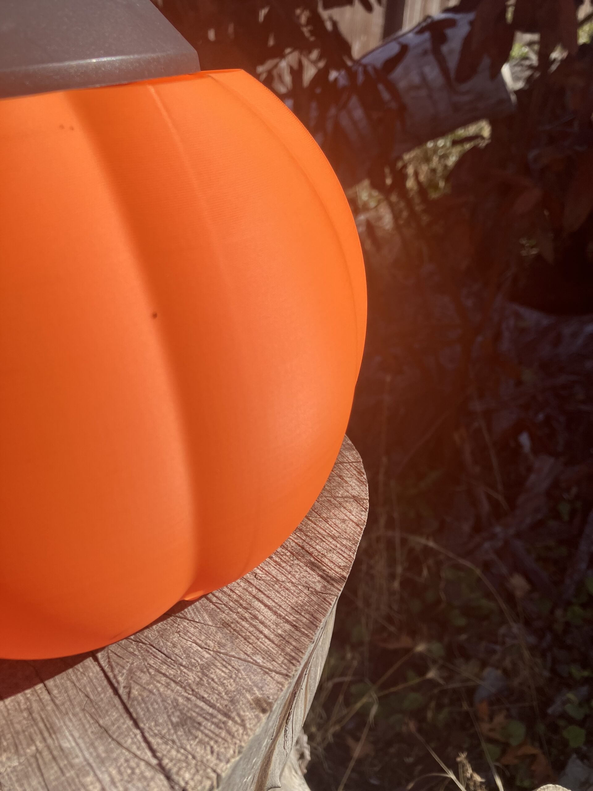

Hello, i found a problem in vase mode with the input shaper. It is not seamless as it should be.
There is nothing to be seen in the slicer, but in printing he makes a small movement with the print head. Always at the point where the seam is in the slicer.
If I use the normal profile of the MK4 it looks no different in the slicer but the print is normal.
Can someone please check on his MK4 whether he behaves exactly like this or whether it is only with me.
Otherwise I make an error message in the Prusa Slicer Github. Thanks very much.
The same place. The only difference with IS and normal profile.

Confirmed. I have the same issue with my MK4 Input Shaping firmware.
Tested with both perimeter generation mode (Classic or Arachne), i get the same results as on the top picture.

I found when I commented out M74 W[extruded_weight_volume] in printer settings ->custom g-code in the before layer change section in prusa slicer the seam dissapeared.  Perhaps there is some bad/heavy maths happening with the weight calculation.

Good catch. That would explain why non-IS doesn't have the issue, since that's specifically fed into the IS algorithm. Would also explain why it's not that big of a deal for non-vase mode, as any delay going to the next layer would be hidden by the seam that's already necessary.

I wouldn’t say completely fixed. There still is a little seam even with removing the gcode for weight compensation.  It was much worse when i had it in, but gave away that print. Done with stock .4mm  nozzle and .8 wall thickness at .2mm layer height.
