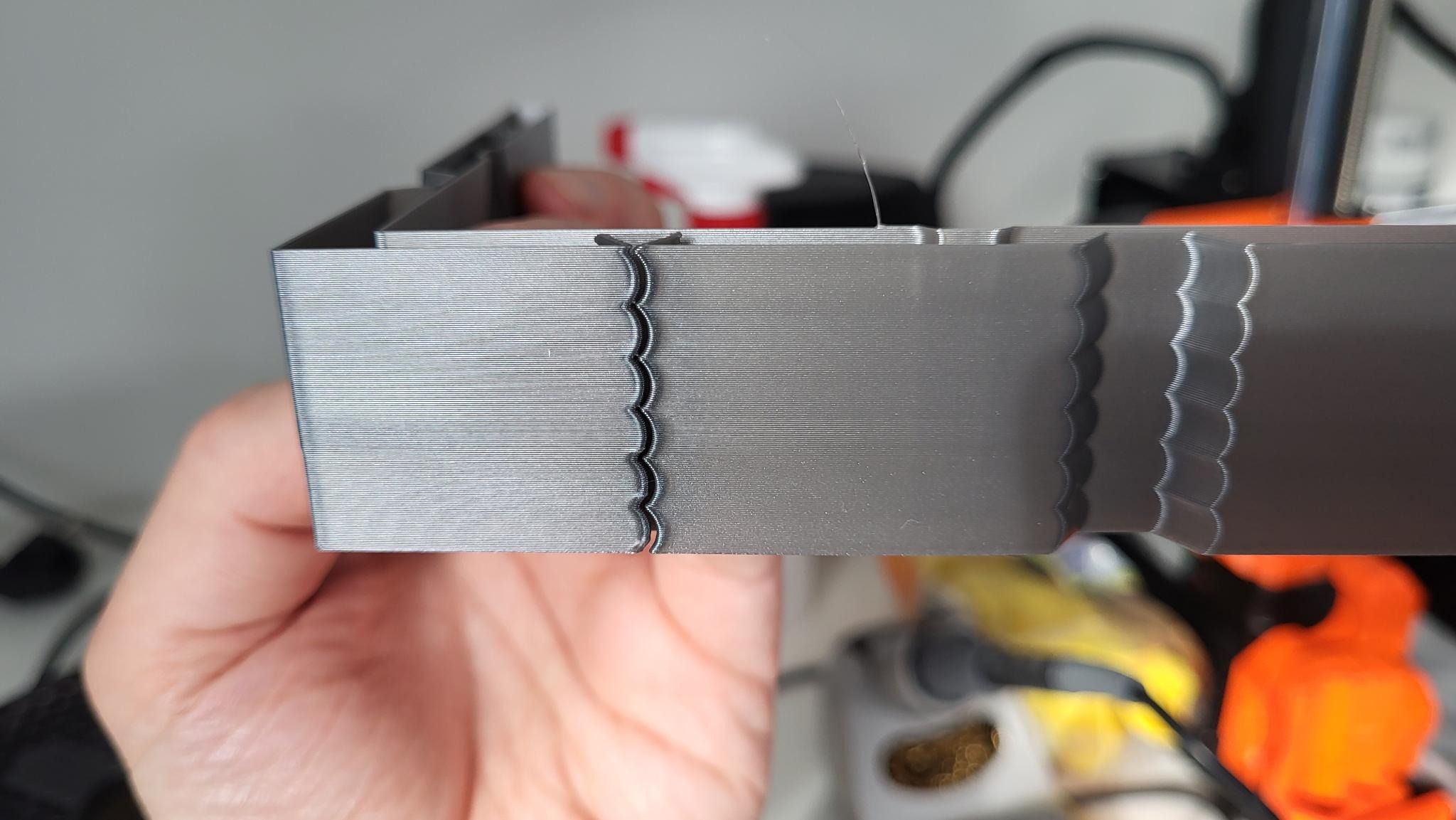

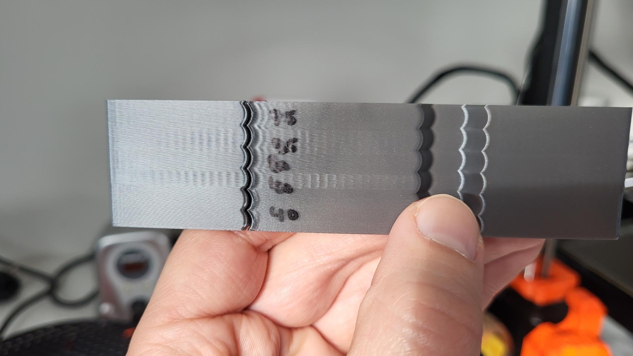

Thanks to @rainer-2 for showing this, I knew it from my Klipper printer, but didn't realize this could be done on the Prusa. 🙂 Now I did test it, it worked and I have very different resonances from stock (X: 52.4 Y: 62), may have to do with the table it's sitting on or something.
Anyway, I printed the same file again in vase mode, but this time with all other settings set back to what a normal print should have. On the Y axis, things seem to look good (slight differences at different speeds, but I think that can be expected), on the X axis however something is up. There is another resonance underneath and no matter how well I go over the printer, making sure things are tight etc. it stays exactly the same. Did anyone have something like this as well?
Y-Axis:
X-axis (I tried different speeds during the print)
Only at 40 mm/s it doesn't show. The slicer does advice 40 btw when sliced this way, so would that resonance then not be there if the slicer determines a higher speed for another model?
This post was modified 2 years ago 2 times by Punished Brains
Posted : 23/10/2023 12:07 pm
