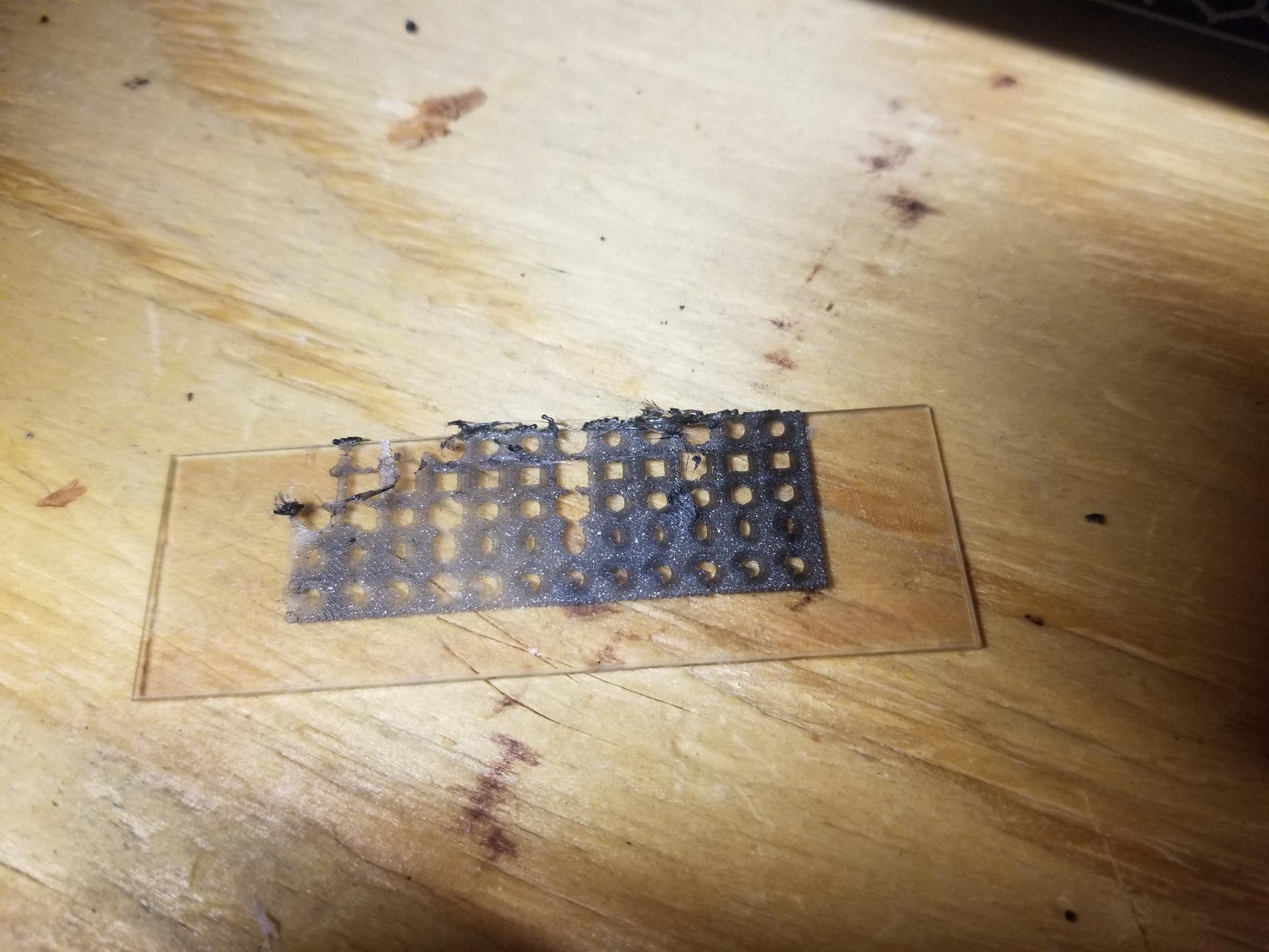

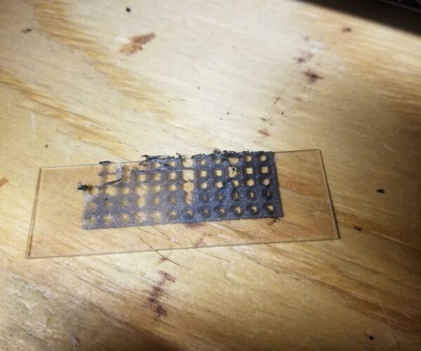

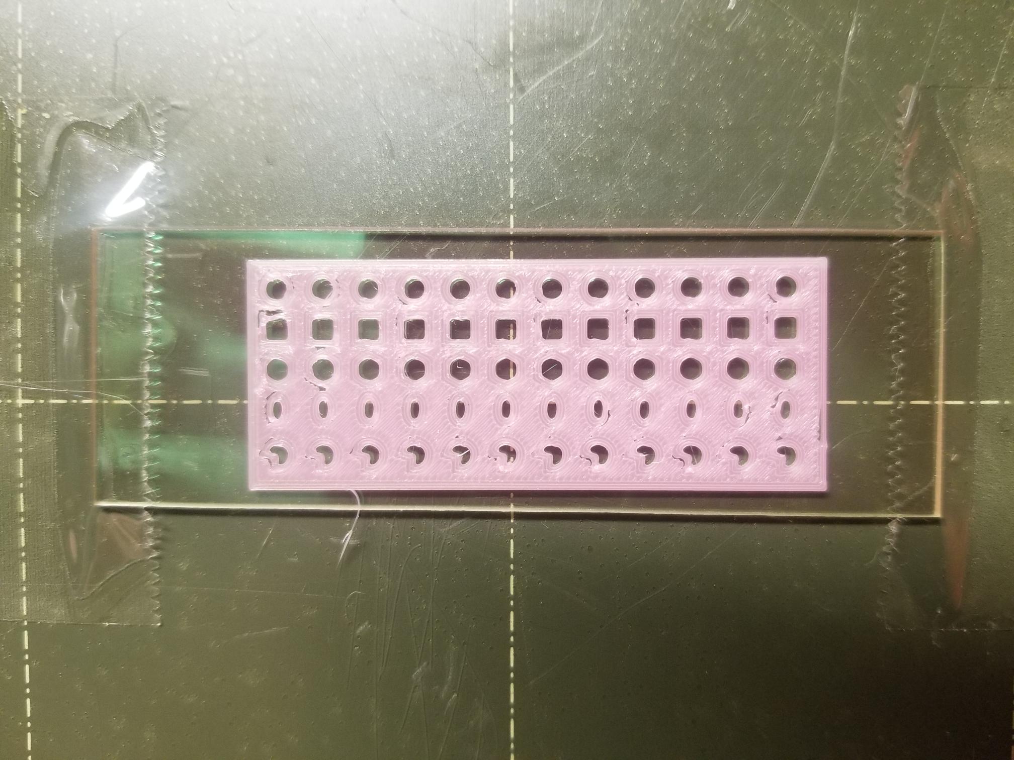

Thank you for your contribution to this thread - I've heard of some people using glass beds though I don't know any tricks associated with it. For my slide, I used a glue stick to adhere the backside of the slide to the bed. Sometimes it slips, so I might try taping the edges next time (or use double sided tape). I also raised the temperature of the bed to compensate for the slide height offset (70 instead of 60 for PLA), and they worked well. The attached image is by third attempt. The PLA sticks well to a clean slide (I cleaned the glass with Acetone), but getting it started is the hardest part. Aligning the slide to the correct position is also an issue (the alignment marks in Prusa Slicer at not exactly where the bed marks are). Also, I'm trying to deposit a thin layer (0.1 mm thickness) with a small nozzle (0.1 mm step height setting, 0.25 mm nozzle). My goal is to create custom hydrophobic reservoirs to contain droplets. If I pull on a corner, the whole thing will peel off but there is some good adhesive force of PLA to the glass.

I think if the goal is to print directly onto a slide and have it stay there you might want to consider something other than PLA as that is always going to come loose when it cools, that's why glass print beds are so popular, if you printed with PETG or ASA it would stick very well indeed. As regards to the initial layer, microscope slides are most likely not as level as you would assume ands since there is no way to get the standard bed levelling to take into account a 1mm thick slide on the plate you are probably stuck with trial & error.

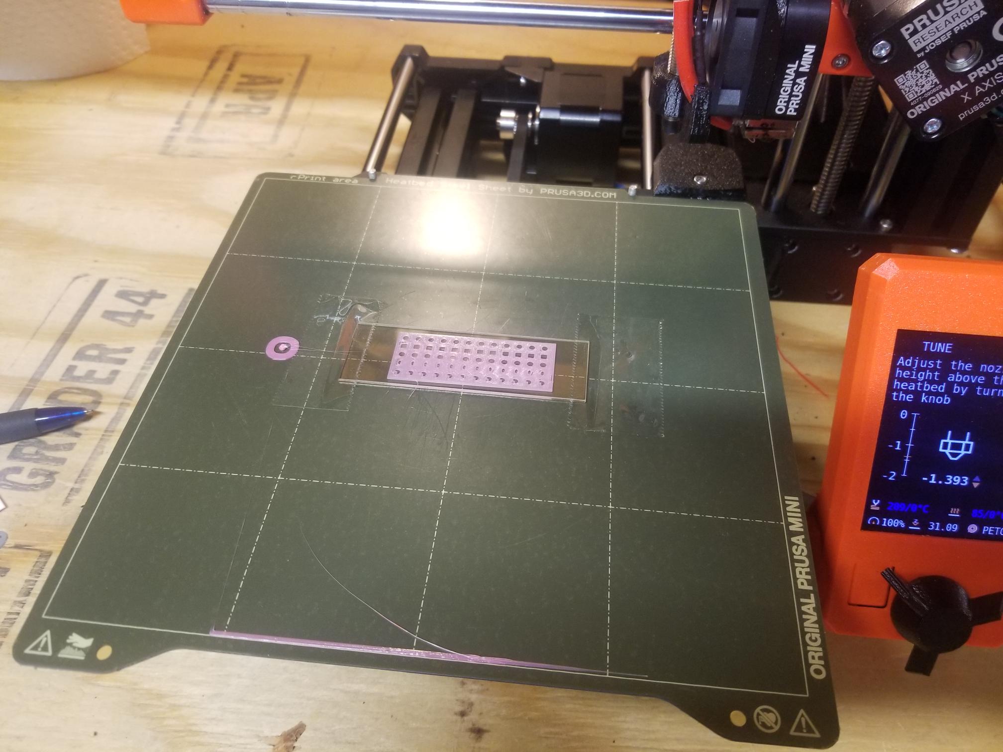

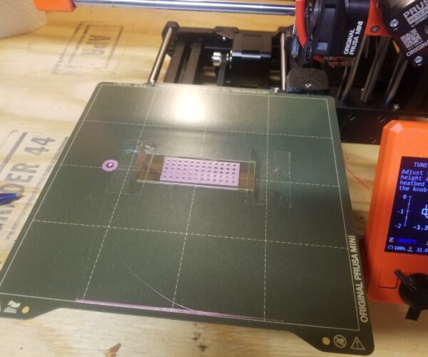

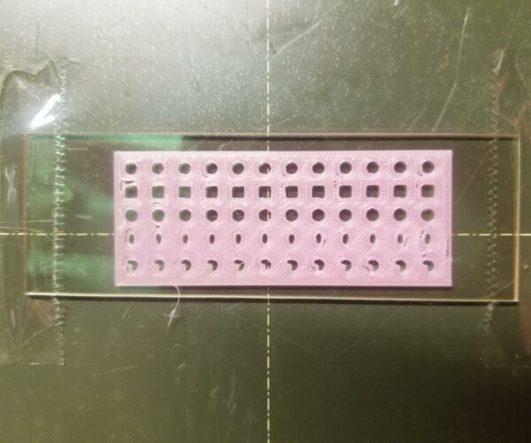

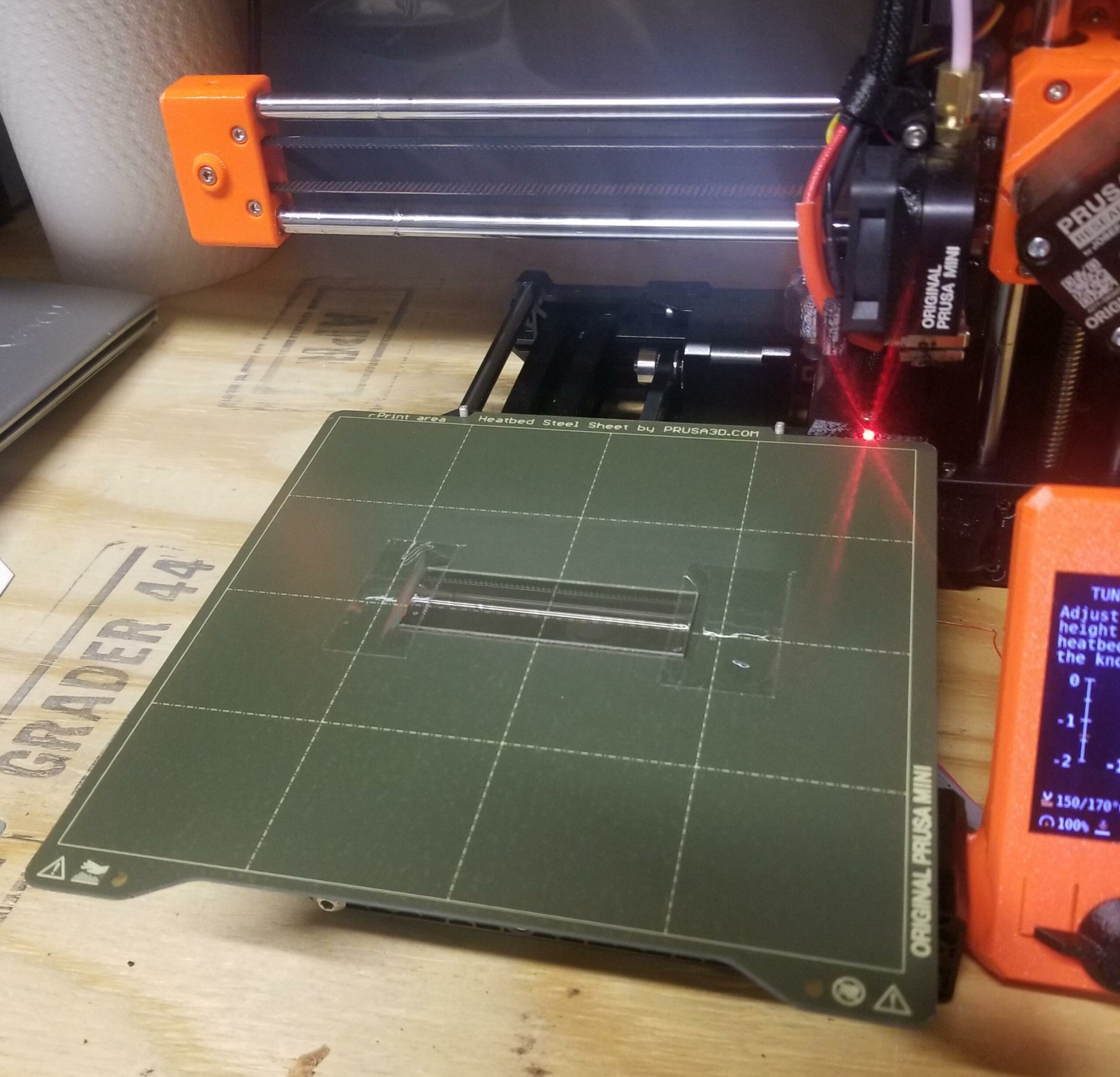

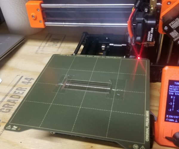

Thank you all again! With your feedback I was able to do it. See pictures below. Here's what I did:
  1. I measured the thickness of the glass slide. It was 1.1 mm. Based on HermannSW's comment, I created a 1.2 mm cube in addition to my slide pattern. In the PrusaSlicer program I would stack the slide pattern model on top of the 1.2 mm cube. The cube was placed far away from the slide.
  2. I taped the slide on the print bed. This provided more consistent height compared to a glue stick.
  3. I used a 0.2 mm nozzel with PETG using the default settings.
  4. During the print, once the nozzle moved to the glass slide, I would adjust the nozzle height until I was satisfied with the result.
  5. You won't get it on your first try. Use the first trial run to figure out your nozzle height to adhere to the slide. The advantage of having it taped is that you can likely peel away the failed print while keeping everything else in place. You may also need to reposition the x-y position of your slide.
Thanks again!
