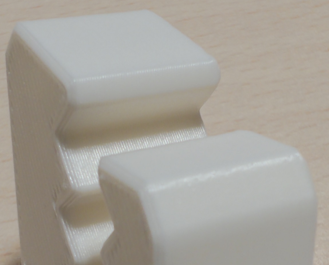

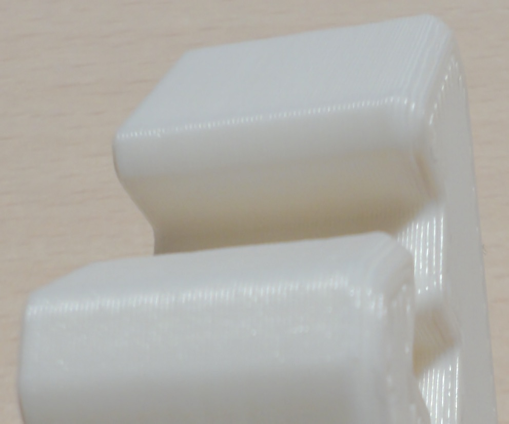

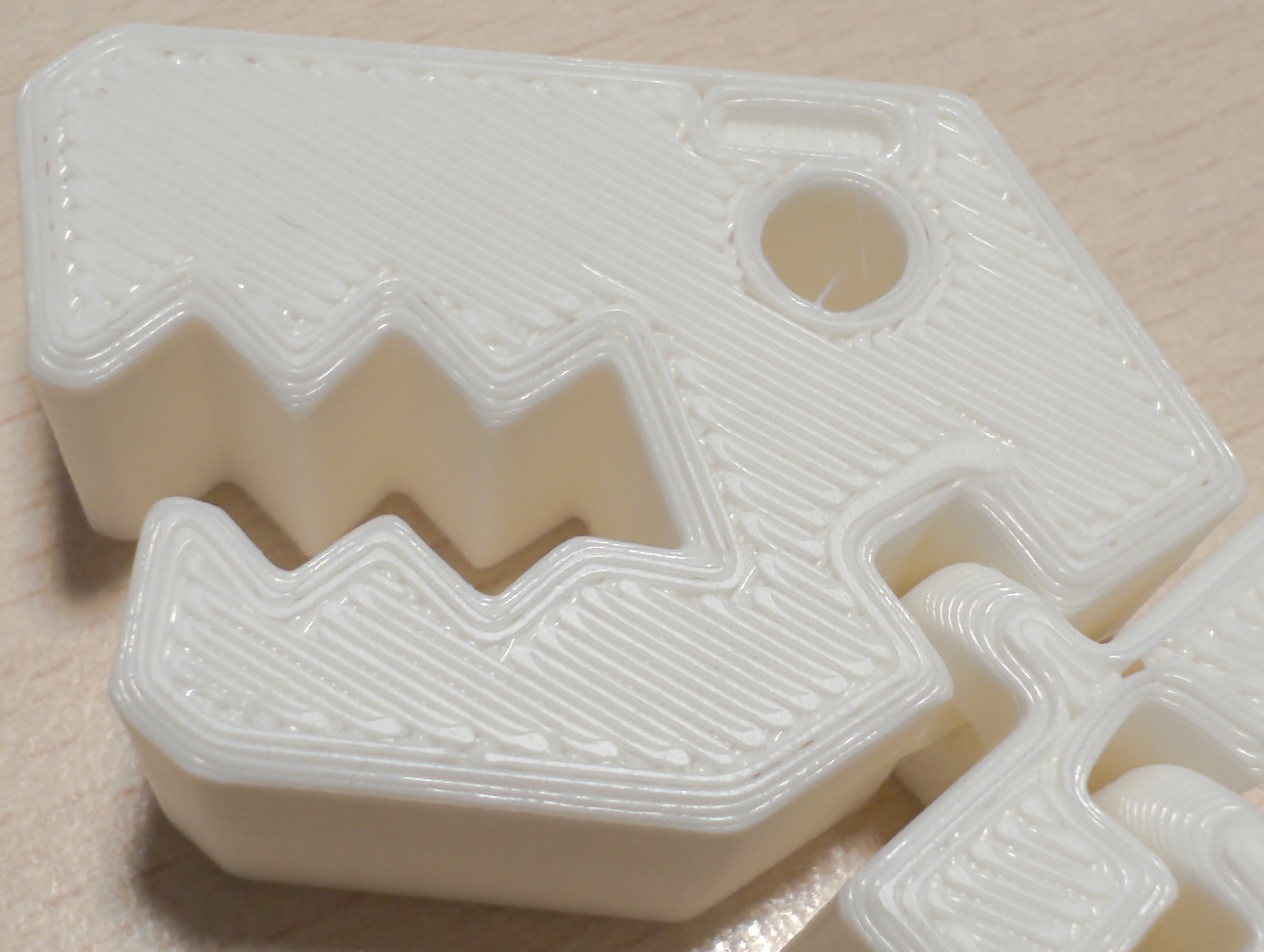

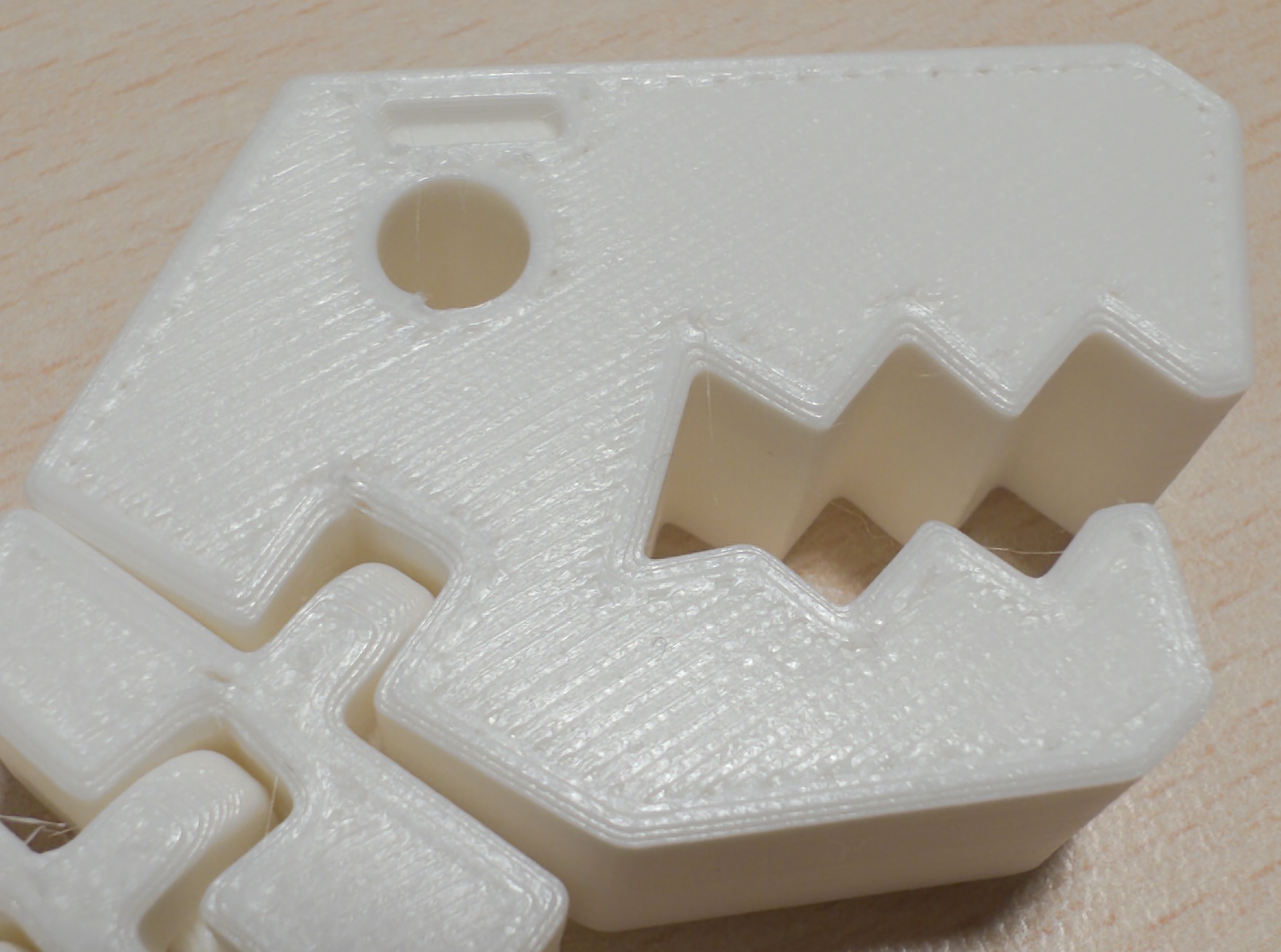

Hi, got the first prints with my new MINI+ today and in general I'm deeply impressed by the first results without any optimization. Now the questions come up ;-). On the images below you see the difference between last and first layer as well as the chamfer of the object which is not the same on both sides (but should be). I have searched for that in the forum and could at least find a hint regarding the Live Z calibration. Could this be the issue here? I'm pretty sure that the reason is a wrong parameter but I don't know which one and if it is only one. I would understand the issue with a wrong Live Z (set too high) what should be put down to get a better first layer. However, what is confusing is the difference of the chamfer which seems to be 4 or 5 layers in height instead of 3 on the top. So is it only the Z position, is it related to the by default different infill pattern, anything else...?
So thanks a lot for hints how to optimize that.
Images: last layer, first layer, chamfer at last layer, chamfer at first layer

Bottom and top layers will always look different as the bottom layer gets squished more. From the photo your nozzle might be a bit high. I would use a calibration tool such as this https://www.prusaprinters.org/prints/105404 to optimize the Live Z value. The chamfer, I can't tell from the photos.

Hi, just a feedback about the last result: The Flexi-Rex should have a width of 13 mm but it had a bit more than 13.1 mm, rather 13.15 mm. I have reduced Live Z using your pattern in steps of 0.020 mm first and the second print in steps of 0.010 mm. It changed from -1.150 to -1.300 and now it looks way better. I guess this was the main part of the issue. So for the moment it looks fine. More prints are following... 😉
