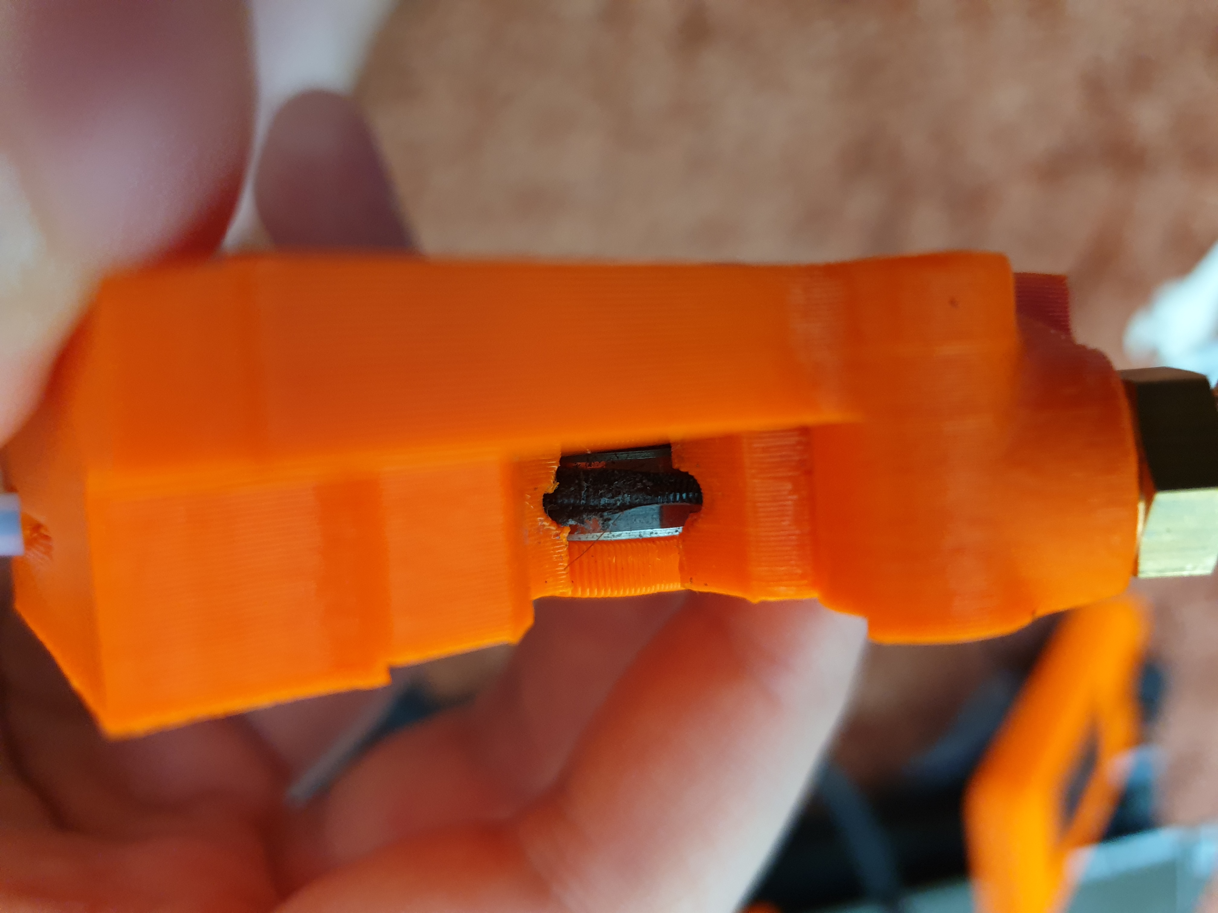

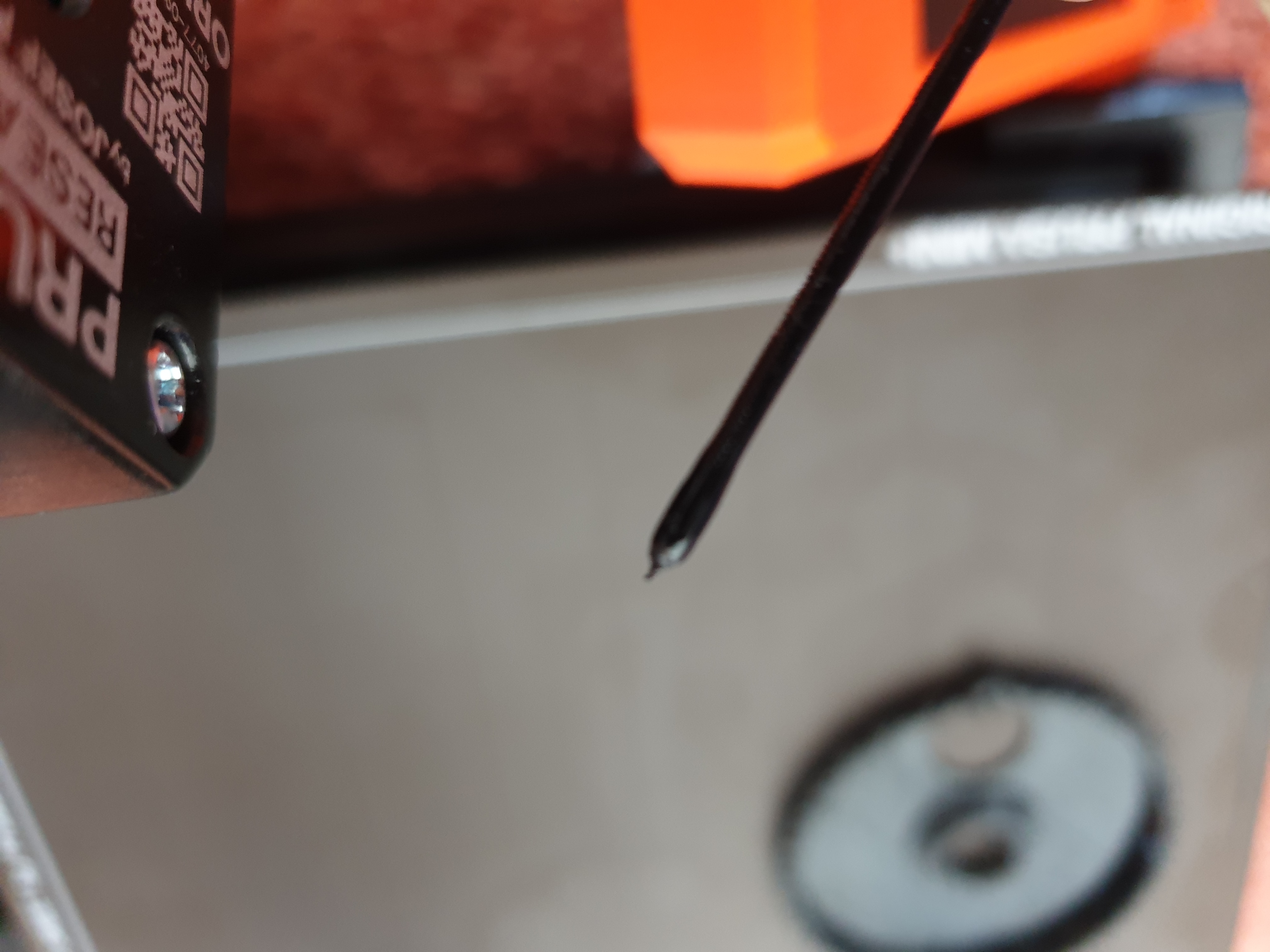

I've had my Mini+ (plus a spool of PETG) for several weeks now. Unfortunately I've had to take apart the extruder to get mangled filament out about 8 times now. The first time was about a day into owning the printer (I don't remember what was printed) and the other times during printing a specific part, every time.
I'm not sure what the initial cause is, but here's the post mortem:
The end of the filament pulled from the hotend. After clearing the mangled filament from the printer, I can push this end manually into the hotend (with a heated nozzle) and the material goes through no problem. After reinstalling new filament the printer also works fine, so it doesn't seem like the nozzle itself is jammed.

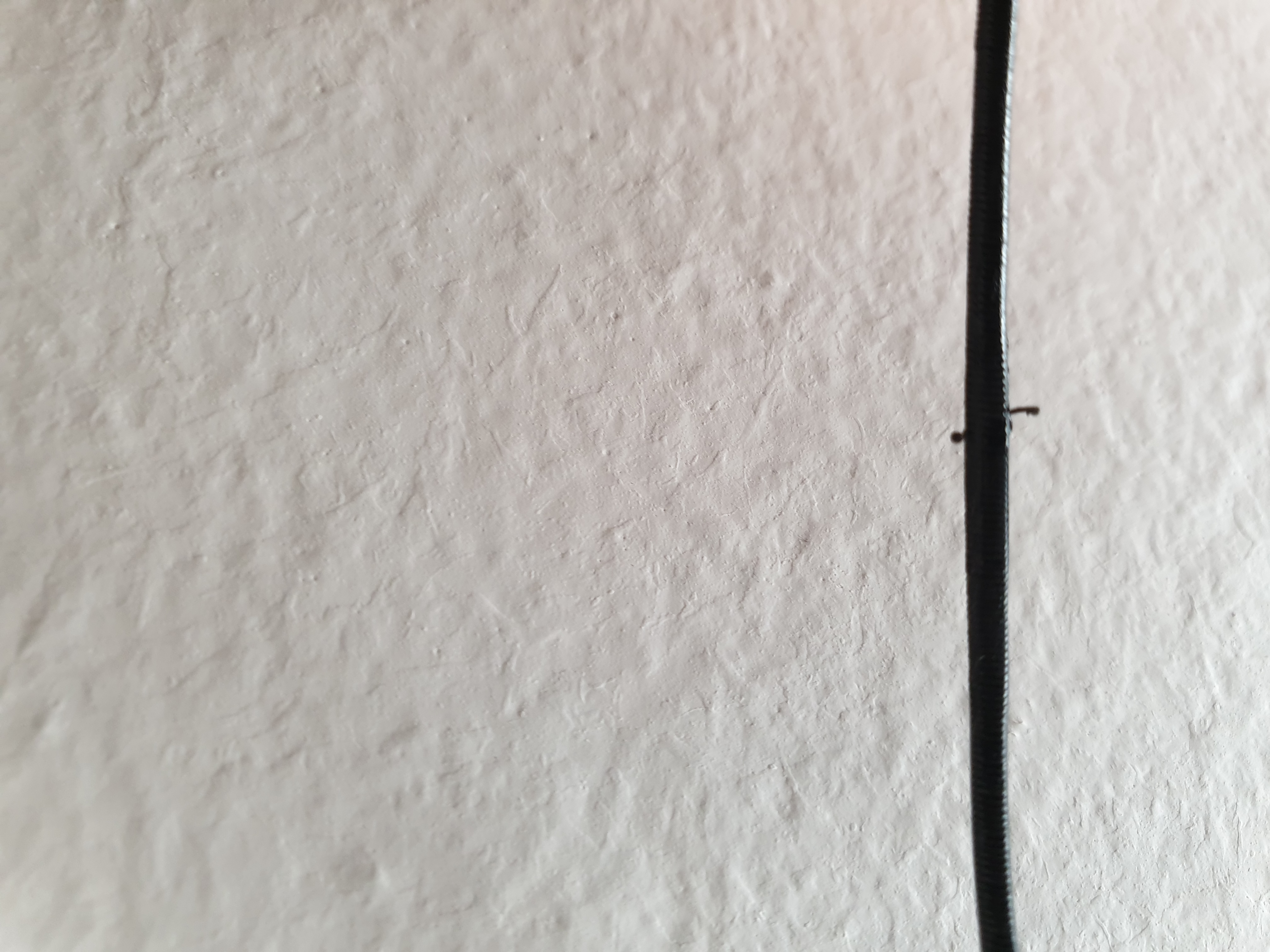

The filament inside the tube between the extruder and the hotend has several spots where it's flattened by the extruder. Since getting the filament out of the tube requires serious force, I believe this is where the filament gets stuck before it starts being chewed up inside the extruder.
The mangled filament inside the extruder (requires disassembling the extruder every time).

The big part of the problem seems to be the flattened filament.
Thanks for any advice, I'm slowly starting to lose my mind here.

The filament taken from the print nozzle looks good.
I suggest checking the filament path for obstacles:
- if the spool is spinning freely, no tangles
- if it is easy to push the filament without noticeable force from the spool through the filament sensor (this sometimes gets tight), to the extruder - fix any kinks in the tubes.
- check the spring tension in the extruder - maybe it needs to be increased so that extruder grabs filament better? Check if the filament has small but noticeable cuts from the extruder - if not then it starts to slip and with any filament movement obstacle it will start to grind into the filament.
- check for the obstacles between the exturder and hotend - the Bowden tubes, the small PTFE tube in the hotend if they are round, this can also cause blockage.
