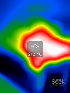

Chris Deppe
(@chris-deppe)
RE: Hotend temperature Issues (clogging, temperature seems to be lower than read). Assembly instructions for hotend?
Dear Mini-friends,
the same thermal aberrations are visible at my hotend as well...
Those problems seem to be one part of the annoying underextrusion-phenomenom that seems to be wide-spread within our community.
Hopefully the devs will get rid of this whole complex soon!
Take care
Chris
