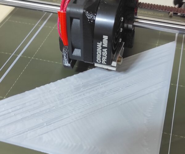

I am REALLY needing some advice and help from people far more experienced than I am. My Prusa Mini Plus arrived this week, I purchased the ready built unit. All went together well with no issues. First print was perfect. (Benchy) HOWEVER.... In the last 4 days since the Benchy I have not been able to print anything whatsoever! It is driving me mad! I have had a Creality Ender 3 pro for 6 months or so and am now wishing I had saved my money and bought the new Ender when it is available here in the UK.
The second print on my Mini+ failed due to the filament totally blocking the extruder and wrapping itself around everything. I had to dismantle the entire extruder mechanism to remove the blocked filament. ( I purchased the sensor as well) but no matter what I try I cannot get the damn thing to print anything again. It will not do a good first layer no matter what I try to adjust, heat bed, hot end temp, speed, It is either far too thin or creates 'waves' as you can see in the pictures. The Ender (as you can see) prints a perfect first layer as you can see.
It doesn't matter if I use Cura or Prusaslicer to print it just will not do it. I have even unloaded the Prusa Slicer and reinstalled it but it still will not work properly.
I downloaded a small 50 x 50mm square to test first layer but even with this it is poor.
Not only that but if I do finally get it to print a first level anywhere near flat as you can see in the pictures which is the best I can get it to print.. as soon as I go to print a model it fails.
What makes it worse is that I am disabled (paraplegic - paralyzed from the waist down and as I live alone I have no help) and cannot physically keep mucking about lifting the thing on and off the table adjusting this, that and God knows what else! I just can't do it.
I have even tried to adjust the idler screw to see if it was not feeding filament properly but NOTHING I have tried has worked.
Can ANYONE offer any help on how to get it to print anywhere near a decent print. It's not consistent enough to try and print any long prints. I can print 2 day long prints on my Ender 3 with no worries.

Have you washed your print sheet with dishwashing detergent (Dawn/Fairy) and HOT water?
Please show us your first layer Z calibration print on the print sheet.
Almost all adhesion problems are due to bad first layer or a dirty bed.
RE: PLEASE HELP JUST WONT PRINT WELL!
Your live z is still way too high. You need to lower the nozzle more, ie make the live z value more negative.

Have you seen how to replace the PTFE on the Mini hot end? https://www.help.prusa3d.com/en/guide/how-to-replace-a-hotend-ptfe-tube-mini-mini_119449
It turned out my failure was to get the heat break clean as shown in step 7. It was hard for me to see with the heat break in the machine, but when I removed it it was clear as day I didn't get that part done well and that's why I was having trouble and why a new heat break fixed it.
As you can all see it prints a good first layer for around 15 lines. Then is just breaks up!! It does this NO MATTER WHAT Z HEIGHT we set it to. We have tried: various PLA filaments, a range of temperatures, it has had a new quality nozzle, extruder stripped and cleaned, hot end stripped and cleaned (no blockages found) sensor adjusted, fully re-calibrated (twice), bed tightness checked, bed cleaned.
No matter what we try it just will not print. I have had one print in 2 weeks of ownership!
As you can see from the photo it will simply not print a constant layer!
