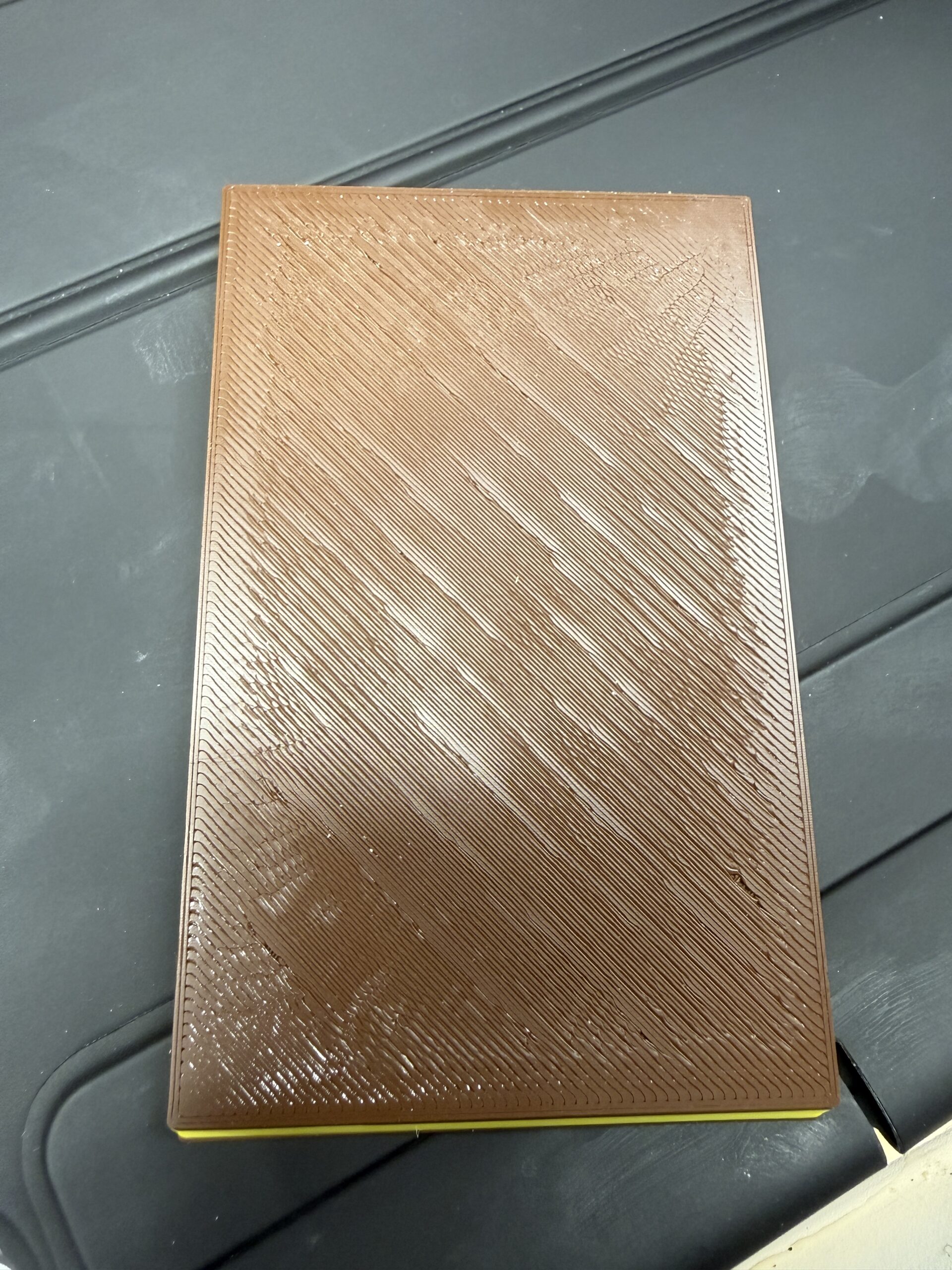

Top Layer
I would like a smoother top layer.
Is one of the preset Print settings better to use?
Posted : 20/01/2026 9:58 pm
The ironing function is intended to smooth top layers - but for your print I would just flip it over and print face down - then your choice of build plate dictates the surface finish.
Posted : 20/01/2026 11:17 pm

Im also not getting a great first layer.  This is Hatchbox, which I usually have good results with.
Posted : 20/01/2026 11:27 pm

That's slightly odd - try turning the build sheet over, does the same effect appear on both sides?
Posted : 21/01/2026 4:56 am
Grandpa Joe
(@grandpa-joe)
RE: Top Layer
no, the bottom is pretty smooth most of the time.   Sometimes both bottom and top are bad.  Just not consistent.

I have tried Hatchbox and i am still getting random streaks.

The side of the build plate used does not matter.
