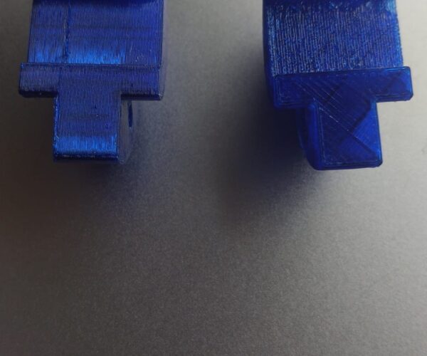

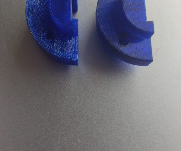

Hi all,
I'm having a problem where when I print the part shown, the quality of the 1st layer above the supports is a very poor quality. The print completes successfully and from top down it looks perfect, however when I remove the supports the finish is very poor when looking from bottom up. Does anyone have any ideas about how I could resolve this?
I have checked different printers (Mk4 & XL) and different filaments and always get the same results.
For info the filament I'm using is PLA and I'm printing using a 0.4mm Nozzle.
Thanks

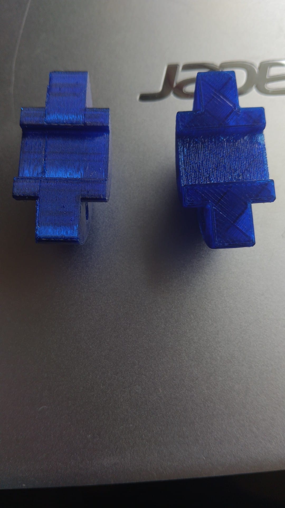

Hi, I had a play with the STL
Should have looked at the Gcode. and seen that you printed PLA
anyway

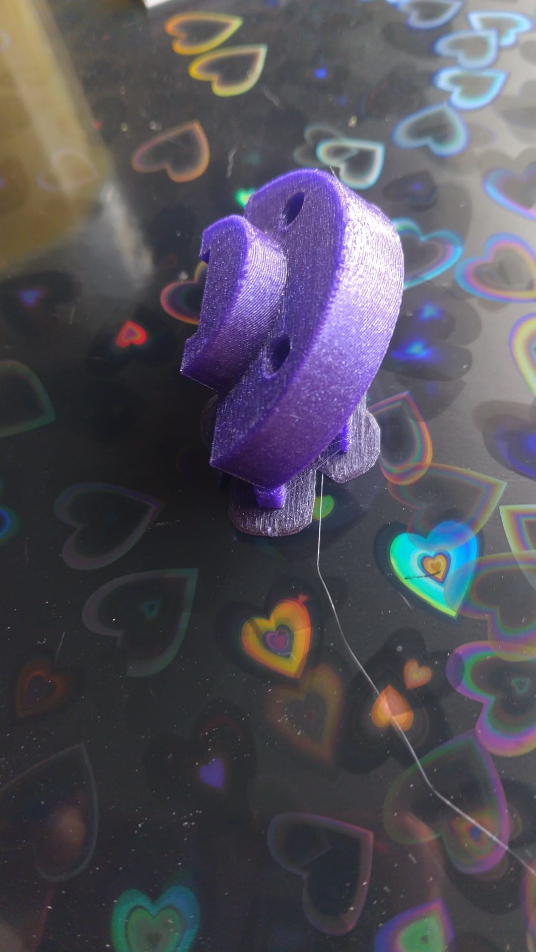

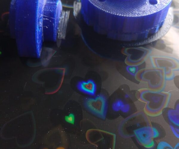

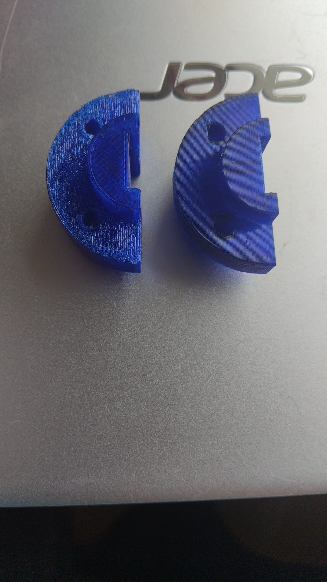

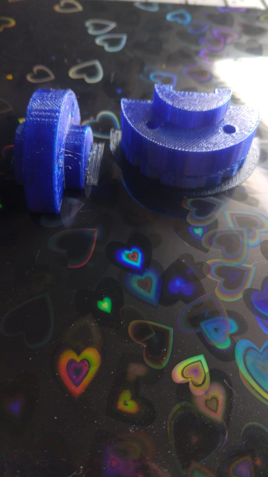

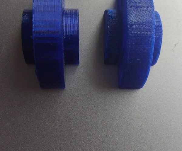

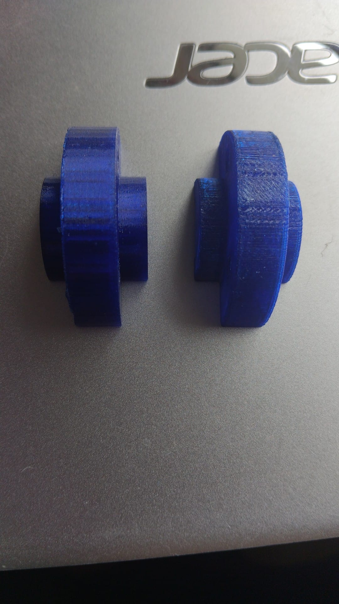

first try, printed in PETG, one normal orientation, one at 90 degrees, using SNUG Supports
outsides different textures because of print orientation
Inside of right piece shows support damage
Bottom of left piece shows support damage

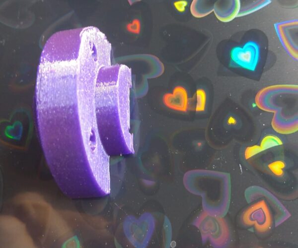

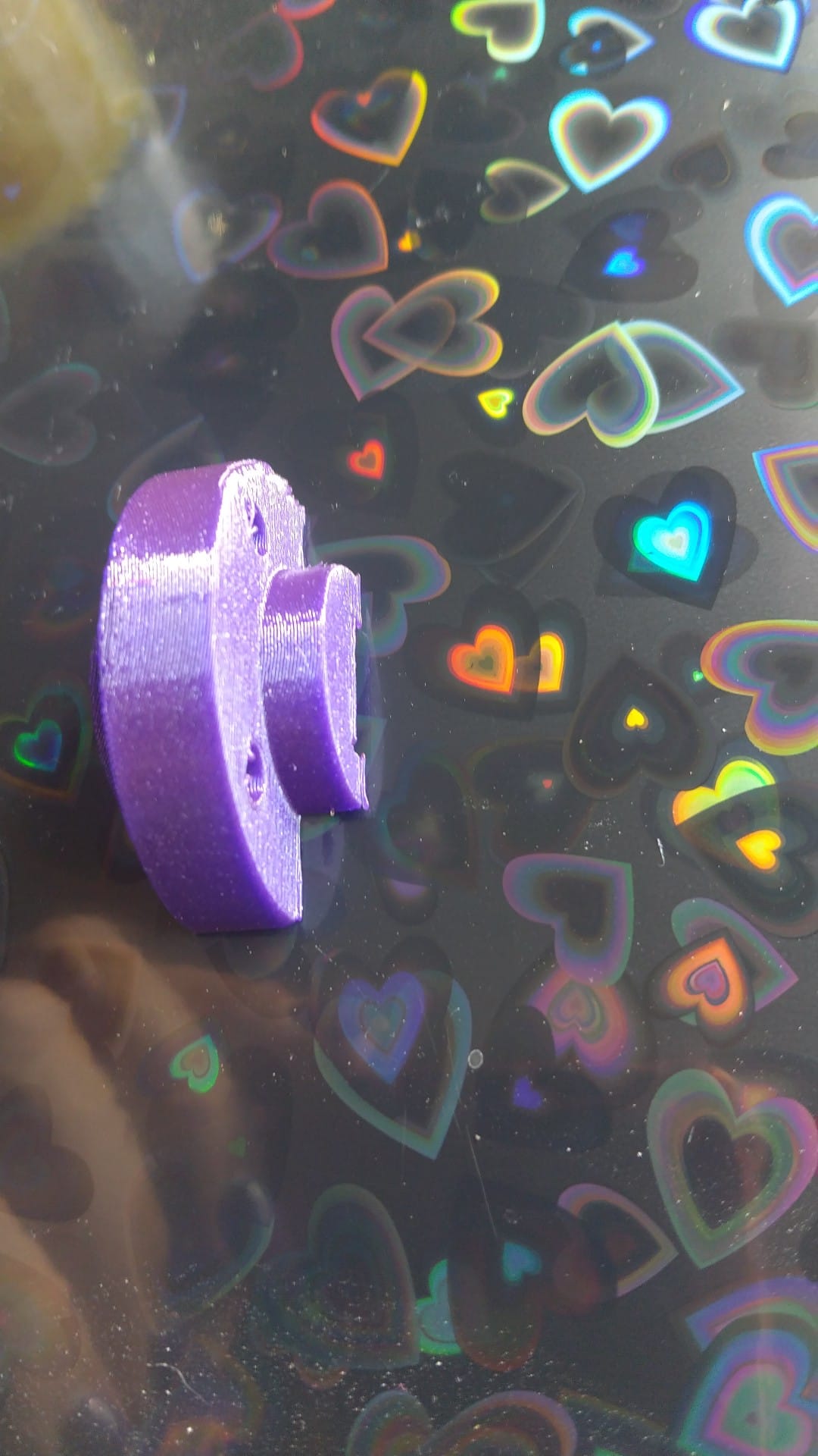

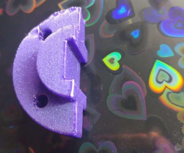

Second try using PLA (Galaxy Purple, hence the sparkles)

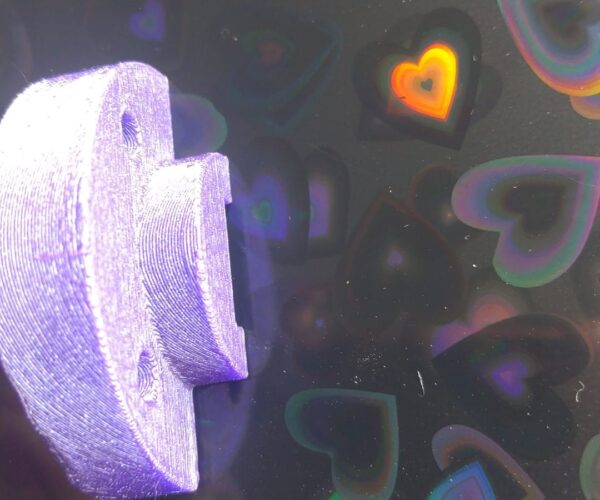

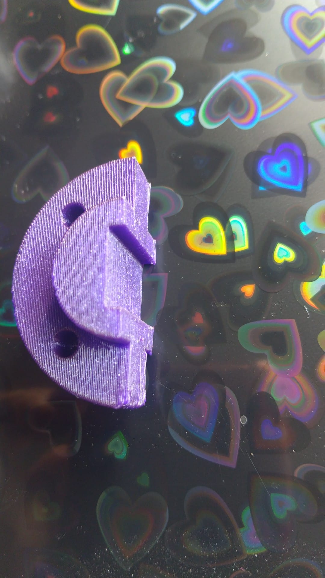

Model tilted at 45 degrees, minimal support (I actually painted on some extra support across the lower edges)
Slight deformation on curve  in above image, but no support damage

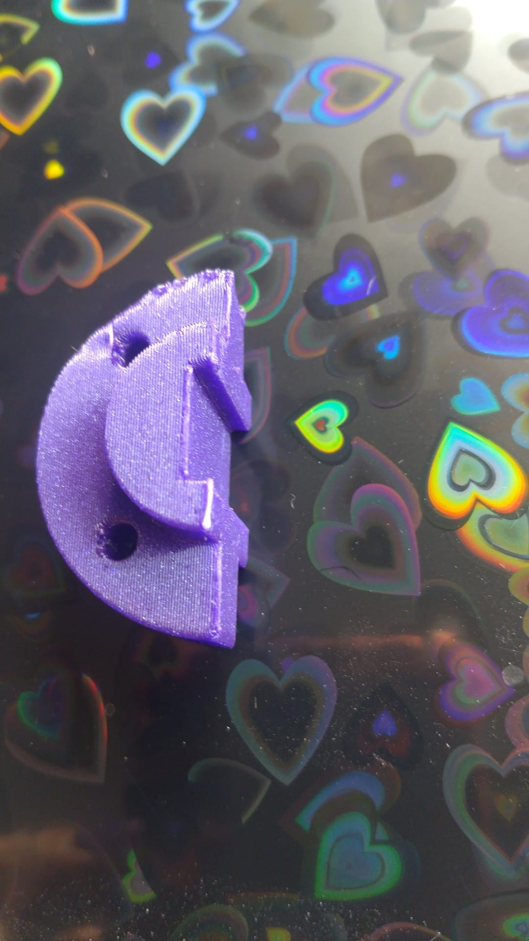

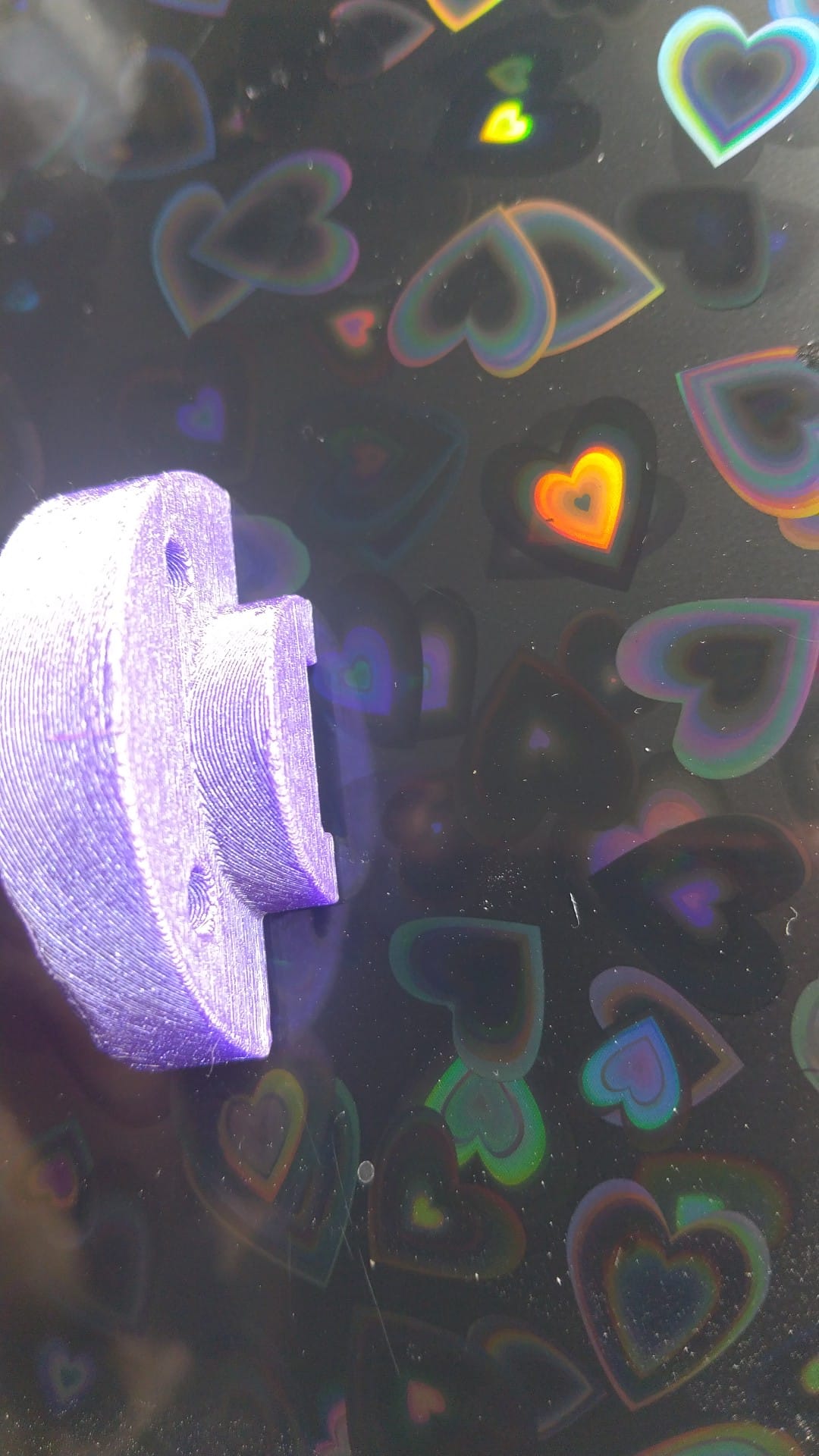

Slight deformation on curve from a different angle below

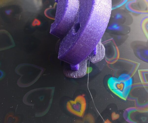

Painted on supports shown below
The build plate is a holographic smooth build plat from Aliexpress
I Hope this helps.

Frankly, the OP's original photo looks pretty good, in line with what I would expect printing PLA on PLA supports. There's a necessary gap between the top layer of the supports and the first layer of the overhang surface. It there wasn't the model would fuse to the supports. So when the printer lays down that first layer, it will droop a bit, which creates the uneven surface.
You may get better results if if you have an MMU or XL and can print PLA on PETG supports with zero gap.

As Fox says above, I was wondering if this was just the limit of the printer / model combo.
But I didn't consider the option of printing at a 45degree angle (and I didn't know about the paint-on support function). I have re-printed at 45 degrees and I got results similar to you, which are much improved.
Posted : 12/08/2025 7:18 am
