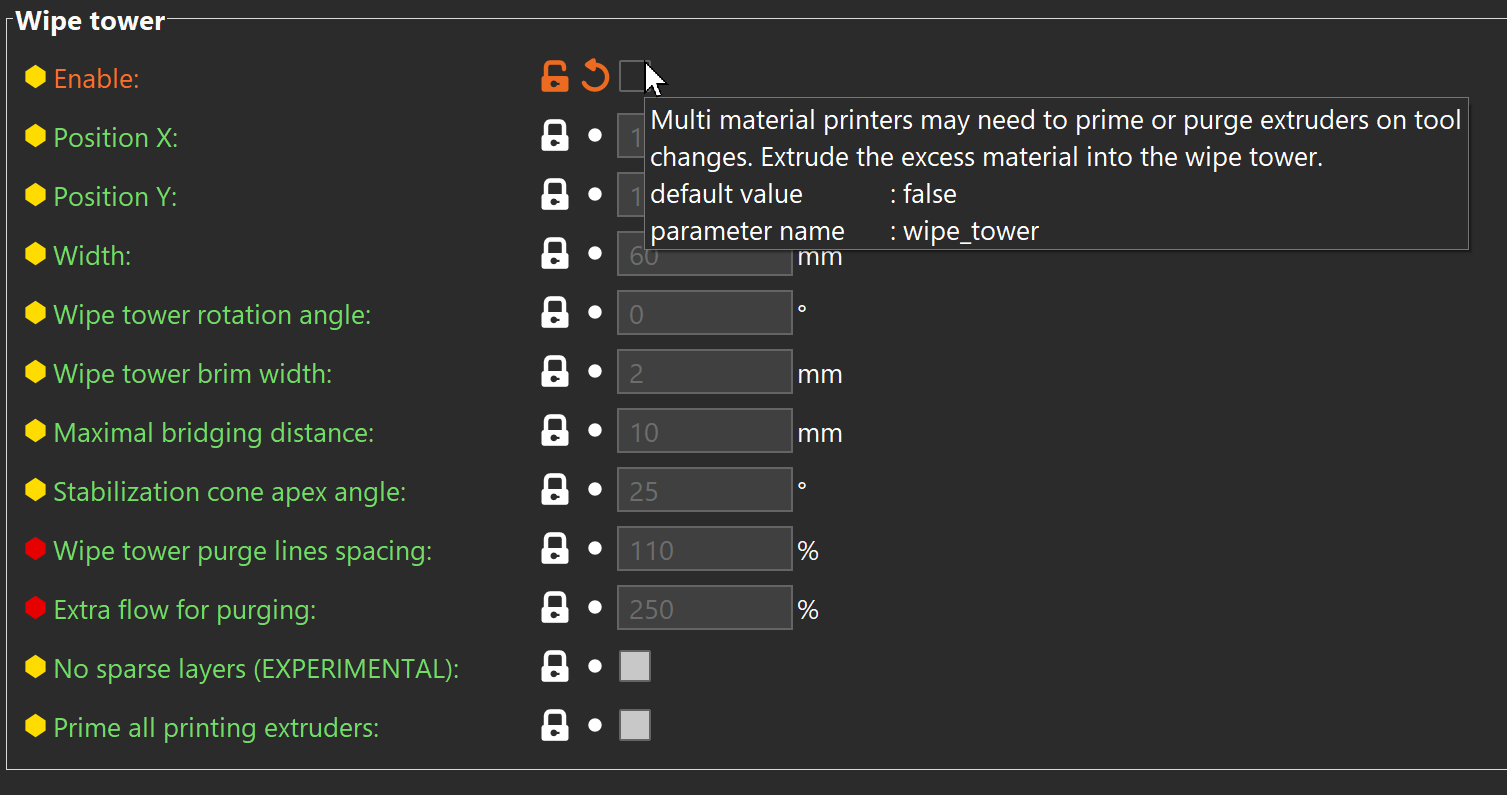

Hi, I've printed 2 color with single extruder before upgrading to the Mk4 (previously was a MK3S) without any issues.  Maybe I'm not understanding the wipe tower and haven't found anyway to disable it (although search docs say I should right click on model and then click the disable tower, but that option isn't present in my PrusaSlicer 2.8.1)
So, what I'm not understanding with it as it is, I've got my M600 command to change filaments on Tool change, and after I change the filament color. it goes to the wipe tower and initiates a large glob on the first couple passes in the tower area.  I mean it pushes the nozzle down and filament is oozing out around the nozzle and then tracking through this a couple times within the tower area.  At times I can here the extruder motor gears clicking like I think because the nozzle is so close to the print bed, no filament can come out.
My questions are:
    1.  Is there a way I should be able to disable the wipe tower since I'm manually changing the filament and clearing any residue.
    2.  If not, Do I have some settings incorrect for doing a proper wipe tower?

Best Answer by Sembazuru:
For disabling the wipe tower, it is in Print Settings/Multiple Extruders/Wipe Tower/Enable. It has a yellow dot next to it so make sure you are in normal or expert settings mode (it'll be hidden in beginner settings mode). See this screenshot showing all the wipe tower settings:

Dang it, I had been looking all over but missed it on that tab.  Thank you very much!!!!

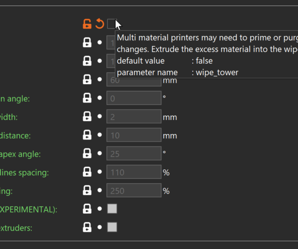

If there are ever properties you cannot find use the search box on the properties tab (need to click on screen shot to see properly) ...

Thanks, I never noticed that and didn't think of it.  I'll try to remember that next time.
