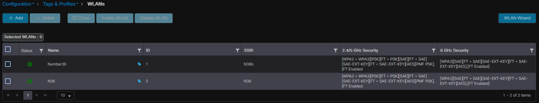

Not sure if this will help most but it shows the security on each band, I don't think the mk4 has any 6GHz capability (most stuff in the house doesn't) so there is no WPA2 on that.

Couldn't edit the post - what is this time constraint  ...
I will add a WPA2 only profile just to prove the point re wPA2 / WPA3 negotiation.
My ultimate goal is to move away from password / private shared key access for anything other than a guest network but that will be segregated from any internal access and will provide internet access for guests only. Even Apple devices struggle with fast transform ...
I do realise this goes way beyond a typical domestic install - the printer may need to live on a less secure profile but I'd rather that even guests can't find it - but I'd like to limit the number of profiles I need to manage also
