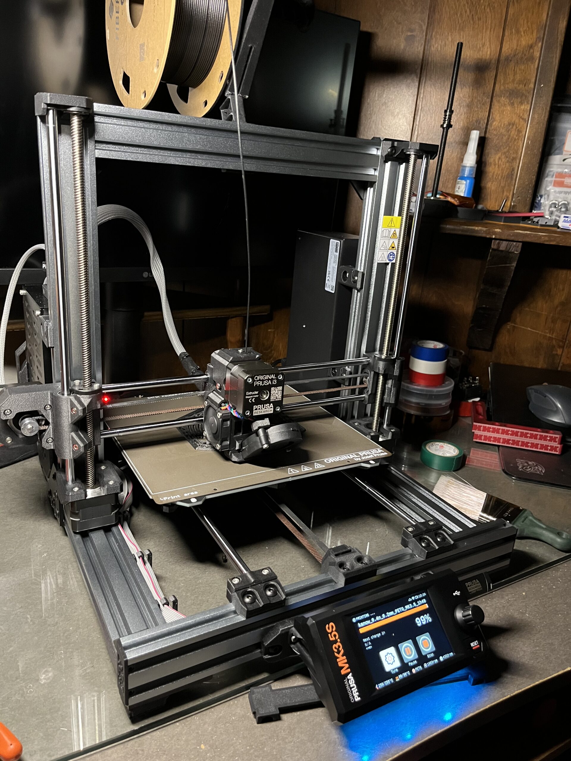

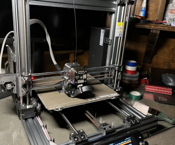

I built a mk3.5s bear and managed to get it down to x36 y38
