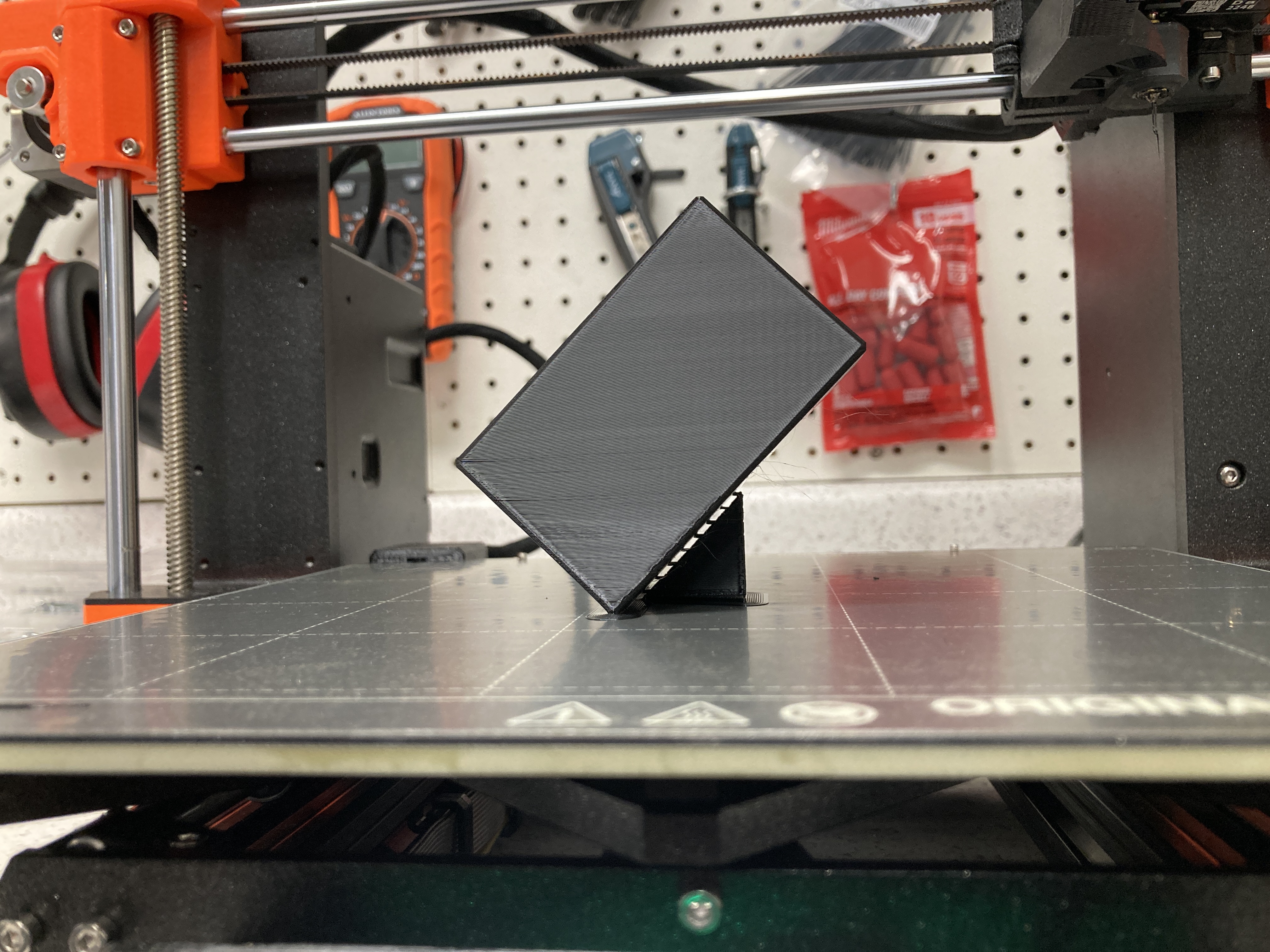

If hairspray (aquanet is a popular one for this) doesn't work, the 45 degree printing orientation in the video above is best done with a designed support 'wing' rather than supports in the slicer.  Slicer supports will have clearance, and you will get wobble.  I've successfully used the designed support idea with the recommended small connecting tabs.  You'll need to know how to do this in the model.
I've attached a pic of a part I designed for work and printed this way.
