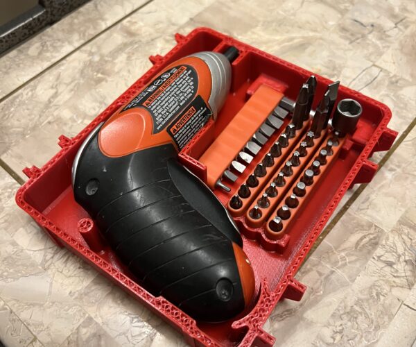

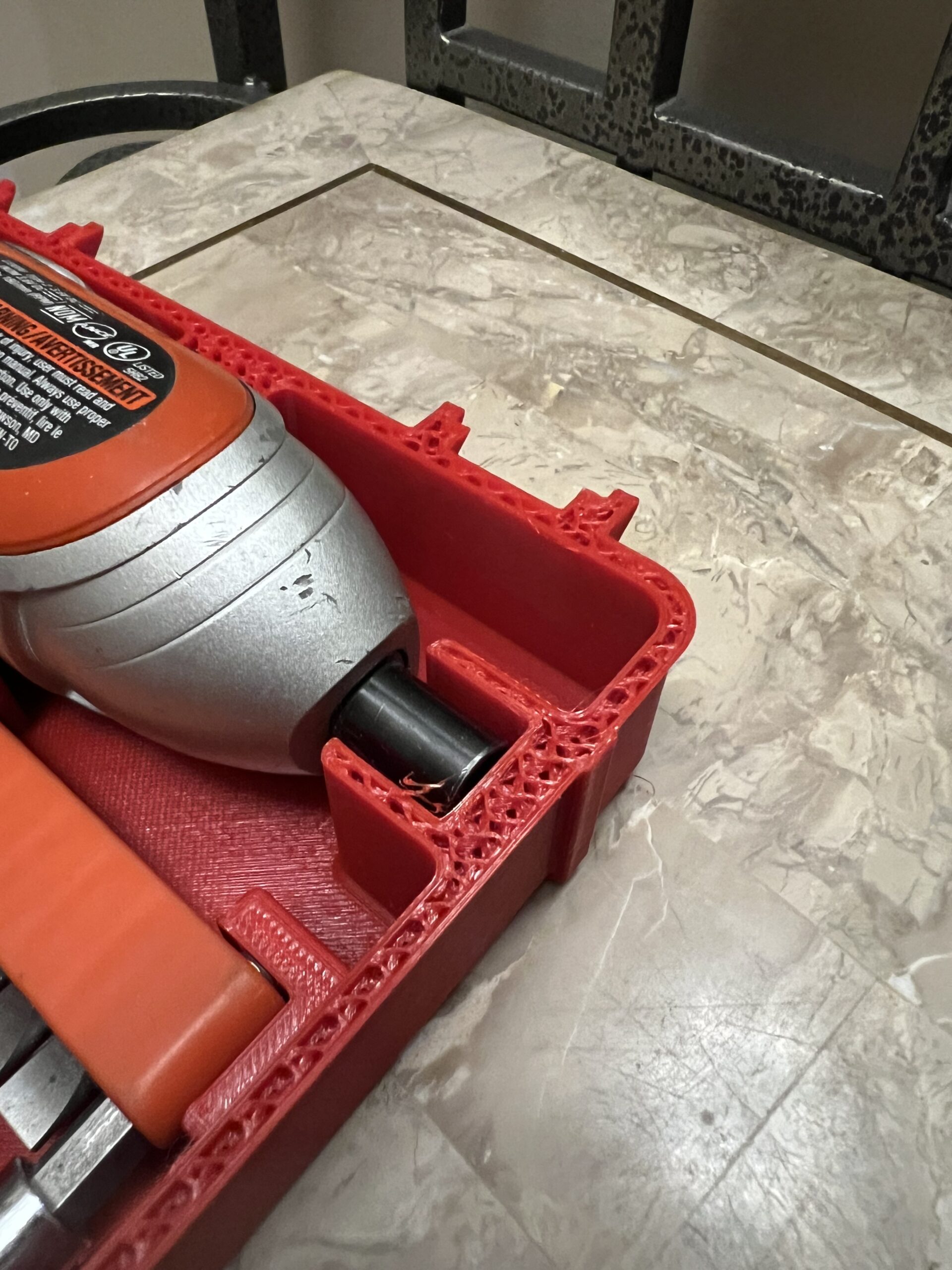

Today I came home and found this rugged box only partially complete, but the MK4 thought it had finished in the expected time.
I’m thinking that the only explanation is that the filament stopped extruding.  I cannot unload the filament - it’s stuck in the print head and the extruder doesn’t seem to move it at all.
I saw a recommendation to heat the head to 280 and clean it with the cleaning tool that came with the printer.
What could cause this?  I can only guess that the filament broke inside the head and jammed, and the extruder gear wore it down so it can’t grab it anymore.  Any other suggestions?
This is my first real failure after 38 prints so I’m inclined to think the printer is set up reasonably well.
