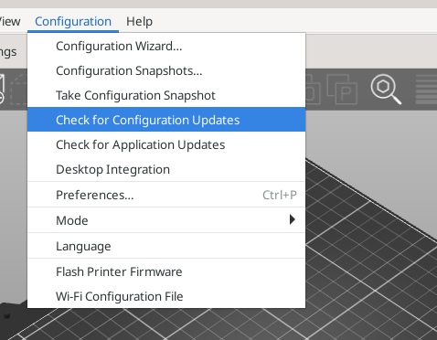

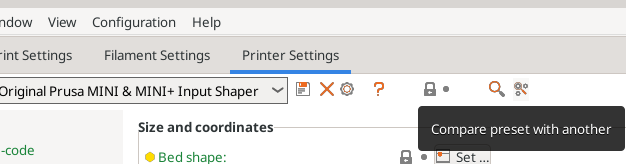

mixer3d
(@mixer3d)
Hello, if you slicer do not prompt by itself about the change you can find it here:
For example last change slowed down the infill from 130 > 115, and some accelerations.
If you have some saved custom profiles you can compare them later here:
and the change log:
https://files.prusa3d.com/?latest=slicer-profiles&lng=en_US
