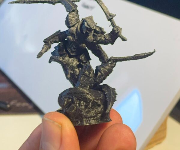

Paul Harbin
(@paul-harbin)
So, for input shaping I have been using Geeetech Highspeed PLA. No issues, other than it being a bit wispy but complete acceptable. It brushes off easily.
I have started running some .25 Nozzle X minis that have come out stunning with Poly Terra Charcoal Black. I have decided to use my Prusament PLA Galaxy Black and this will make my 3rd evening trouble shooting it after finally getting it to hold without glue by heating the bed to 72 on first layer and 70 after.
The odd thing being I had a few successful single mini prints but when I tried more .... problems.  It has been a mix of extrusion multiplier, going pretty hot and dialing back fan speeds.  Retraction second.  In general, I feel the new hot-end fan and print fan are much stronger and making the dialing in of the nozzle x more of a pain in the butt. Running a Cut Mini test 8:45 print .... test now that appears to be going well.
I haven't cleaned this sheet ... since Wednesday and haven't spray anymore more glue on it since yesterday afternoon and ran at least 5 30-minute retraction tests. All stuck great.    Z.8 lift .1       45 retraction speed (only 35 deretraction but not checked in filament- in printer/extruder all other info is in filament.) 1.5m min trav.
Temps 228 FL  223  OL    Fan 70 - 90
Seems the best so far.  I would note for me, under 222-layer adhesion tanks the further down I go, to where around 218 I start to get other issues. it seems to be in-line with potential 10-20 + for nozzle x.  Though I would say on the MK3s+ it was only about 5/8 I would also say I couldn't snap the posts at 223 except for where the base met the posts.
Posted : 01/09/2023 9:27 pm

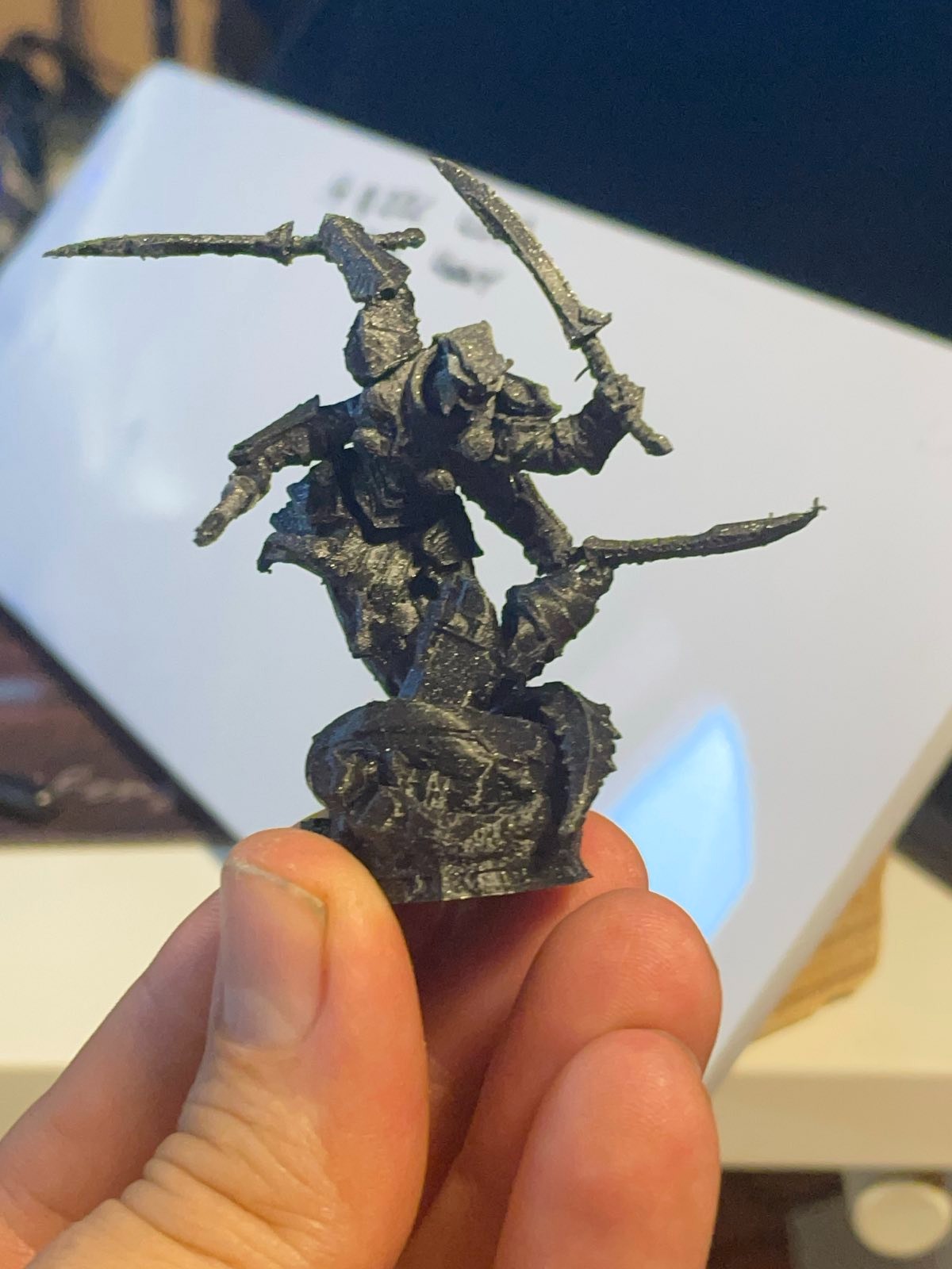

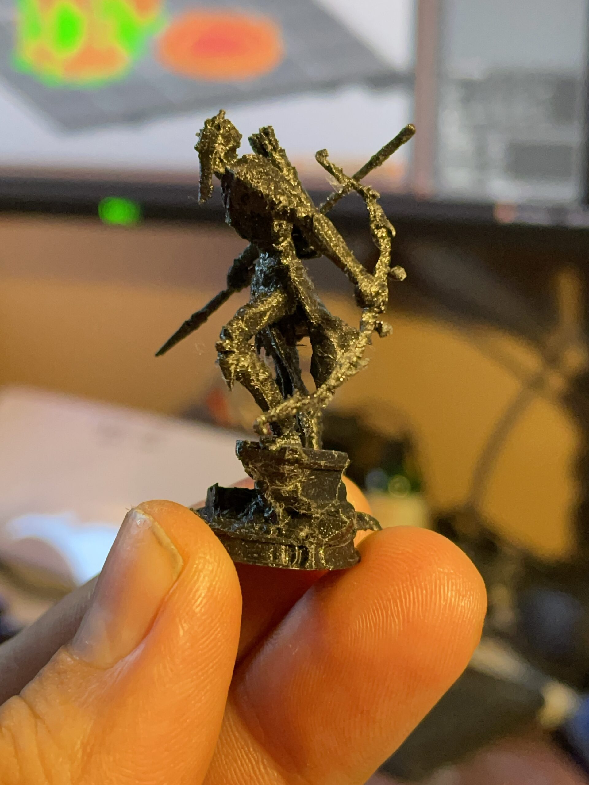

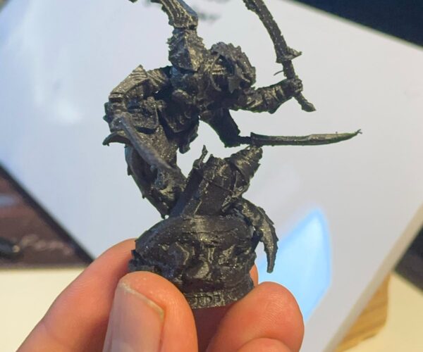

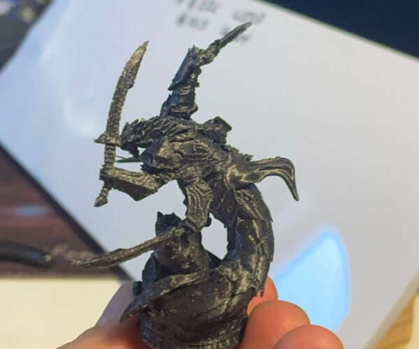

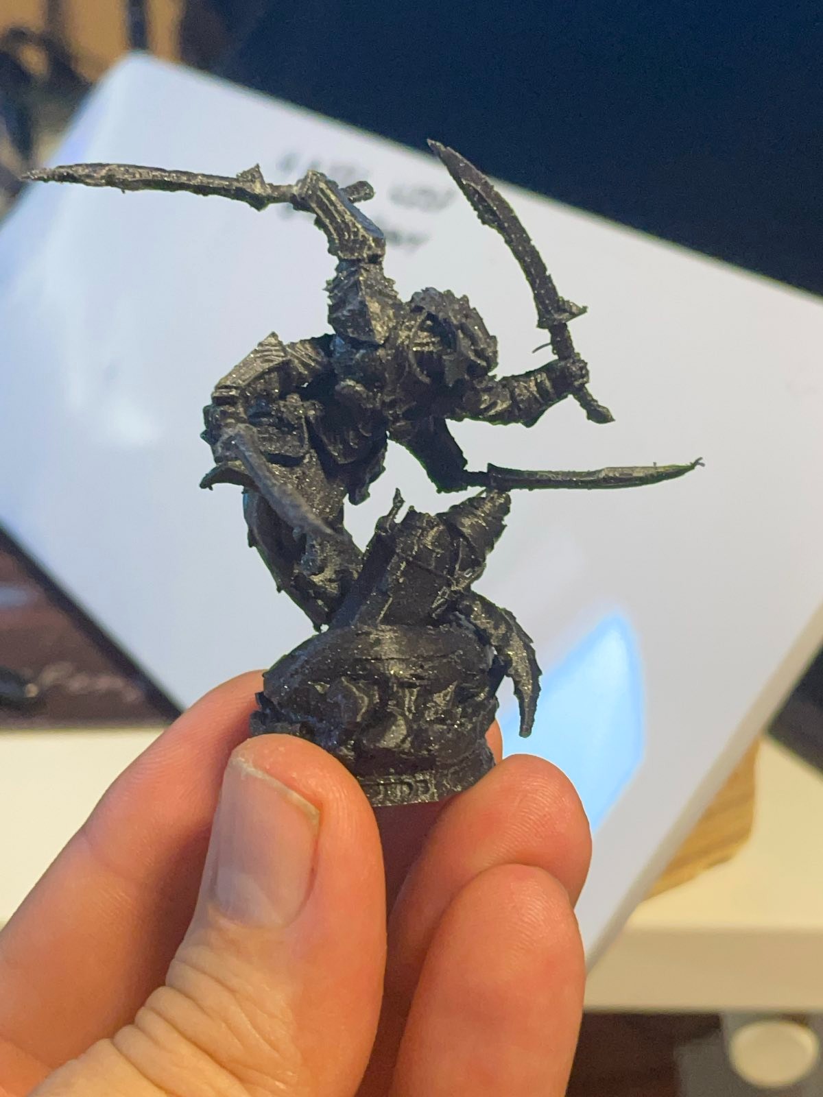

Paul Harbin
(@paul-harbin)

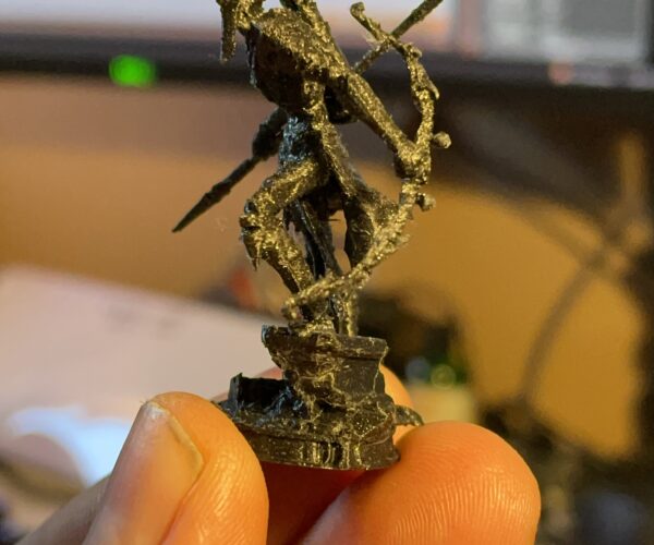

So, as it now stands ... after painful several days fiddling ... the starting point for me MK4 V6 Adapter with Nozzle X.25   Getting consistent acceptable results
With
Prusament Galaxy Black:
Extrusion Multiplier is back @ 1
Noz 225 -220
Bed 75-70
THE BIG THING
Cooling
Fan speed:  Min:50 Max:75
Overrides:
Length: .8
Lift:  .1
Retraction Speed: 35
Print Settings:  .07 Ultra Detail .25 base with the following changes.
Layers and perimeters:
Perimeters 2
Avoid crossing curled Overhangs
Infil:
30%
Gyroid
Support Material:
Organic
Top Contact .15
Rect. Grid
Top Inter 1
Bottom Same as
Branch Diameter 2.5
This is now my "fine-tune" starting point for minis.
Posted : 03/09/2023 9:29 am
Paul Harbin
(@paul-harbin)
RE: Filament / Printer profiles
Really proud of this one. you can see the end curls on the bow. And I have slowed down my support removal process. 4 cut stl from witchsong on MMF @ 1/3 original scale.
now to fine tune this Prusament pla.
Posted : 04/09/2023 6:06 am
