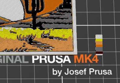

Denholm365
(@denholm365)
RE: Color change, dot outside printing area?
@Joan :
Oh it is a design trick not a parameters for the slicer. Ok, it can hide ( not fix ) the issue on design not to much demanding where you can sacrifice a layer to the previous color 😉
But it will not work on layer swaps model such as models out of Hueforge for example.
This is an example of what I called here my "MK4 dot tower" in early talks here, which duty is to get the splash when nozzle get back on model.
I never felt the need on MK3S+ of it, but is a currently a must have on the MK4 for me.
extra components to get the dot after color change on MK4
