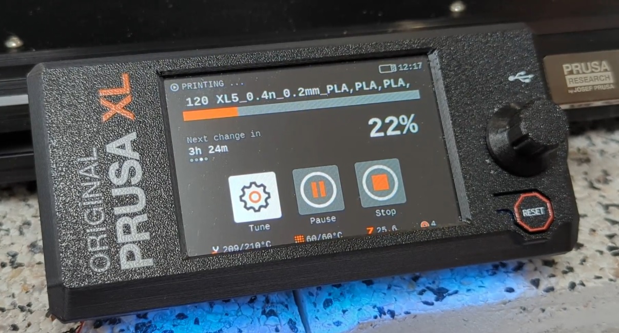

After installing the 6.0.0 alpha firmware on the XL5, I realized the filament change time has been added on its display ( picture below ) !
I have now good hope to enjoy soon this MK3 legacy feature also on the MK4 😉
XL5 displaying when filament change will occur, since 6.0.0. alpha firmware
