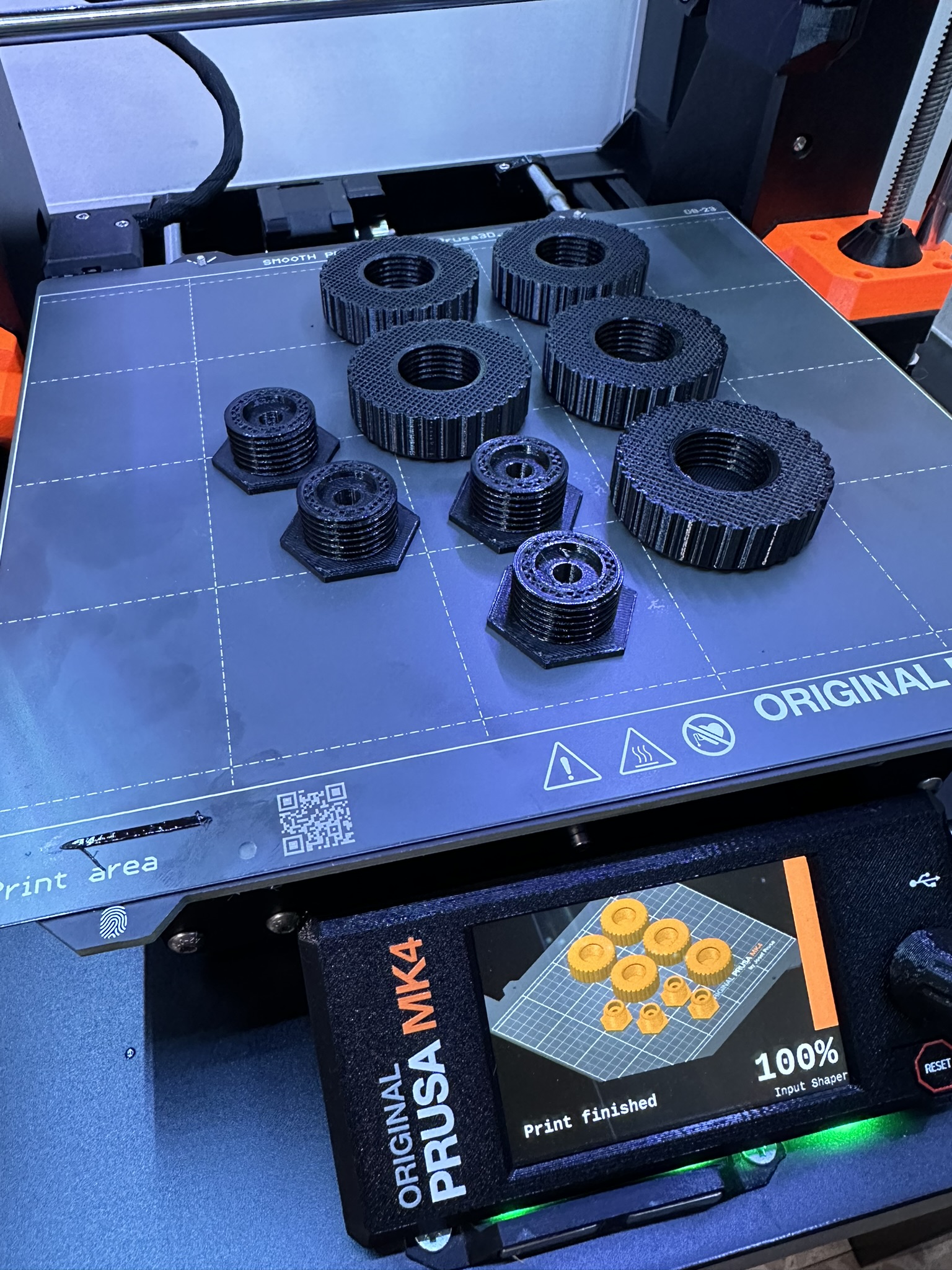

I just had the same issue. The print completed "successfully" though at some point the print continued without extracting filament...
