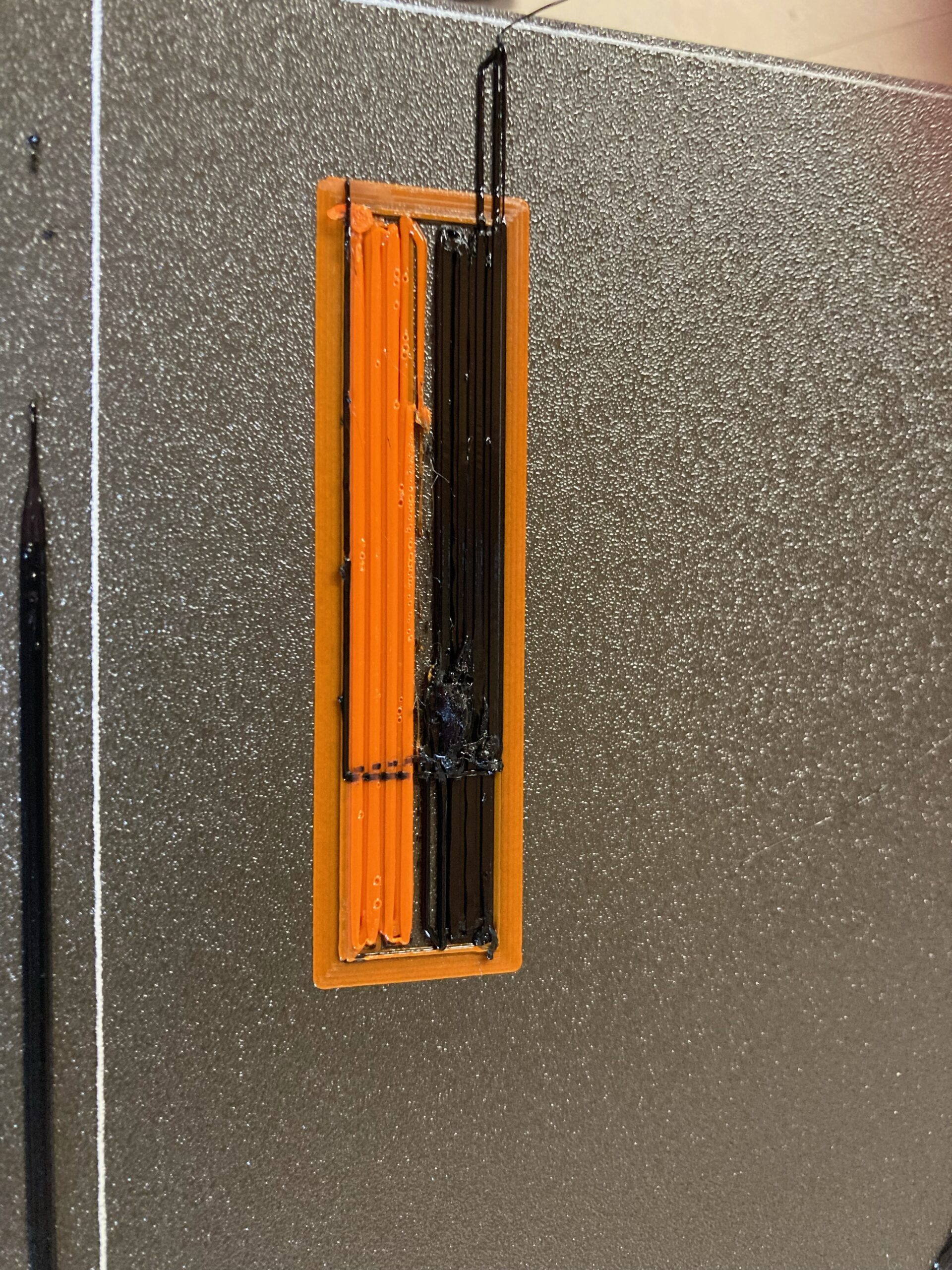

Hi everyone,
I have an issue with a my most recent prints. I have tried printing it about 8 times and every time have a massive layer shift. Not just a tiny shift due to an issue with the belt. I'm talking of a 1-2cm shift (see images). Previously the printer printed fine.
I have tried many things to resolve the issue but without any success:
  • rechecked x+y belt tension
  • recalibrated x+y axis
  • cleaned nozzle
  • re-sliced model
  • used different infill patterns
  • reduced printer speed to 50%
I'd appreciate any hint or tips, as I don't know what the actual problem could be. I don't think it is a physical shift of the print, as the printing plate is still well in position after failure.
My printer also has a MMU.
Thanks a lot and best regards,
Phil

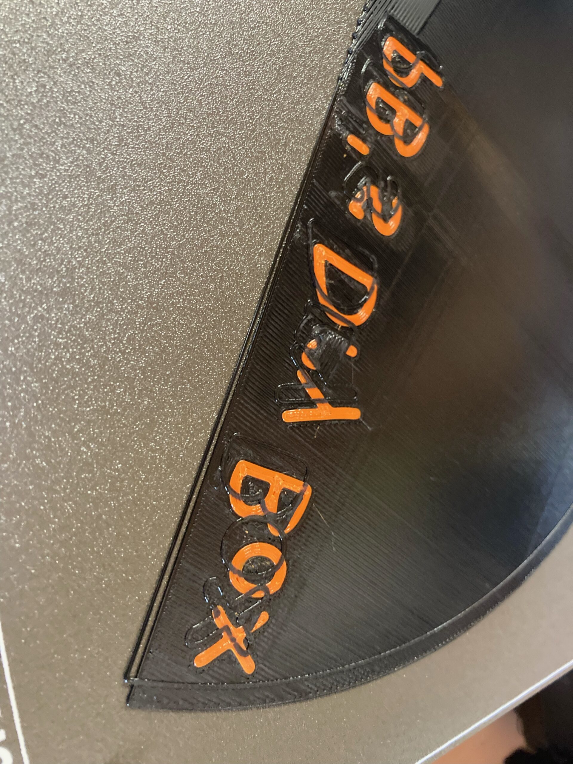

Yes, I have the same issue, mostly with boxes.  It is a recent occurrence, only the last month or two.  Models that printed with no issue before, are now having issues.
With the boxes, at best, I now have a seam at the top layer of the bottom.  At worst, a huge offset.
To be honest, I don't think there is anything that can be done on our end until Prusa releases a fix.

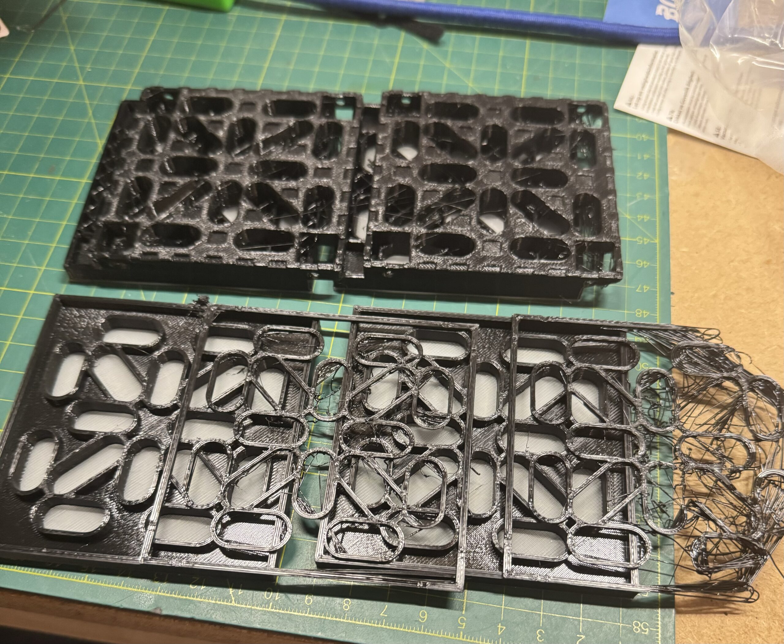

Happening to me now also, after checking all belt tensions etc and of course this is only happening after 5 of the 6 hours of the print is done and its a massive shift. I just disabled IS and am trying a third. I'd like to send Prusa a bill for the 10 hours and filament I just wasted lol.
