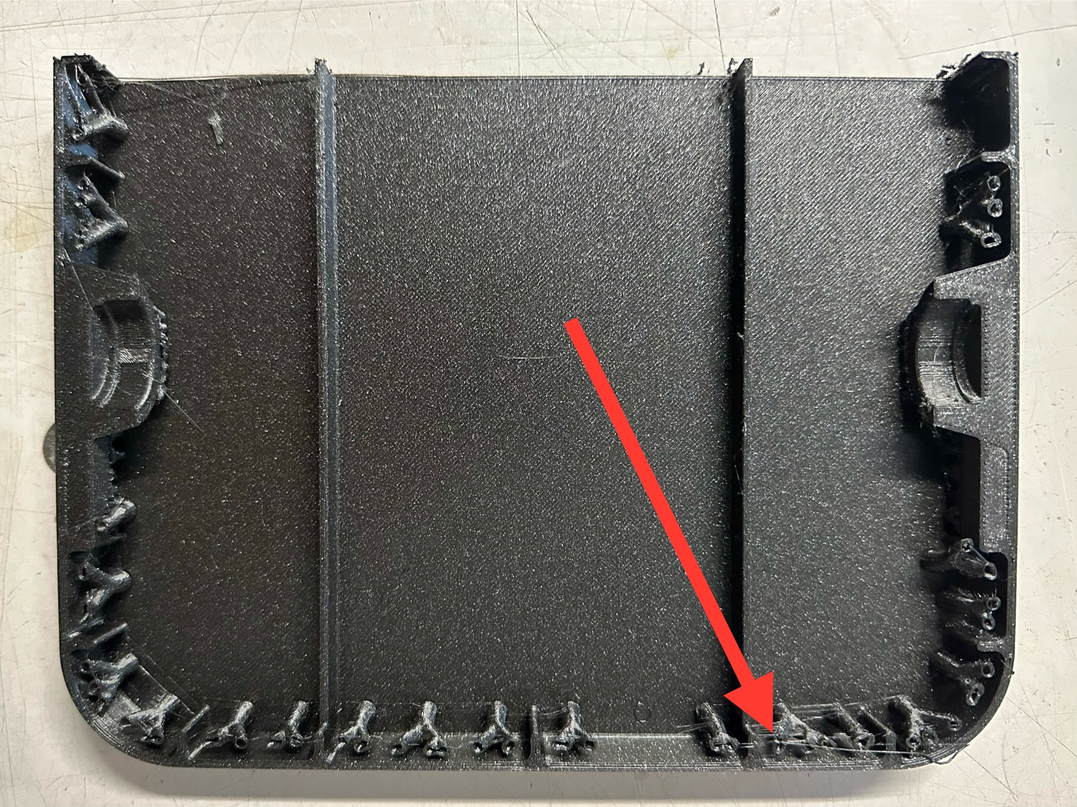

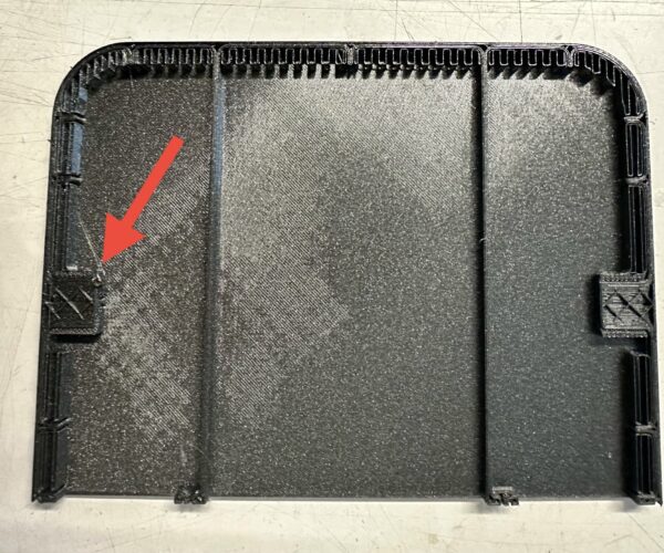

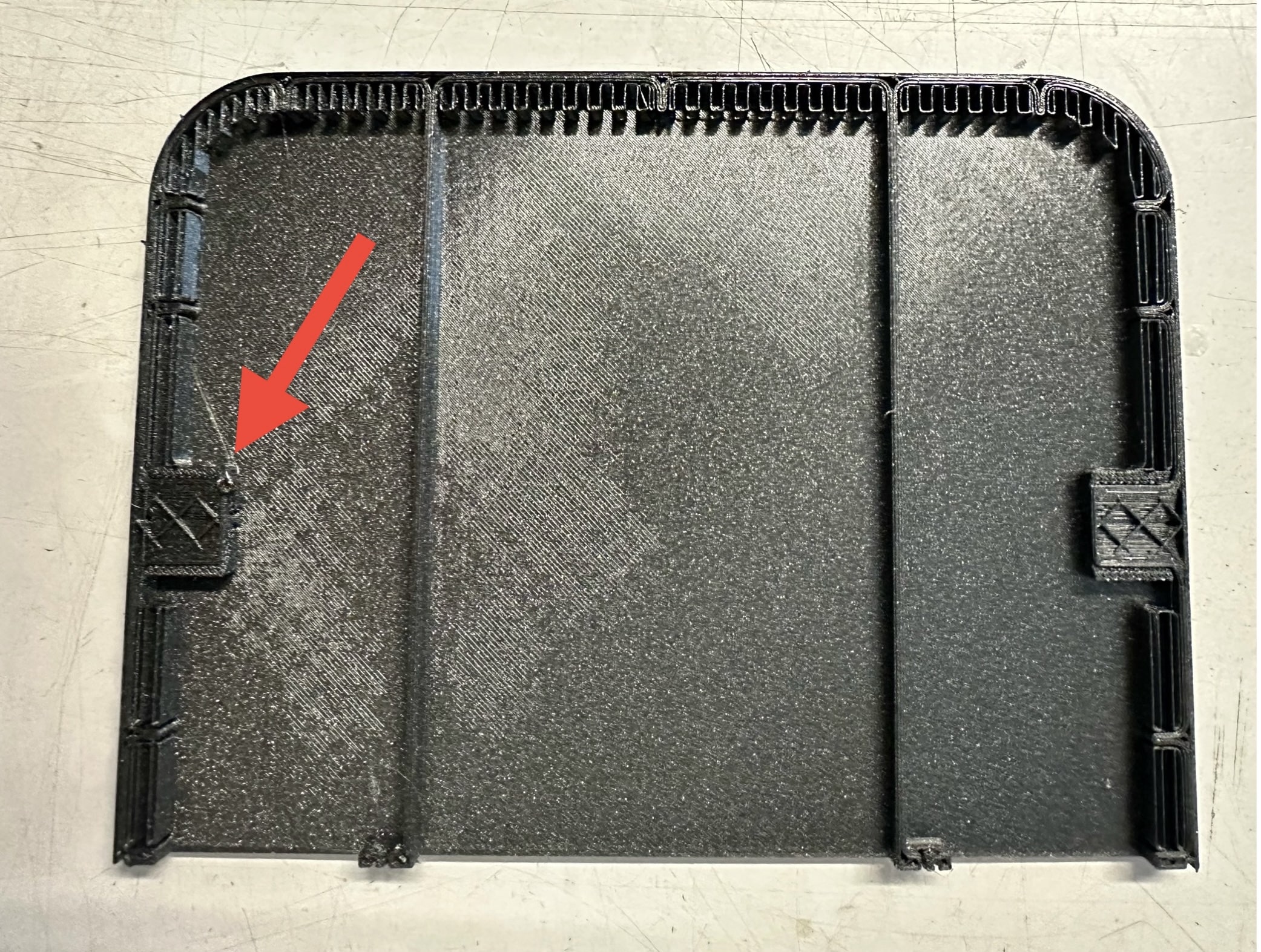

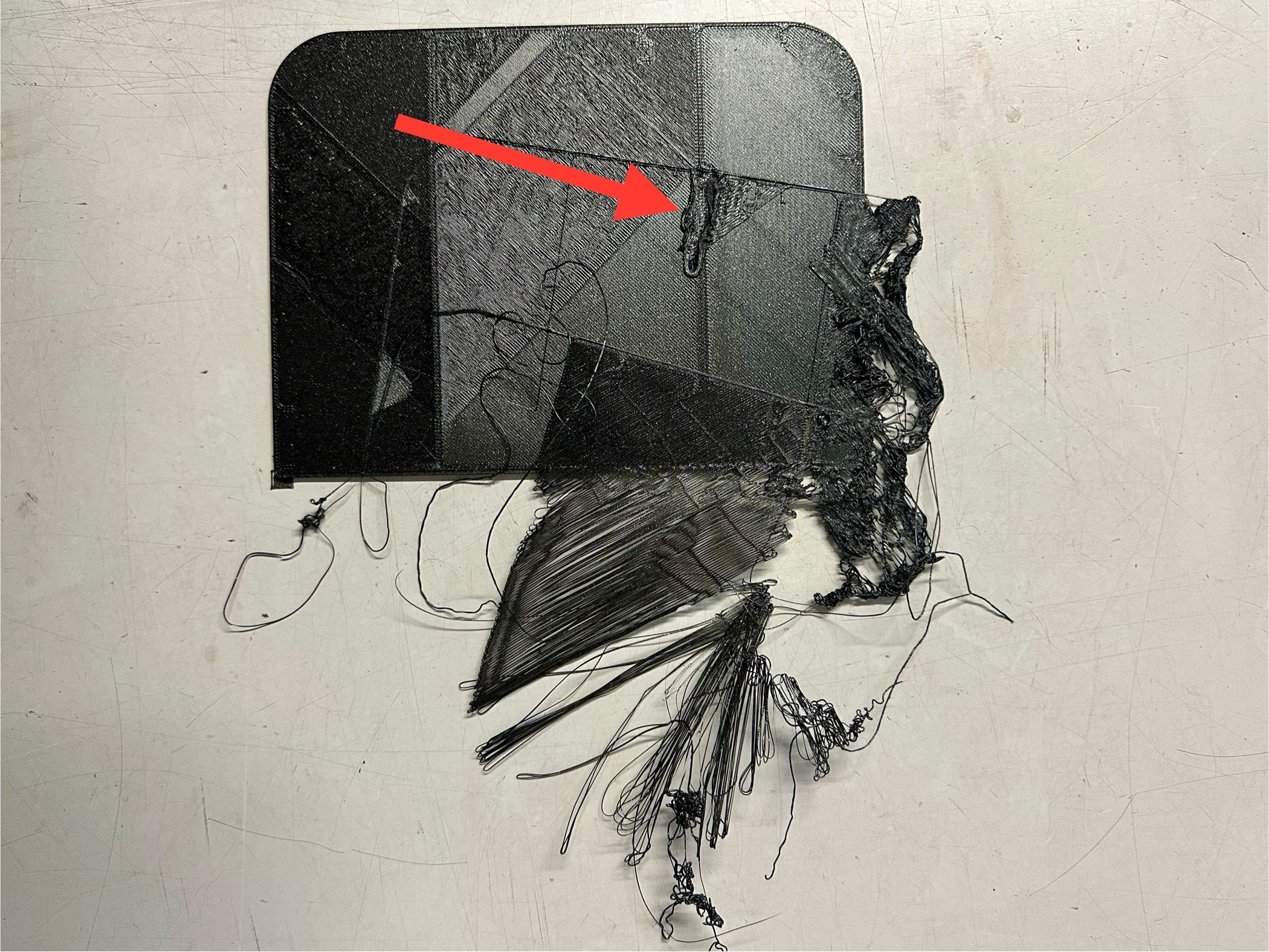

I can confirm your issue. I connected the Original MK4, Firmware v5.1.0, with https://connect.prusa3d.com and started several prints. Everything worked fine for about one week. After this time I got catastropic results and was not able to finish prints with a duration longer than 2h.
Issues were same as mentioned in the previos post:
Instead of completing it just hung in position at the first layer keeping the bed warm and the extruder hot for many hours until I noticed it.  The screen showed it was still actively printing but nothing at all was happening.  It did some damage to the print bed where the extruder was in contact with it.
I reset the printer and installed a fresh version of firmware v5.1.0 without any connections to the internet via LAN or WLAN and everything works fine know. Is there a known fix for this issue or are there any tips to avoid this occurences when the printer us connectet to connect.prusa3d.com?
