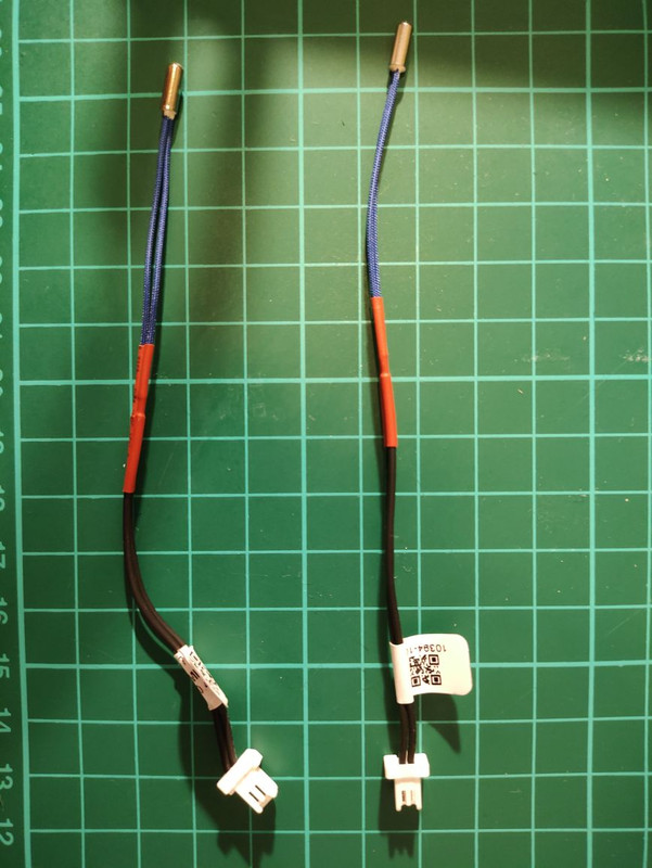

Ok, so, i'm not sure yet about the outcome, but... i tested two thermistors, the old one and the new one... and sadly both of them had similar resistance, so in the environment temp. around 24.4 C, old one had 104.3k Ohm, while the new one 104.8k Ohm. And of course, that result was disappointing because i expected silver bullet out of this thermistor 😉 so i repeated the test few times, also using other ohm ohmeter, still the results were similar. Because my previous observations were that the drift between real temp., and mesured temp. is bigger with higher temp. i tried to warm up a bit thermistor, with hot air gun 🙂 and i tested it again, so the only difference i spotted is that the old thermistor was loosing resistance bit faster that the new one, (in temp. over 50 C degrees), so maybe it's enough, i'm not sure what is the proper characteristic of the working one?

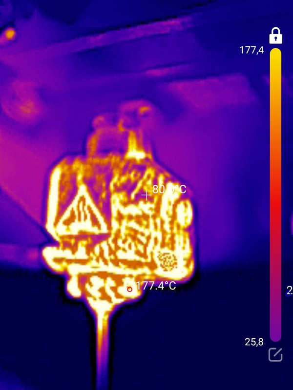

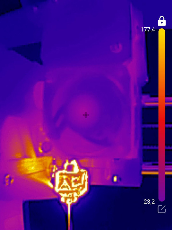

I also took some measurements before changing this part, and for example external part of hotend had quite similar temp. around 175 C, while set temp. on the printer was 240 C (i'm still trying with PETG). Because i was not sure if it should be like that, i took similar photos of printing now mini, and there was similar, set temp. 240, read with thermal camera around 170, so maybe it's normal? I don't know what should be the difference in such case.

This is hotend, before and after replacement of the thermistor the temp. was similar...
wider shot, but i did the test with mini+, and there also the difference in the photo and set temp. was like that.
Here warming up thermistor, the old one, was loosing resistance faster due to the higher temp., and it's the only thing i observed so far that it's different between them, still the difference was not huge.
And on the left side thermistor which was inside the printer, and on the right, the new one.
RE: Squashing Multiple MK4/2.71/5.1.2 Issues and horrible top layers
old thermistor on the left:

Hi, i wanted to confirm that replacement of thermistor solved the problem of "brittle petg". Also please notice that in room temp. around 22-24 degrees C, the resistance was similar, only when thermistor get hot, broken one changed the characteristic faster (at least i was able to observe/measure like described above).
