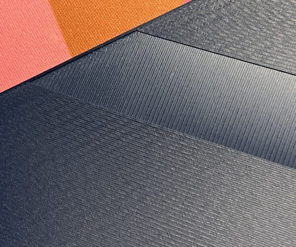

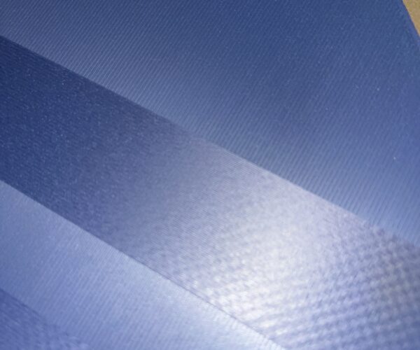

I've been getting these really weird and extremely annoying mid-layer skips on both of my MK4s
Everything is going fine until it suddenly skips 50-150 lines of GCODE and then resumes further along
And when I print the exact same file again it works...

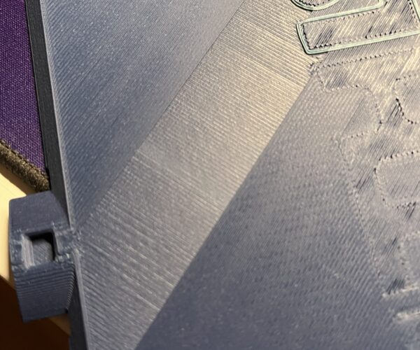

Yeah, it skips something like 70-150 lines of gcode and then continues on as if nothing had happened :-/
If it happens during infill its not a big deal but sometimes its top layers or outer perimeters...
I have 2 MK4:s, one factory assembled and one from a kit. Both printers have the same issue so thinking its either something in the firmware or enviromental

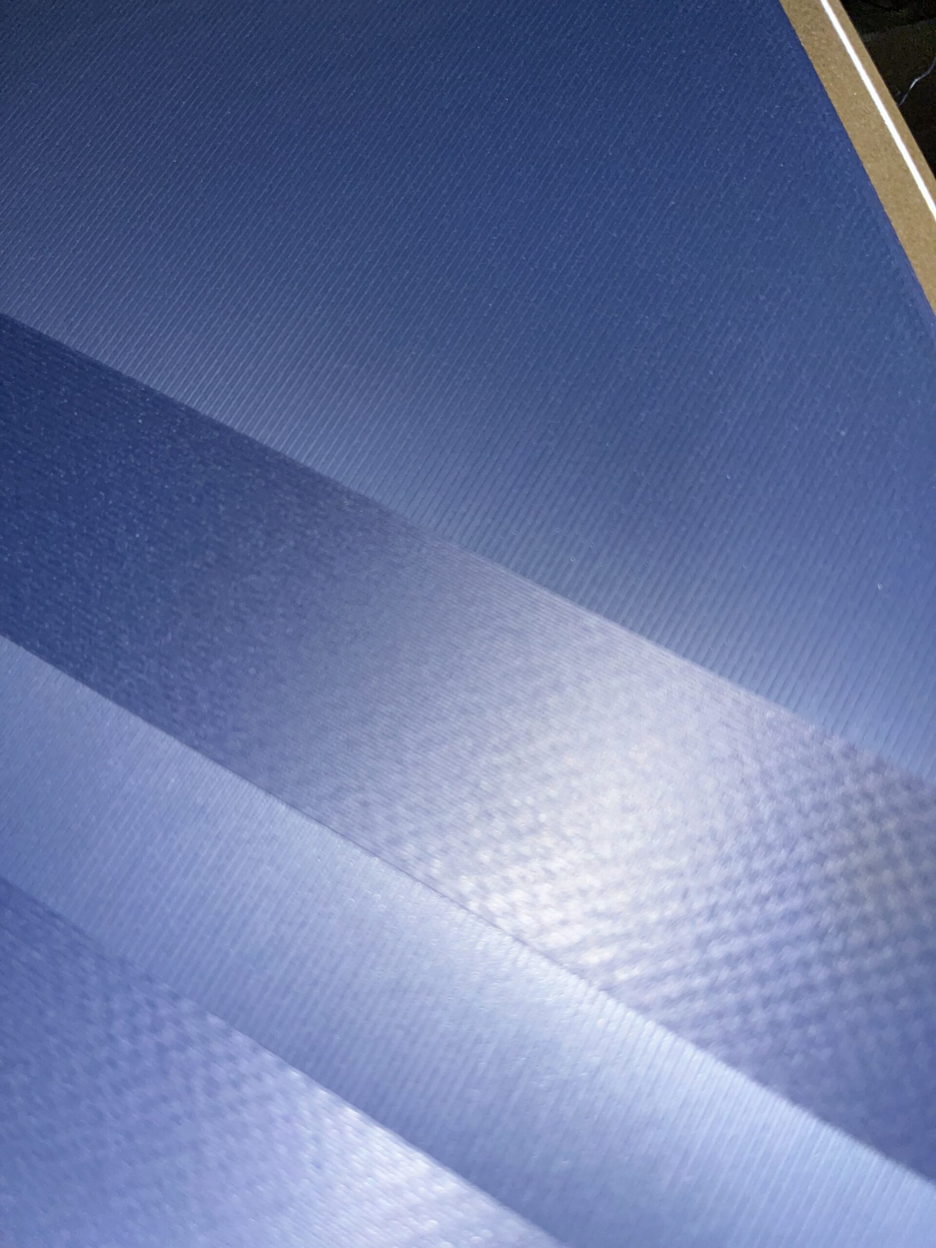

I'm having the same exact problem, except I have two MK3.9 printers. Both printers do this, both are totally random, sometimes they skip a section, most of the time they don't, even when printing the same exact file that's been stored on the USB stick. The layer number, location, and length of section that's skipped also seems totally random. I've seen this happen with my own eyes, it's printing along just fine then suddenly the extruder jumps forward to a different part of the layer, or moves to the next layer and starts printing away again. There's no error message, nor anything garbled on the display. The printer does not seem to know it just randomly skipped part of the GCODE. Very annoying because it completely ruins the print as the next layer won't stick, then it creates a big globby mess.
