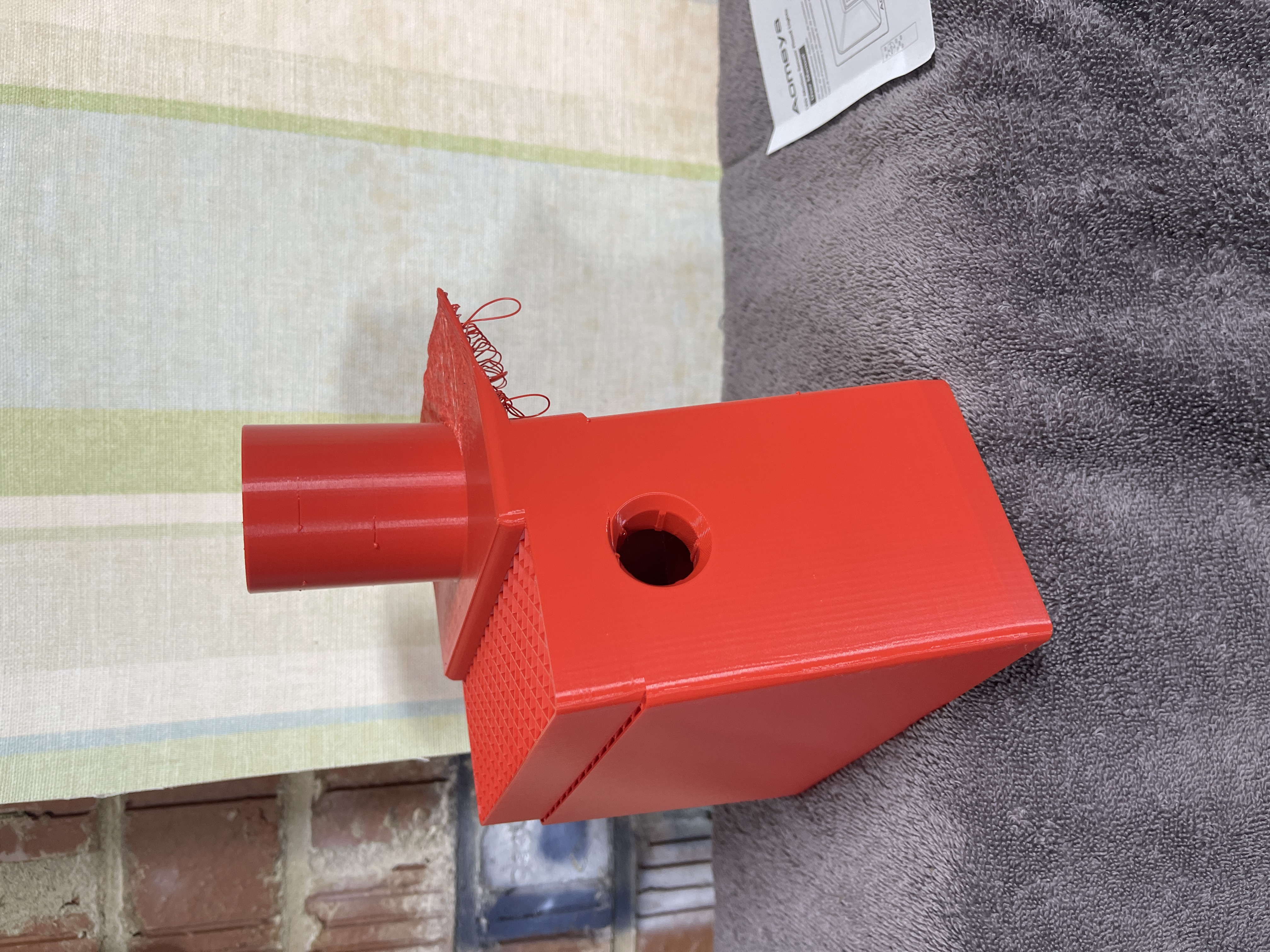

Hi, I’m pretty certain that the temperature dropped to a point where the printer was unhappy - I’ve tried switching it on when the temperature inside the enclosure is under 7 deg c and I’m greeted with an error message and the printer refuses to boot up. I found that I need a temp of at least 8.9 before I can properly start. I believe the temperature will have dropped overnight to nearer zero and the print moved on the bed (was a big print (the body of giant Lego minifig). I’ve only ever had issues when the temperature drops too low. Even with my enclosure (used for dust and draught reasons) the temp can drop too much - it is sat in a brick garage that is not connected to the house so it does get pretty cold in there.

And I’ve just checked the meta data for that photo I attached, it was taken on 3rd December 2023 which is right in the middle of winter in the uk

Nothing that cold here, and that was a MASSIVE layer shift.   Anyway, I've just spent three days, working on and off, to assemble my Mk4 kit.   It was slow, tedious and somwetimes frustrating, but got there in the end.   I upgraded to FW 6.0.0, she passed all the self tests, and I've just completed a simple first print which was faultless.
