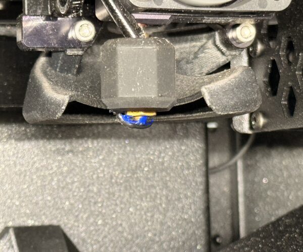

The Evidence:
The scratches visible on the sheet correspond exactly to the nozzle travel path during the Nozzle Cleaning routine — not during the print itself.
The following images show my various attempts to create a first-round Nozzle Cleaning routine failure (for the purposes of reproducing the issue). TO BE CLEAR, THIS IS AN INTENTIONALLY MANUFACTURED FAILURE CONDITION (or attempt to do so). This is NOT how this printer functions - it is thoroughly cleaned between (after and before) each print:
Images: Attempted Manufacture of Nozzle Cleaning Failure Condition
In each of these cases, while the offending PLA filament was not successfully removed from the nozzle, the printer "passed" the first-round Nozzle Cleaning routine.
The following image shows my attempt to create a first-round Nozzle Cleaning routine failure with a nozzle-covering plug of ABS filament:
Again, while the offending ABS filament was not successfully cleared from the nozzle, the printer "passed" the first-round Nozzle Cleaning routine.
