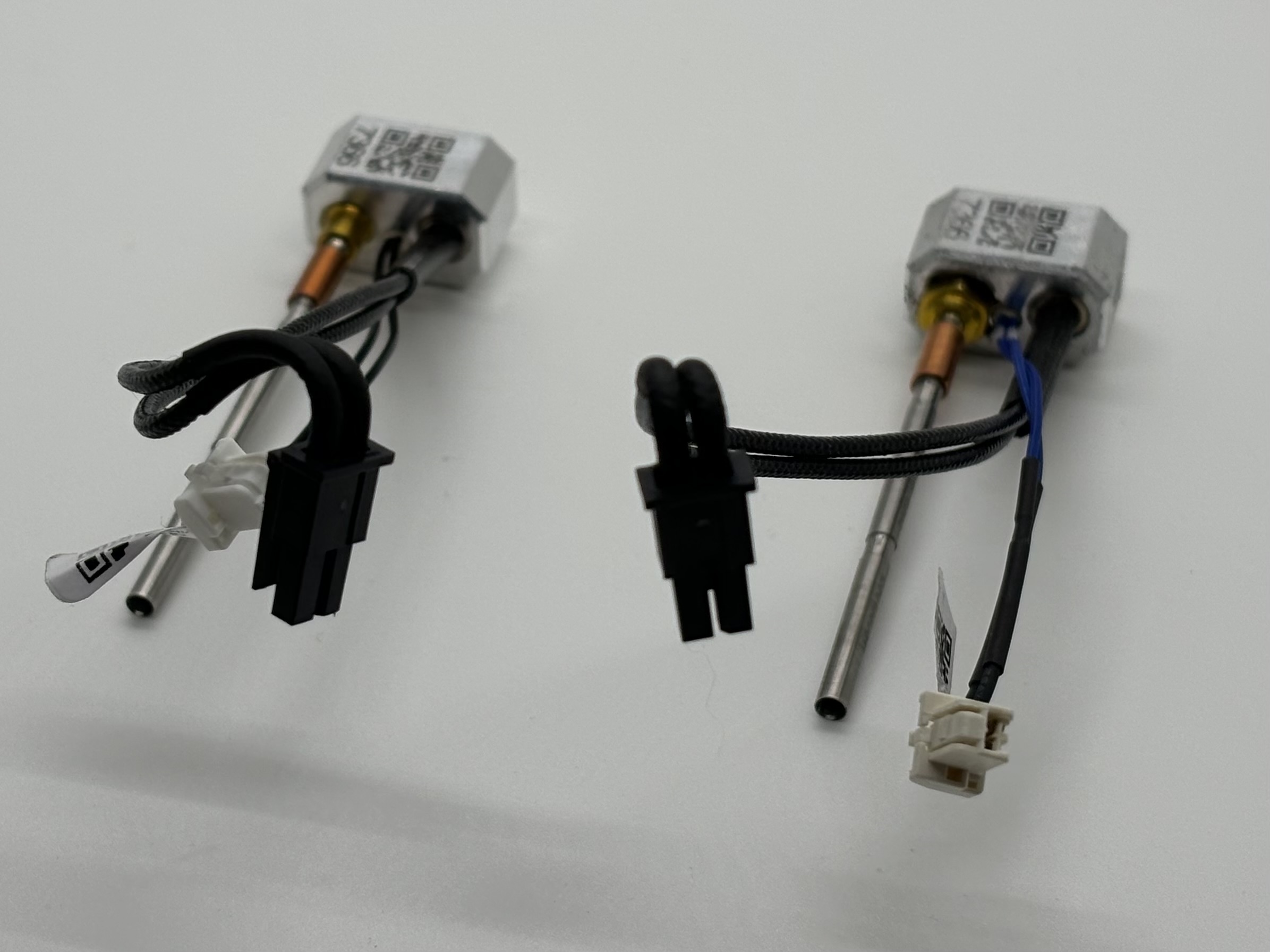

Then the question is, can we figure out what versions/brands of sensors we have..?
Publié : 20/11/2023 9:27 pm
JHenley01
(@jhenley01)
RE: MK4 PLA Stringing
These are the two I have. Blue wire one on the right is the good one. Black wire on left is the bad one.
Publié : 20/11/2023 9:33 pm
Uranday
(@uranday)
wburkett1965 what colors do you have?
Publié : 20/11/2023 9:36 pm
wburkett1965
(@wburkett1965)
I originally had blue and that needed to either be much higher or cooler and now I have black and that seems stable at a lower range. I changed to both the black ones because I was wondering if the blue might be for the XL since it was very wrong. The XL uses a different version than the MK4. Trianglelab has heaters and thermistors on Aliexpress for the MK4 now. I am wondering how they perform?

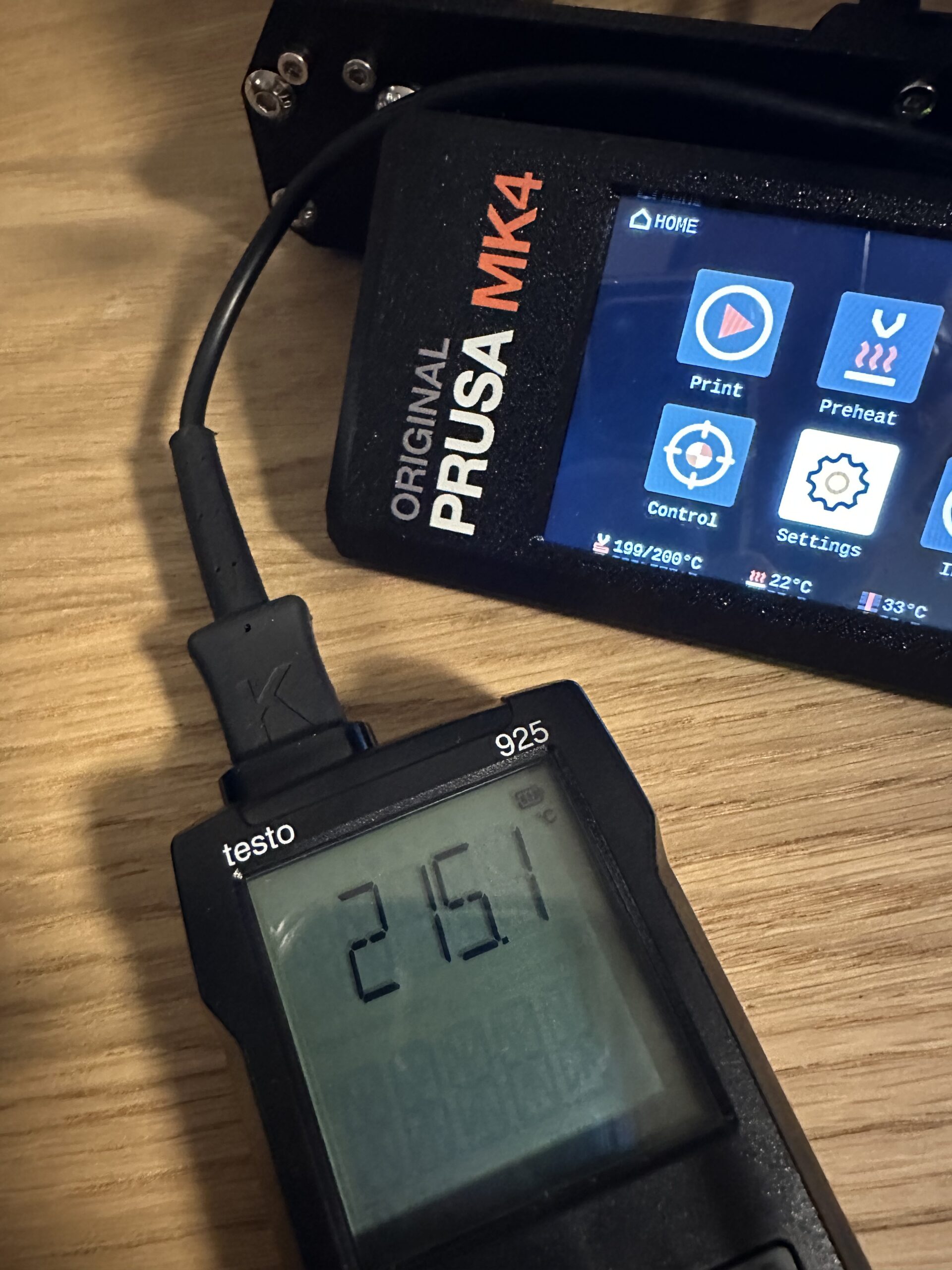

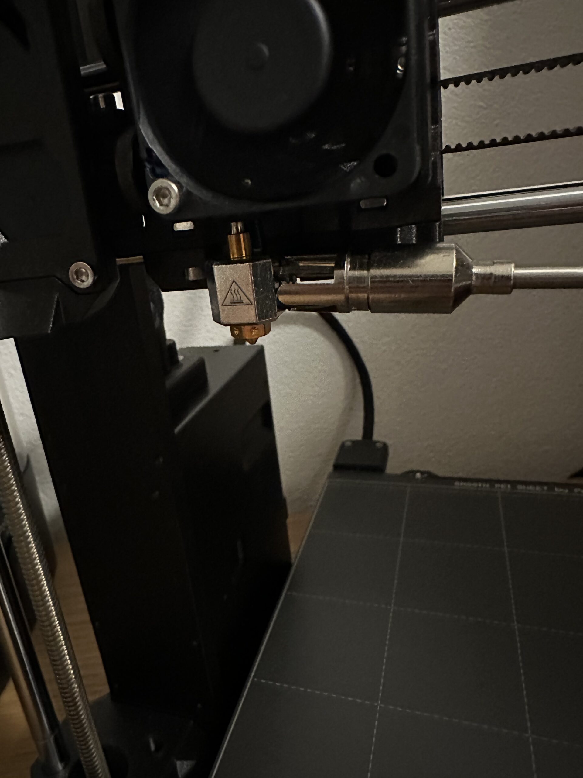

dzajonc
(@dzajonc)
Membre
hey guys.
I have the same problem with the black wired hotend thermistor.
measured the temperature at the heater block, see pics.
the real temperature seems to be 15 degrees higher than showed on the mk4.
(the measurement device is calibrated. we use it at work for surface temperatures of injection molding tools.)
(also gave the hotend a few moments to stabilize the temperature. directly after hitting the 200 degrees C on the mk4 display the measurement device even showed 220.)
hope prusa will solve this problem soon so that we can get new hotend assemblies.
Publié : 21/11/2023 6:22 pm
