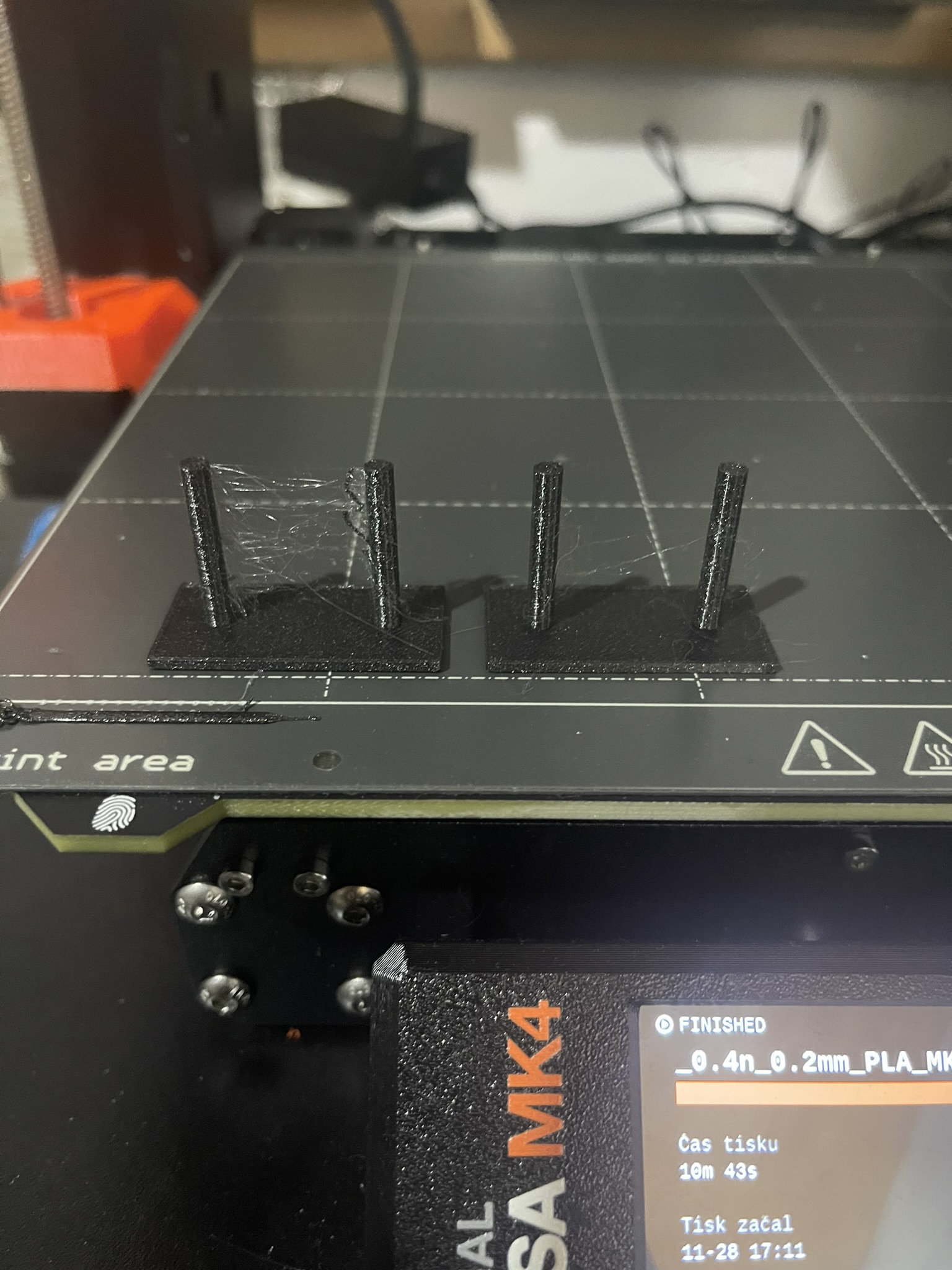

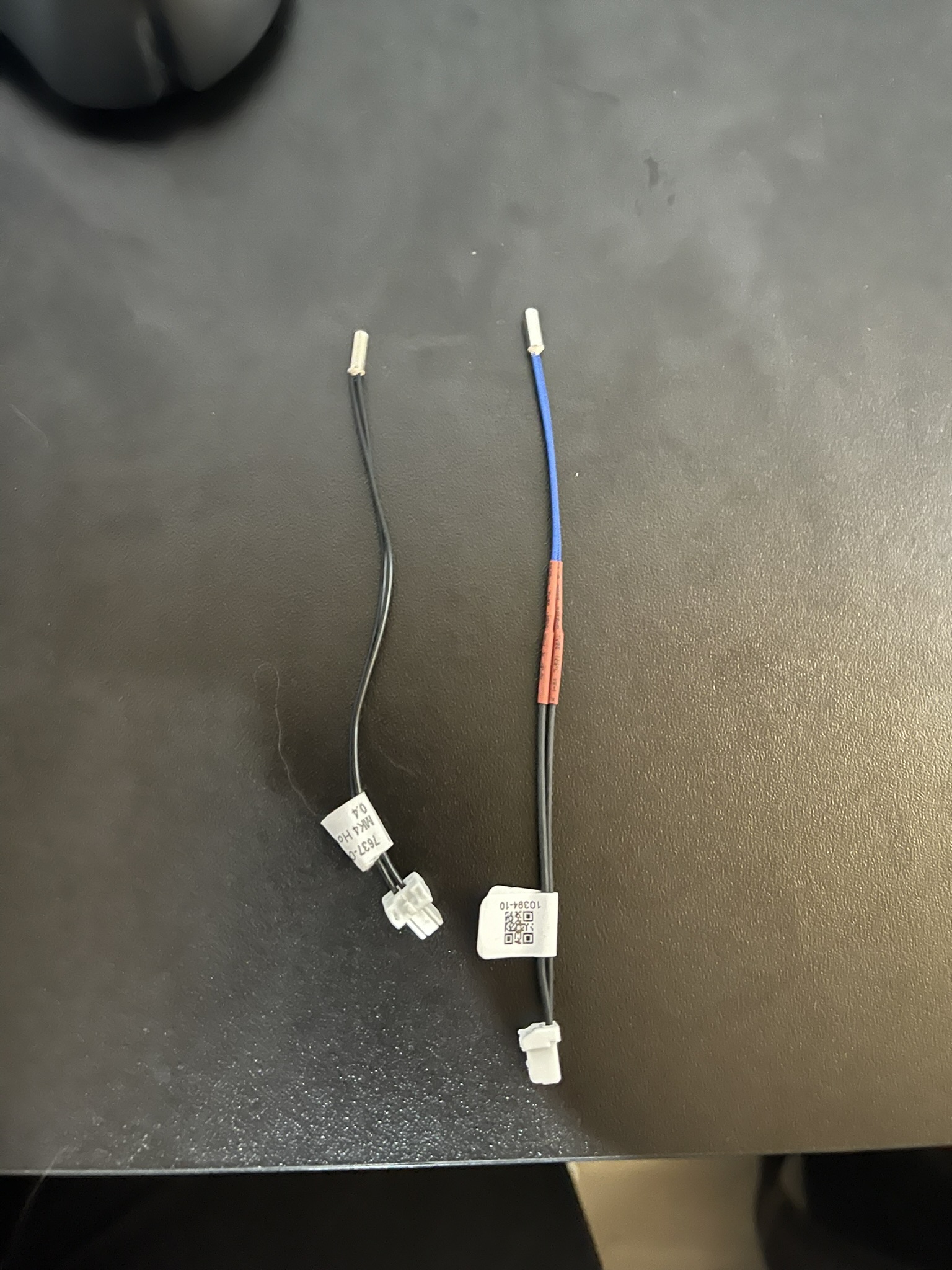

OK here are the photos.
You can see two thermistors are different. Longer one from XL worked for me.
On the stringing test. Right one is printed with XL thermistor.

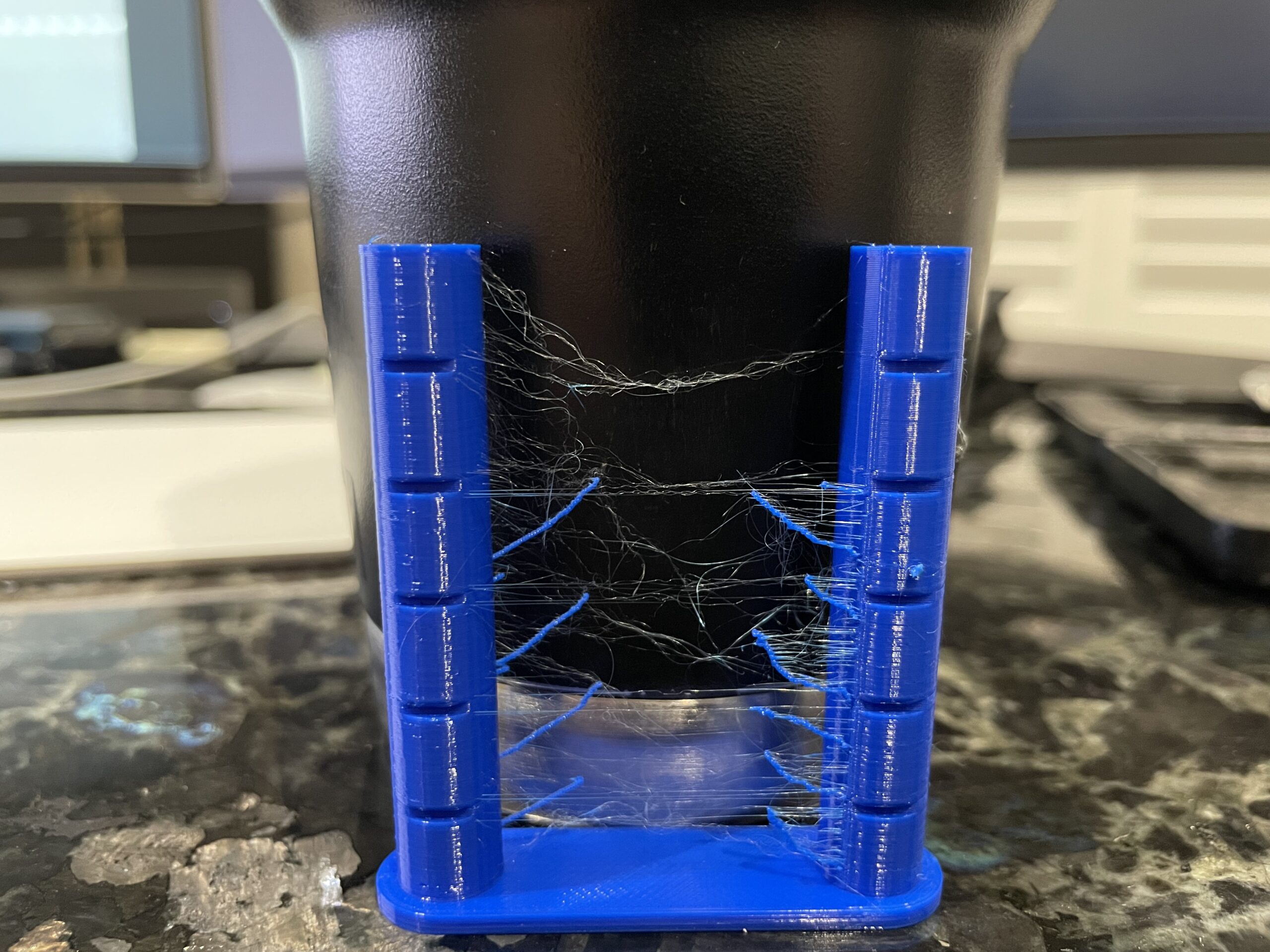

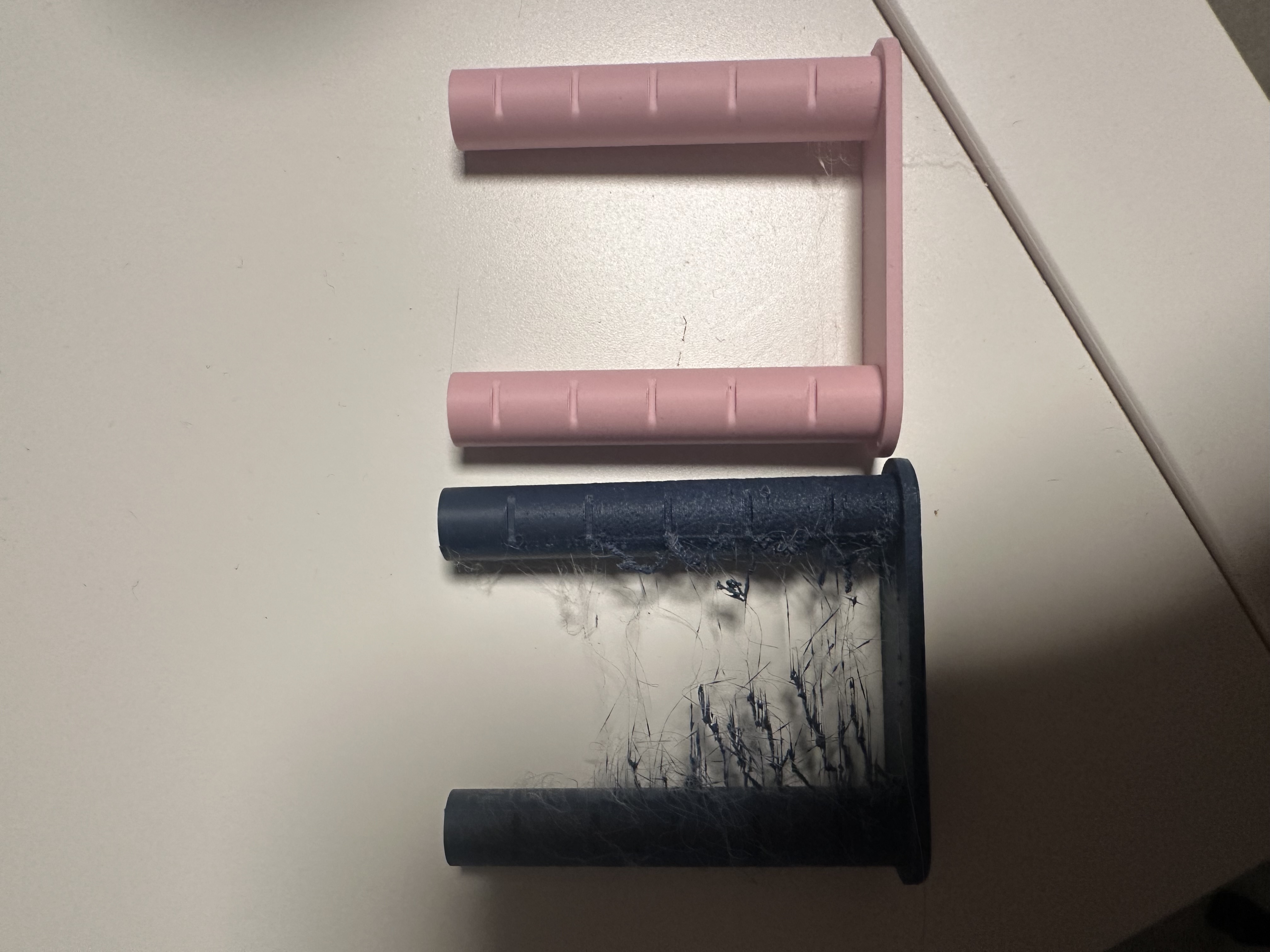

Guys, I'm glad I'm not alone on this issue, but then again I wish none of us were experiencing this issue.  I created my own string tower using 8mm section with varying temps in 5 degree steps starting with 230C at the bottom and working up to the top at 180C.  You can see in the photo (white tower) it was getting much better  at 190 - 200 range.  After talking with support and explain what we are all seeing and mentioning the fact that some of you were getting replacement thermistors (both MK4 and XL ones) they tried to brush off what we are seeing and hated more tests done.  So they sent me a string tower of there one but it only used the stock Prusa PLA filament profile which uses 220C, so you can see in the Blue Tower picture, the first 4cm from the bottom it was using 220C, but then I changed the temp from the LCD to 200C which the print was in progress and you can see that it gets much better at the lower temps.  I tried to mention that is the thermistor was reading it might account for it running the nozzle higher then what the profile intended.  Anyway he agreed to send me a new one, but he knew nothing about sending in one meant for the XL machine.  I guess I will wait and see what they send me.  By the way I've been using PLA+ from Micro Center which is mostly eSUN or Polymer filament.

Got this thermistor. I don‘t think it‘s from the XL. Neither is the one posted by jan. If you have a look at the help page on how to change the thermistor, there is also a picture of the longer version.

Are you sure? I got the same that you got (orange in the middle), which is exactly the one from prusa help article from the Mk4. The XL thermistor looks different on the pictures

Well you are right. XL on the shop doesnt have orange shielding in middle.
But markings on package are the same. Also same lenght.
I think we are left for guessing until Prusa release some official statement or shop is updated. Until then this looks like they have multiple version of thermistors.
What we know now is that black wired one is not working correctly for some users. And new one from support is same lenght as XL thermistor. Maybe i will try to order XL thermistor and we will see what will arrive.

Today a thermistor with blue wires arrived.
Tested Prusament Galaxy Black PLA with standard PrusaSlicer temperature settings. There is basically no stringing. Guess for me the problem is solved.
