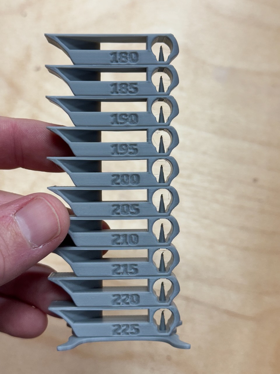

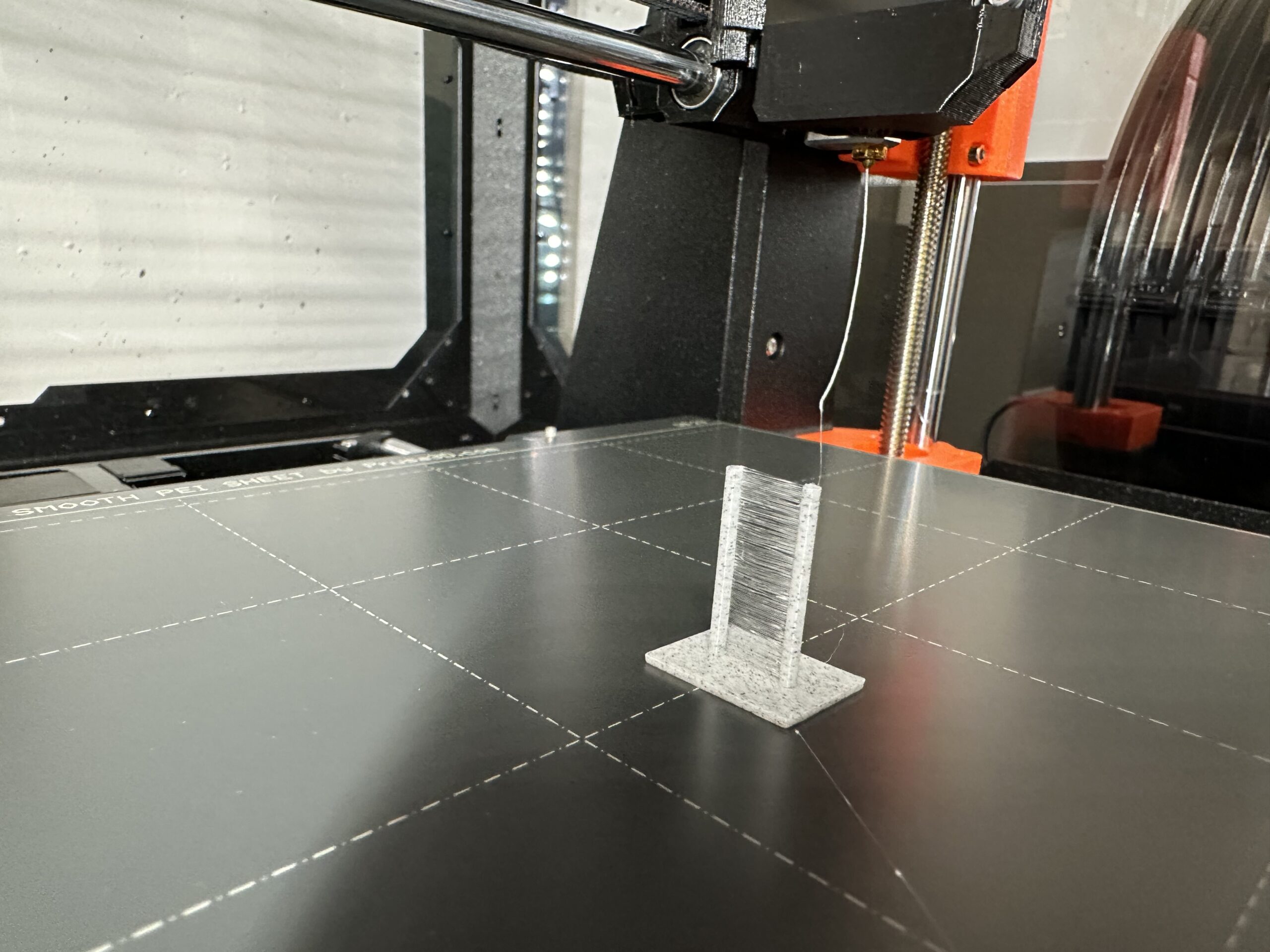

hello everyone,
I also received the new thermistor.
I immediately printed a temperature tower and it was perfect, but then I tried to print a string test with the default values for the pla prusament and the result was not perfect... better than with the first thermistor but not perfect.
So I tried lowering the temperature and noticed that around 200 degrees the strings disappeared completely, also with other string tests. (see the photos, the prints without strings are printed at 200 degrees)
I also enabled "use ramping lift" and "wipe while retracting" in the printer setting and they seem to help.

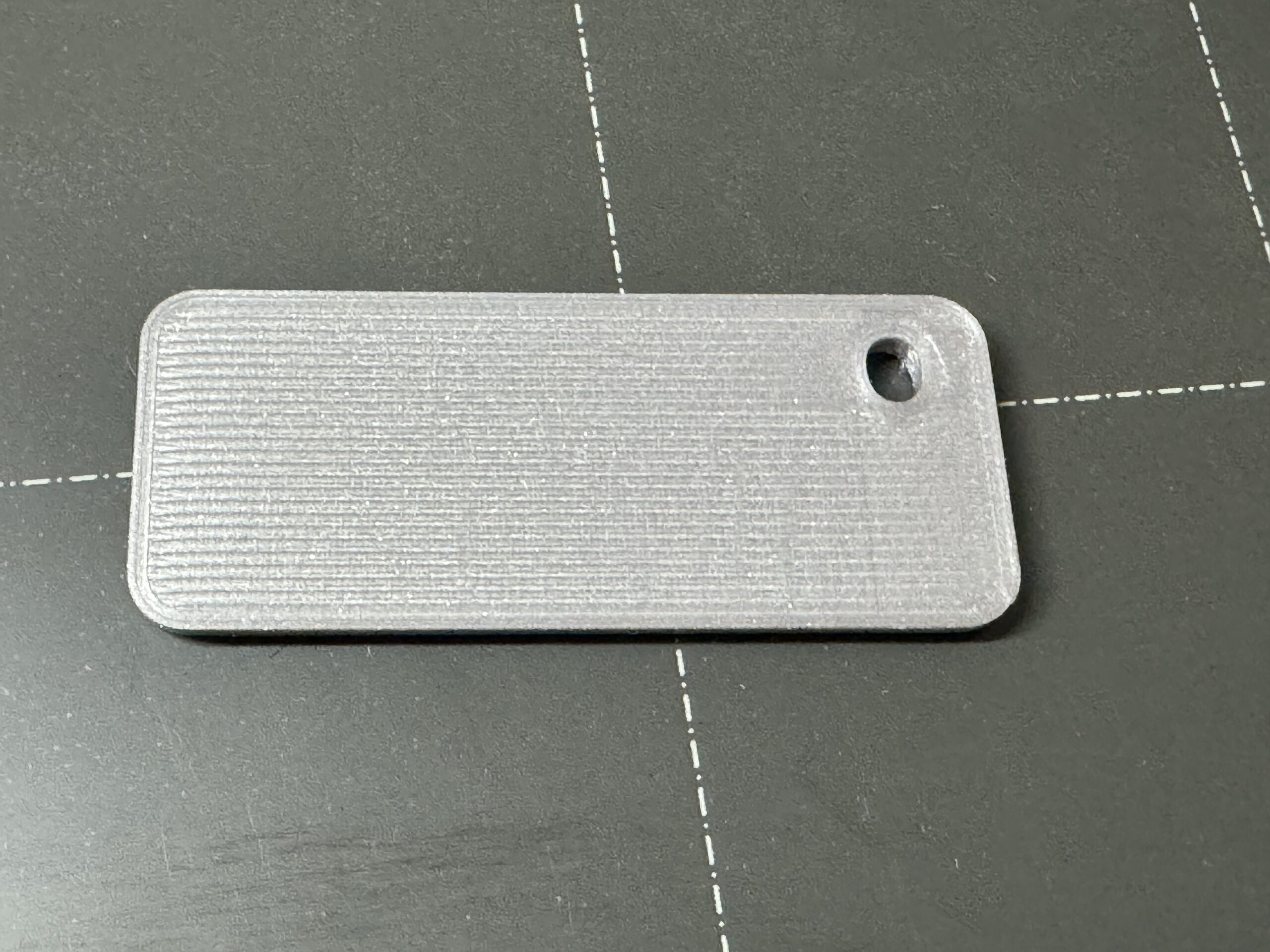

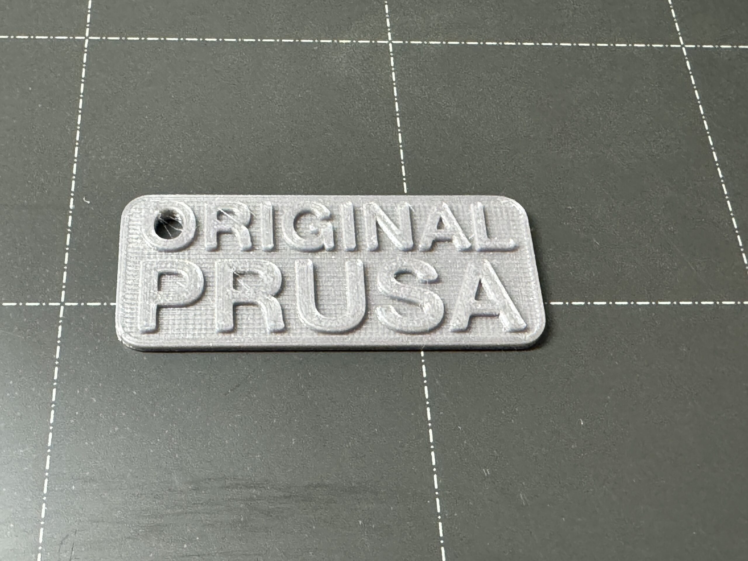

mariadumitruiulian
(@mariadumitruiulian)
RE: MK4 PLA Stringing
I got and replaced the new thermistor as well, I received the same MK4 one, not the blue with orange heatshrink. When I changed I measured both at room temperature and both showed 125-130 kohm(new one few kohms higher)(not 70-80 like other ones I've seen here.). However I changed it and print looks better,
I wonder if my problem is solved. See image below, with old thermistor vs new. Also the keychain that is already on the usb stick, with default settings (IS 230 first layer and 220 after) looks pretty decent, first layer looks good, printing has small bit stringing.
What do you think?

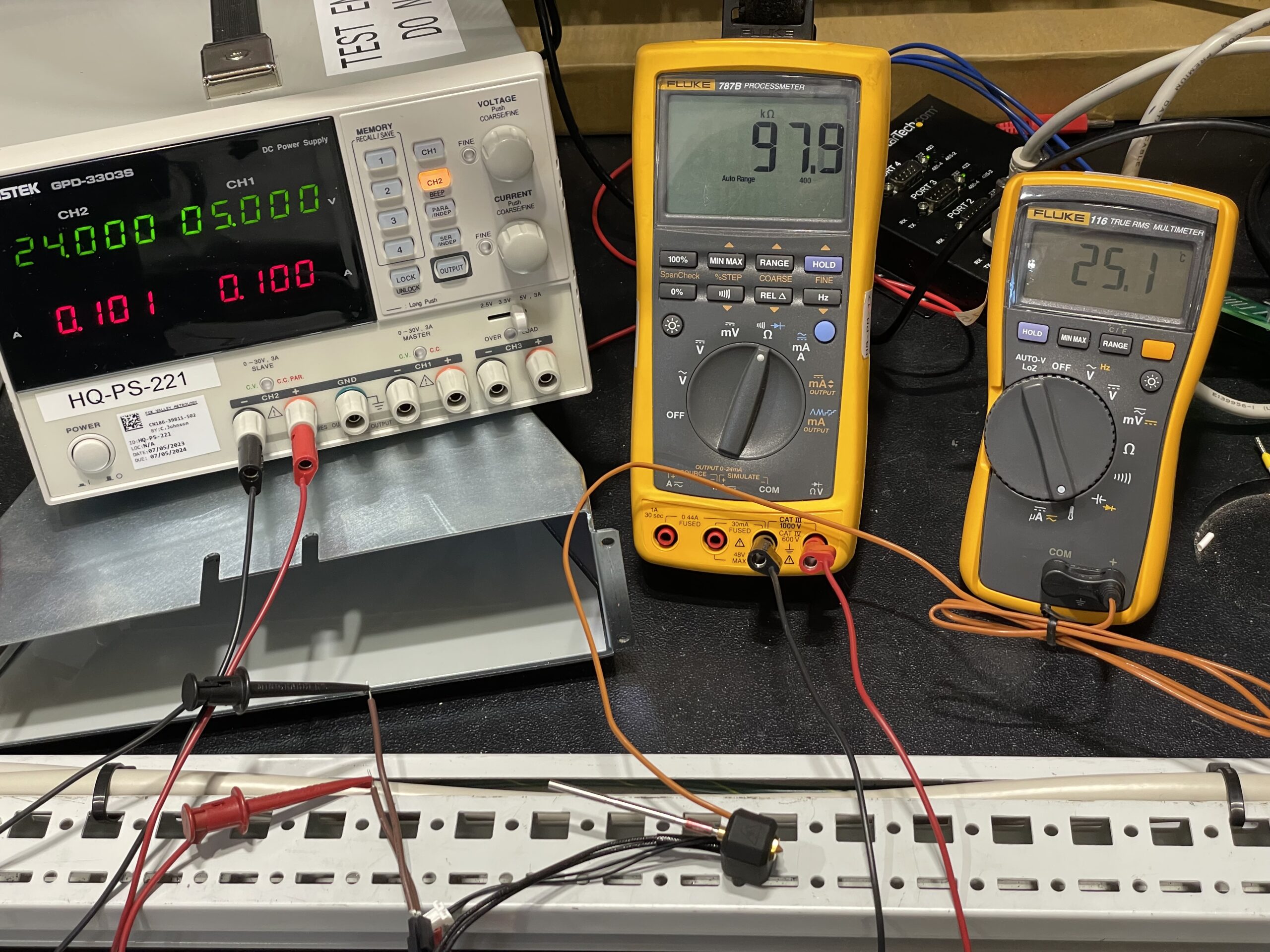

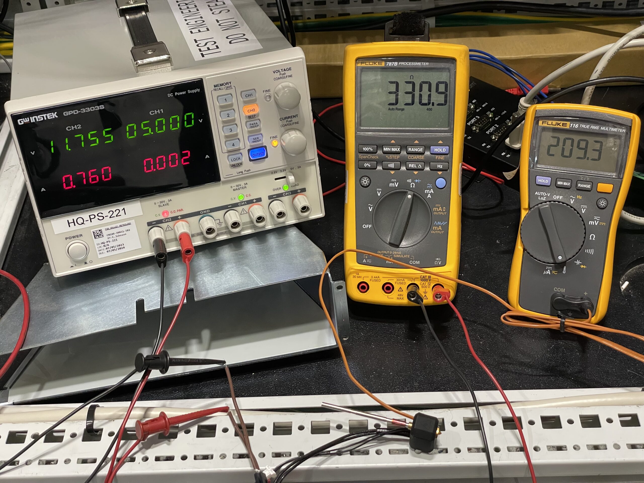

Hey all. I had a printer I had in July, no stringing issues. Occasionally some wisps and such. Then I got a 0.25 and 0.8 mm nozzles last month. I got heater blocks and thermistors too, to have entire assemblies and swap the nozzle assemblies rather than the nozzles.
Tried printing a mini with the 0.25 mm nozzle and it was…terrible. So much stringing. Like the stringing tests here.
I did some testing and it seemed the thermistor was ~100 k at 25 °C. Hot side I didn’t have a data sheet but found a spreadsheet and it seemed close, but I really need a data sheet. 331 ohms at 209 °C:
Meter on right is reading temp with a thermocouple on the side of the heaterblock, meter on left is reading thermistor resistance. Power supply was used for hot test to power the heater. Hot test current on supply was limited until the temp change was minimal (steady state, or very close to).

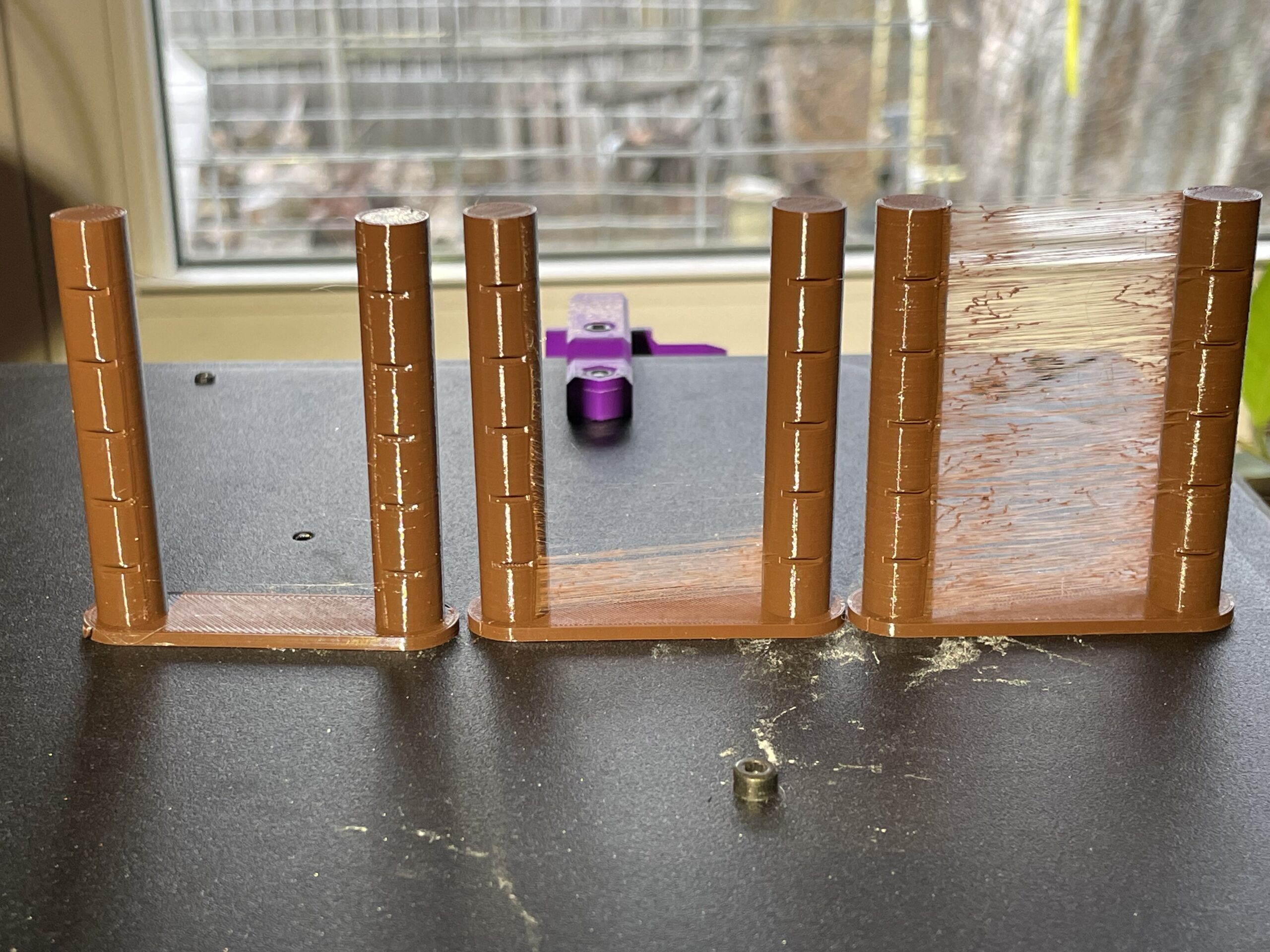

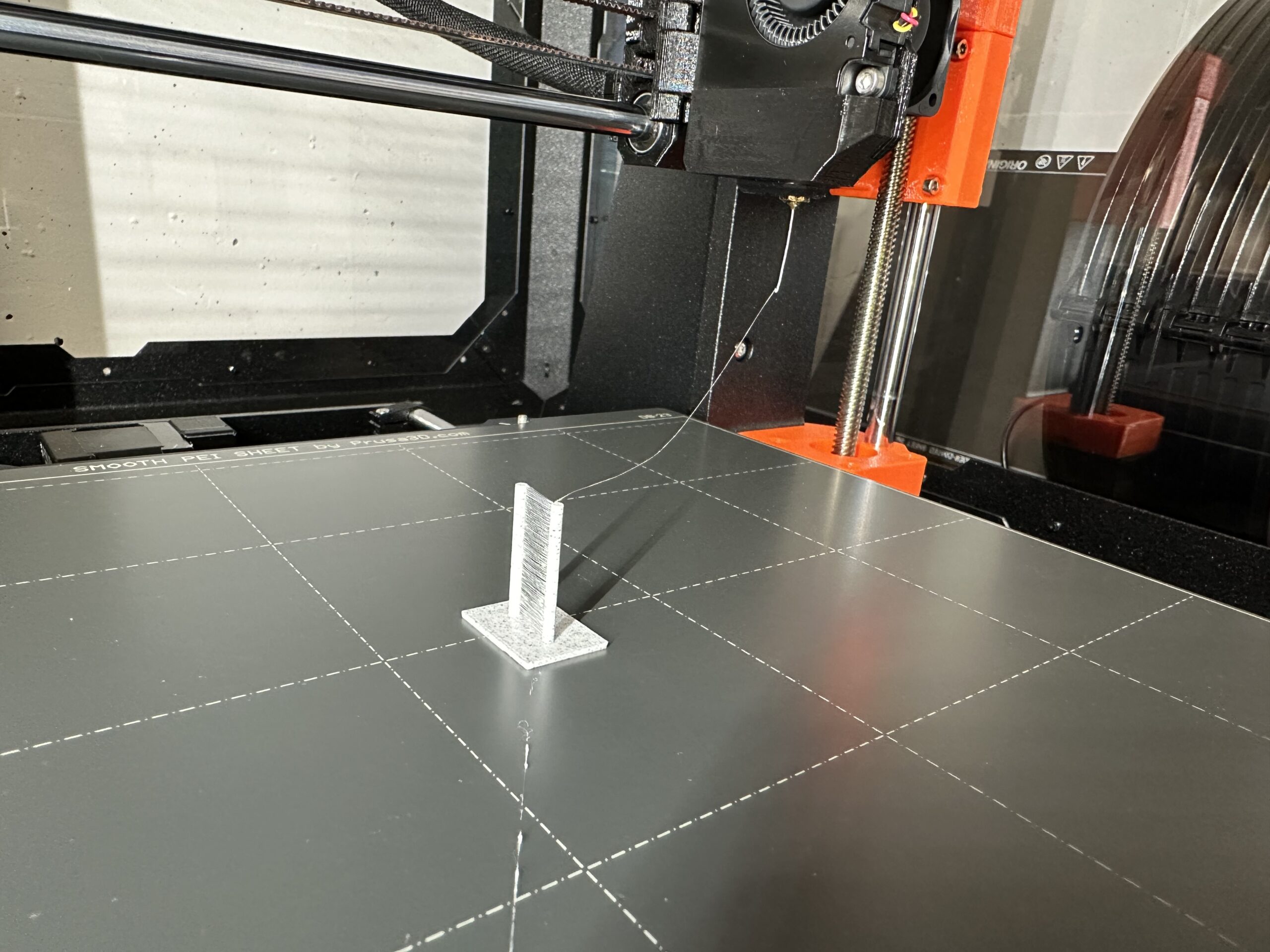

I found this thread and that spurred the testing above. When nothing obvious jumped out, I downloaded a stringing test and ran that. I think it shows a thermistor issue:
On the left is printed with IS defaults, 0.4 mm nozzle, 0.2 mm layer height, STRUCTURAL preset. On the right is IS defaults, 0.25 mm nozzle, 0.12 mm layer height, STRUCTURAL. Middle is same as right only bottom is 220 °C, then it goes 210, 200, 190, 180, 170, changing at each notch.
Seems pretty clear the issue has to be the thermistor in my 0.25 mm nozzle assembly, which again was bought about a month ago.
One last test I’d like to do is put the 0.25 mm nozzle in the 0.4 mm nozzle assembly, since this assembly had been printing 0.4 mm nozzle since I got the printer in July. If the stringing test is good, then that conclusively shows the thermistor I got for the 0.25 mm nozzle assembly is bad. Which also lines up with the timeframe of posters here getting bad thermistors with their printers, which makes sense.
