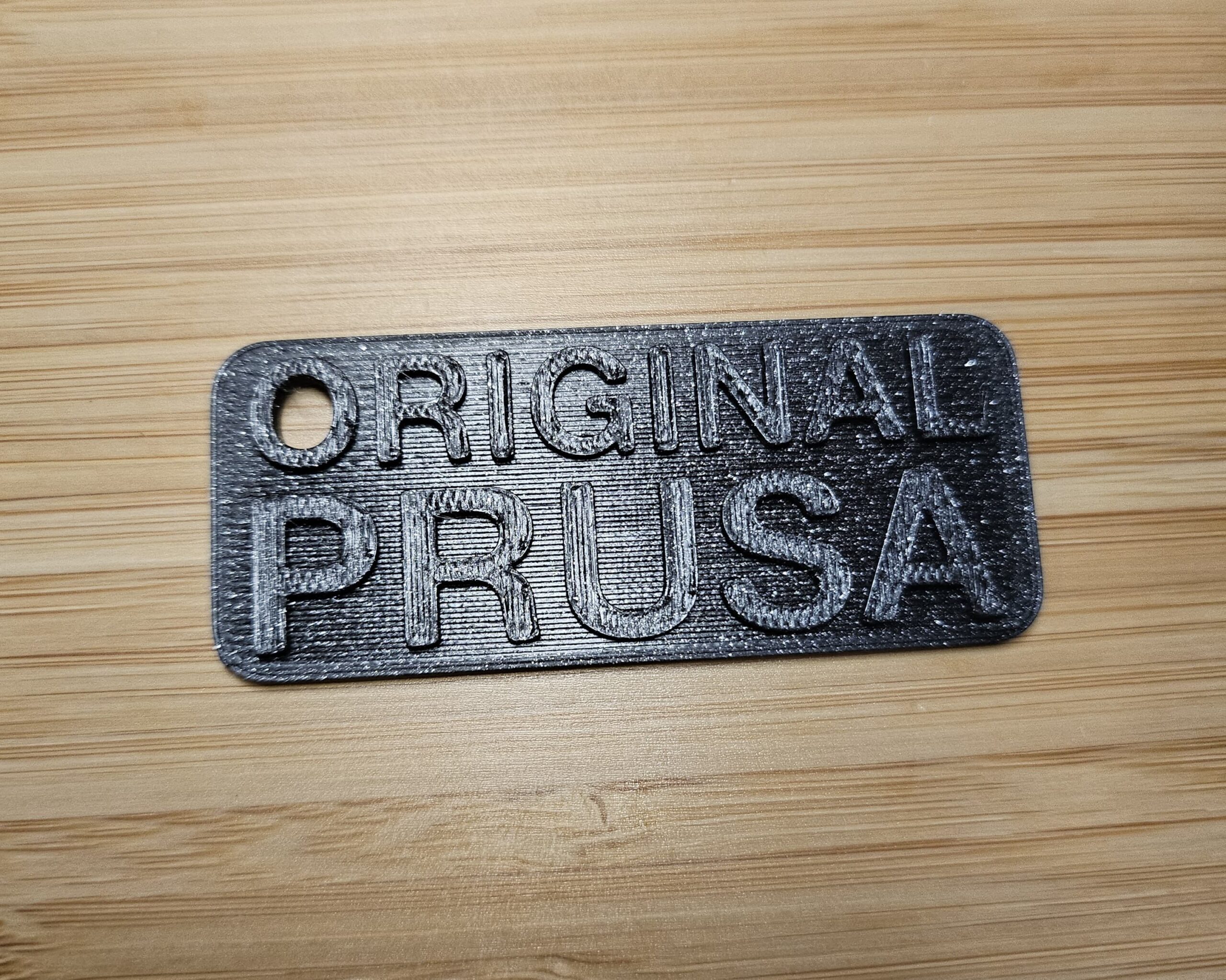

Hi guys. I wonder if someone could give me some advice. I've recently built an MK4 kit and I've been doing some test prints, using the sample filament that came with the printer and well.. Things are not great. Could anyone point me in the right direction as to what to try to fix this issue? Thank you in advance!

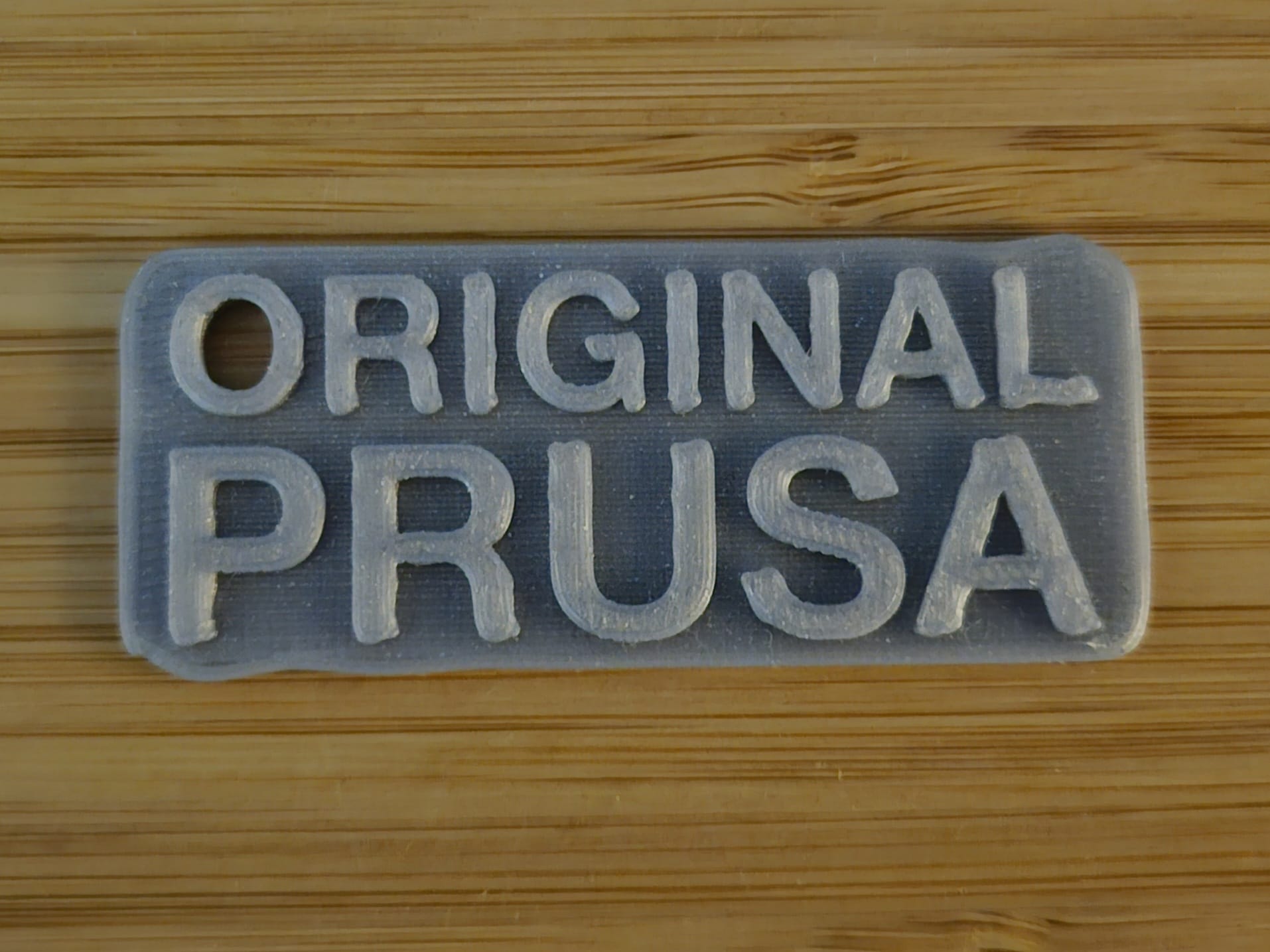

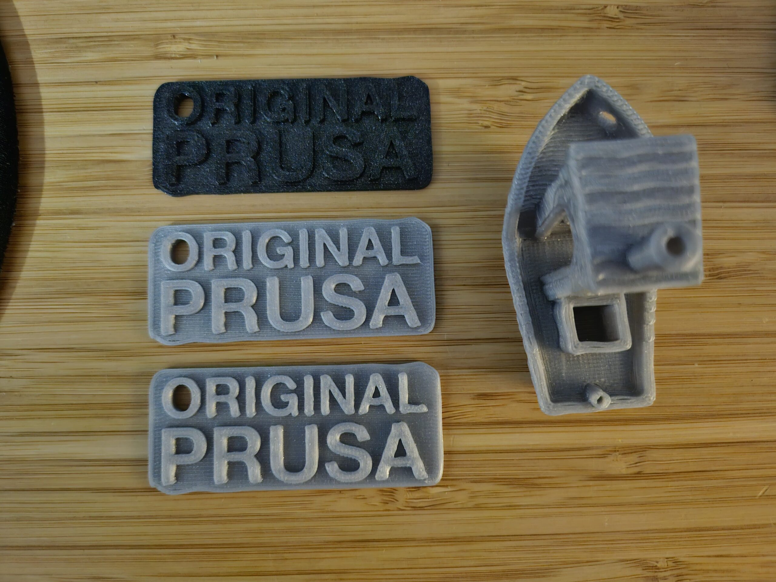

I can't seem to find a way to edit my previous post unfortunately. I just wanted to say that I think I've solved the issue. It would be nice to print more than just one object to confirm. But I am seriously low on filament right now (click on first image). It looks as though my Y-Axis (the print bed) belt was very loose. I spent around an hour using the Prusa Belt Tuner to get the belts on both the X & Y-Axis right.

This looks a lot better! 🙂
