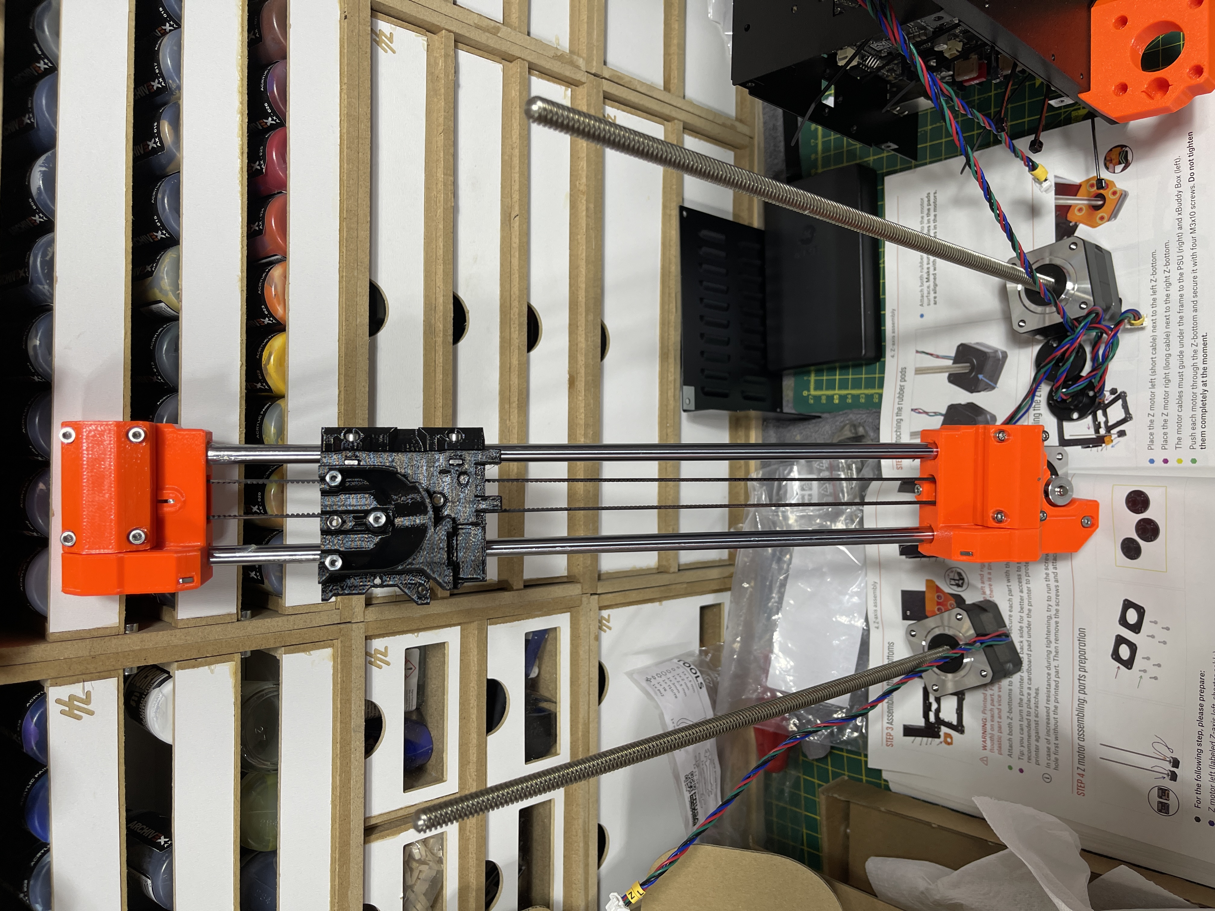

Everything went together smoothly and all self-tests passed. But when I put the filament spool on, both the nextruder back plate and the cable 'pigtail' hits it during the x-axis test. I even tried the 'narrow' bracket available here: https://www.printables.com/model/556491-spool-holder-mk4-narrow
Any ideas?

I think we are going to need some photos of you can manage please?

The pigtail off of the nextruder assembly
The back of the nextruder plate.

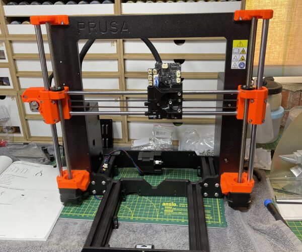

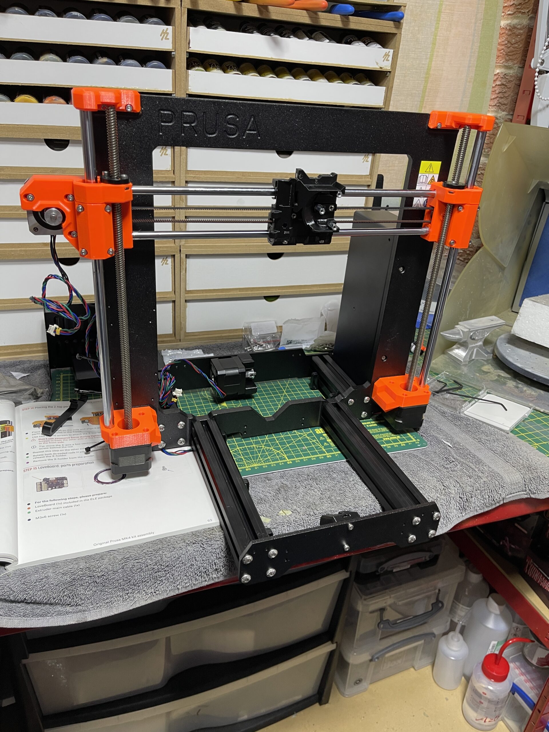

Can you post a picture showing the whole printer as I am struggling to get my head around what I'm seeing

RE: Filament spool bracket blocking x-axis?
Something looks a little off there, I’ll grab a couple of pics of mine tomorrow for you.

That's what I thought but could not put my finger on what, hence asking for a wider picture

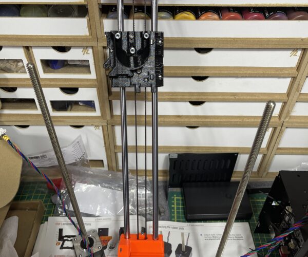

If I don't install the spool holder and just put the spool on some bearing mounts to the side, it works like a charm (see attached as it grinds out one of the test files).
This bracket is just barely hitting the nextruder carriage. (I'm holding the spool holder roughly in place just to show where it would go if it weren't being a jerk.)

Yep that's what it looked like. I followed the assembly instructions and every step went together as directed; no screws needed excessive force.
What's the clearance on your assembled unit between the pigtail and top beam and the back of the nextruder and the top beam?

The problem is that the filament holder used is not original to the MK4, but the printed holder was downloaded from God knows where. The original holder has a lower part that is much smaller than the one in the photo, and the X-axis cart can pass easily around it. Throw this bracket in the trash and use the original one.

That looks like a holder for the MK3 and earlier.  The MK4/Nextruder has less clearance to the frame and needs a filament holder mount made specifically for the MK4.   Similar problem for the MMU parts.  The MMU mount that clips on the frame must be thinner to allow clearance.
