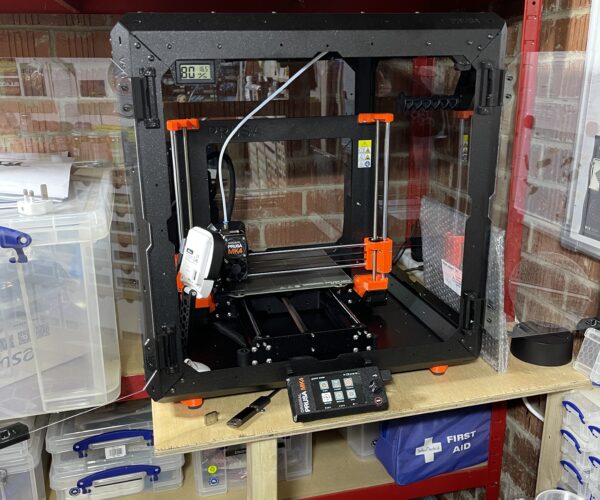

Hi All,
We just bought from Prusa and assembled the Enclosure for the MK4.
It's too short.
The printer measures 23.5 inches high with the filament spool sitting atop.
The enclosure is only 21 inches high.
We followed the Prusa enclosed QR code instructions to assemble the enclosure.
Have others made some kind of adjustments to the Enclosure?
Did you have to return your Enclosure to Prusa for a refund?
Thank you.

That's why they give you a mounting arm that fits on the enclosure to use instead on the one on the frame.
Instructions Chapter 4c, step 37 and 38
edit: and 39

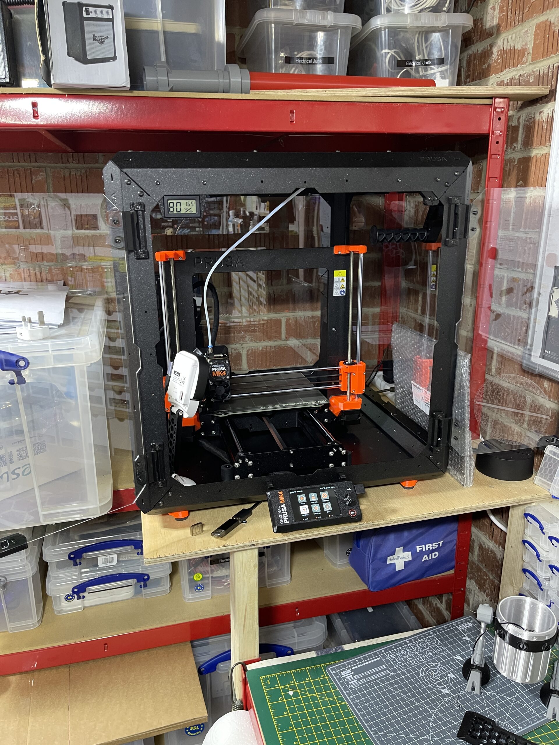

Yes, as @jp-guitars says, you need to remove the spool holder from the top of the Mk4 amd attach it to the side, you the. Connect the PTFE tube to the top of the extruder assembly and attach the other end as the instructions say. I have a mo4 kit assembled printer and the enclosure. I’m very happy with the fit etc and loading filament is a breeze!

It's difficult for me to see in the photo how you have the filament spool mounted sideways.
The cover to the Prusa MK4 Printing Handbook has the spool mounted up top so I haven't seen it ever mounted sideways as its mounted up top on the Lulzbot.

I'll have to play around to see exactly how one attaches the spool holder to its side.

And for reference the spool holder is attached to the inner side of the enclosure and not the printer
