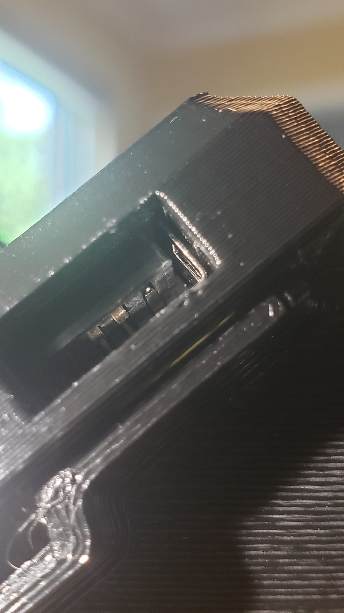

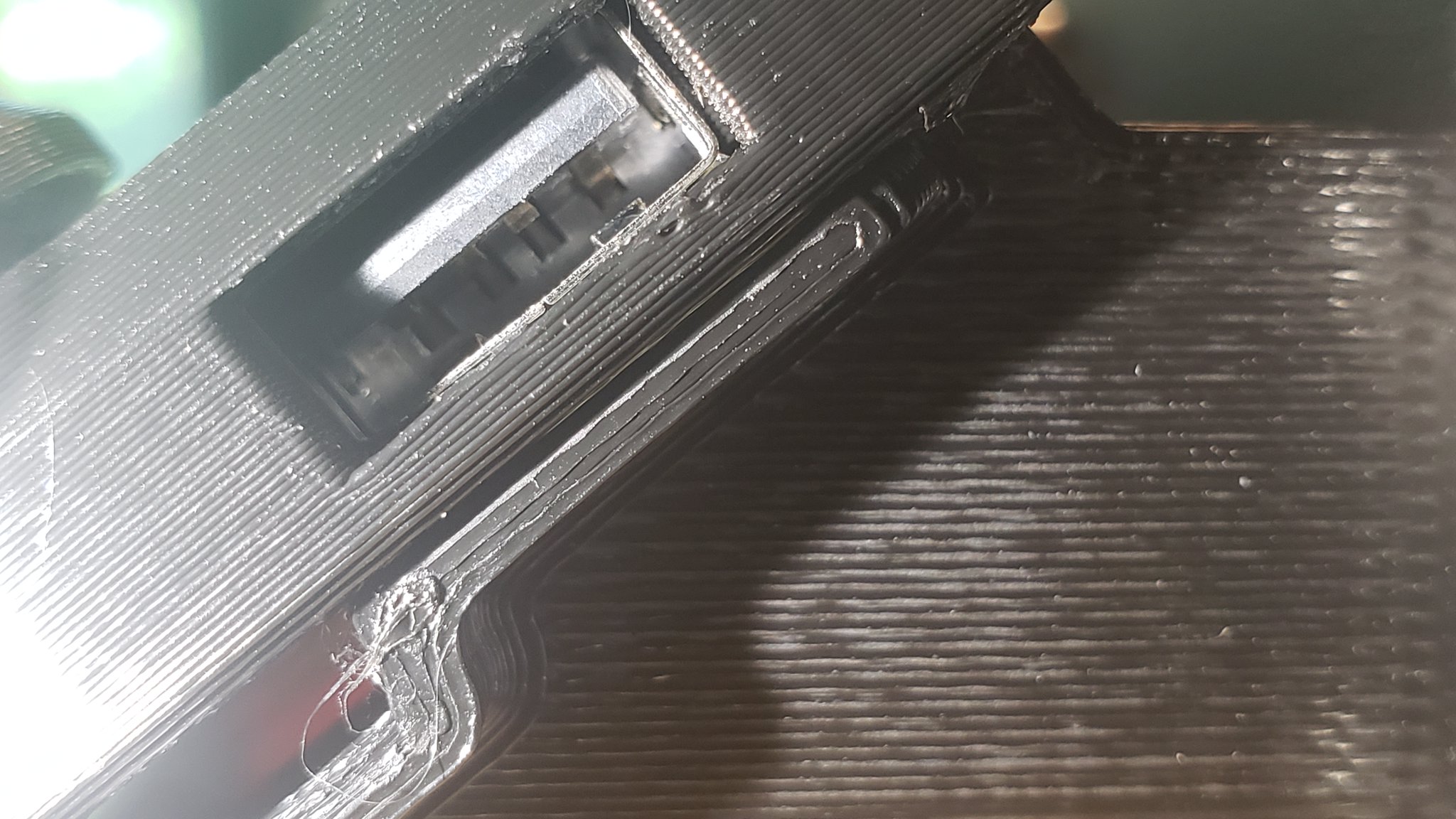

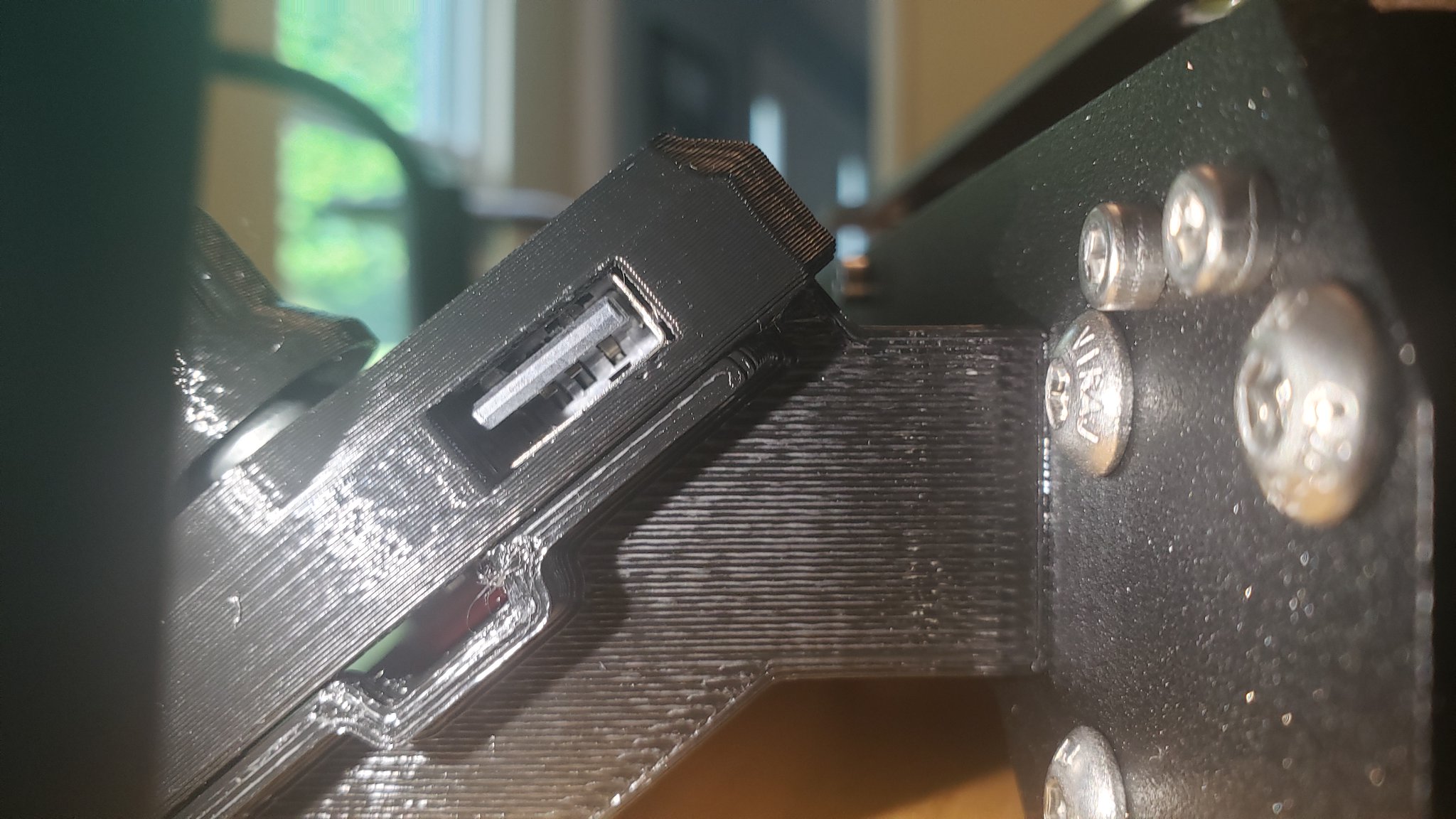

I was having a USB detection issue on my new kit earlier this week and figured I'd wait until this weekend to troubleshoot. Found this thread, looked in, and it certainly looks like a bent pin.
Some pics for reference for anyone looking themselves: (last pic shows it best)
Bent Pin on XLCD USB Port - Image 1
Bent Pin on xLCD USB Port - Image 2
Bent Pin on xLCD USB Port - Image 3
After chatting with support, they said they could replace the xLCD, but also said I could try to bend it back in place myself.
Posted : 19/08/2023 1:39 pm
