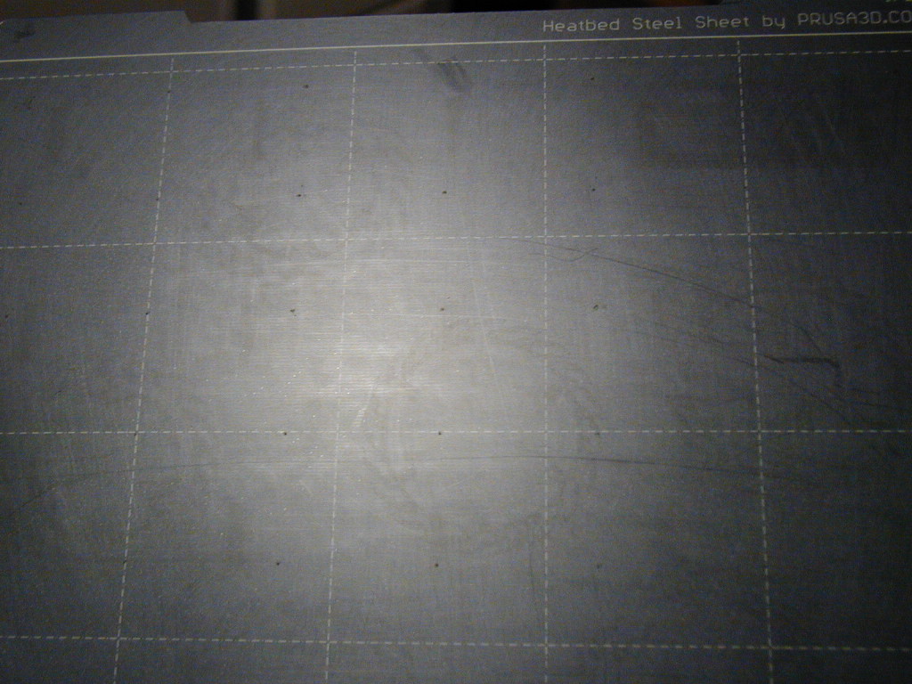

Always unwanted filament on noozle & sheet
The Mk3x start procedure was perfect. No filament on the noozle at print start, nothing at the end.
Our MK4 produces a lot of filament crumbs on the sheet, during Z adjustment and s.c. noozle cleaning.
And on every print there's a 10-20mm filament string left at end of print on the noozle.
Now all that unwanted stuff must be removed after every print.
It seems that the MK4 has the filament flow BEFORE and AFTER the print not under control.
Filament runs out as the extruder heats up...I used only prusament for that mashine since arrival.
Does somebody tried to "convert" the MK3Sx start gcode to MK4?
To remove that, in my eyes, nonsens "noozle cleaning /touching the sheet" to get a nice purge line.

Mk3S or + w/MMU2 does not touch the sheet during Z calibration, and that's why there are no crumbs.
Yes, the MK4 Loadcell sensor is a good thing, but before tap the points on the sheet please let the extruder turn a little backwards in next HW Update. I think this would be a solution. 1-2 mm is enough and there will be no crumbs.
This crumbs are hard to remove, the noozle presses small filament dots on the sheet -> you have to abrade them, get scratches on the sheet, this crumbs fall onto the heat bed and so on...

I would also like to see a customized launch code. On my MK3S+ with special startcode the nozzle is first heated to 160C, then the bed is leveled and the nozzle is homed. Then the bed is fully heated. The nozzle is still at 160C and is not heated to extruder temperature until just before printing. This is perfect.
With the MK4, the nozzle is first heated to extruder temperature, then leveled and cleaned, and only then lowered to 160C until the bed is heated. During leveling and cleaning, however, the entire bed is already full of filament pieces. Nobody needs that!
I have unfortunately no idea of gcode programming, but if someone could adjust the start code in this direction I would be thankful!

Heat the bed BEFORE leveling makes sense. It's better under print conditions than on a cold bed -> more real results. I'm sure prusa had a reason to do that.
I had no time to take a closer look when what temp. is going on, I only saw that some temp. instructions are in the MK4 start code.  I understand what you mean.
@MK4 - Heat the bed whenever you want, but I do'nt want crumbs on many of the leveling noozle touches left on the bed.

Careful changing the starting sequence.
I don’t have my MK4 yet. But when one of the first Mk4s came out, I saw a video of the start sequence. The nozzle was NOT heated to extrusion temp but like 170 °C instead.
What happened? Well, I saw a lot of people complaining they had bits of plastic sticking out that did not get cleaned, so the bed leveling by tap would mess up and the 1st layer would be way too high. If the MK4 now heats to extrusion temp in the cleaning and leveling, it’s probably to fix the improper cleaning of the nozzle that was throwing off the bed leveling.

The latest update does not solve the issue. No matter what filament you use.
These crumbs, sometimes up to 49? are hard to remove, the are pressed on because the noozle touches the sheet without a gap.  And important, AFTER the so called noozle cleaning procedure.
I can not believe it, but I got as answer from prusa, please clean the sheet every time. There's no issue...
I have no time for such nonsens and let the MK3's do the work until, someday? this will be fixed.
Does anyone saw a $1000 printer, or $199 wich leaves the bed full of filament crap after print? Everytime.

I really don’t like the implementation of the bed leveling. Filament oozes everywhere. There’s no guarantee there won’t be oozing.
Instead of heating the nozzle with filament in it at some mid temperature, they should pull the filament back out of the hot part of the nozzle first (nozzle is very long), heat up the nozzle without any filament in it, then do a nozzle clean and bed level. Once that’s done, push the filament back down and do a looooong purge line (like the MKS3+ w/ MMU2S).
