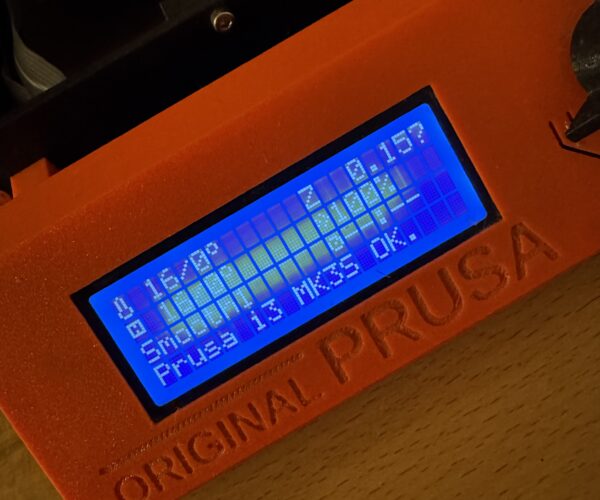

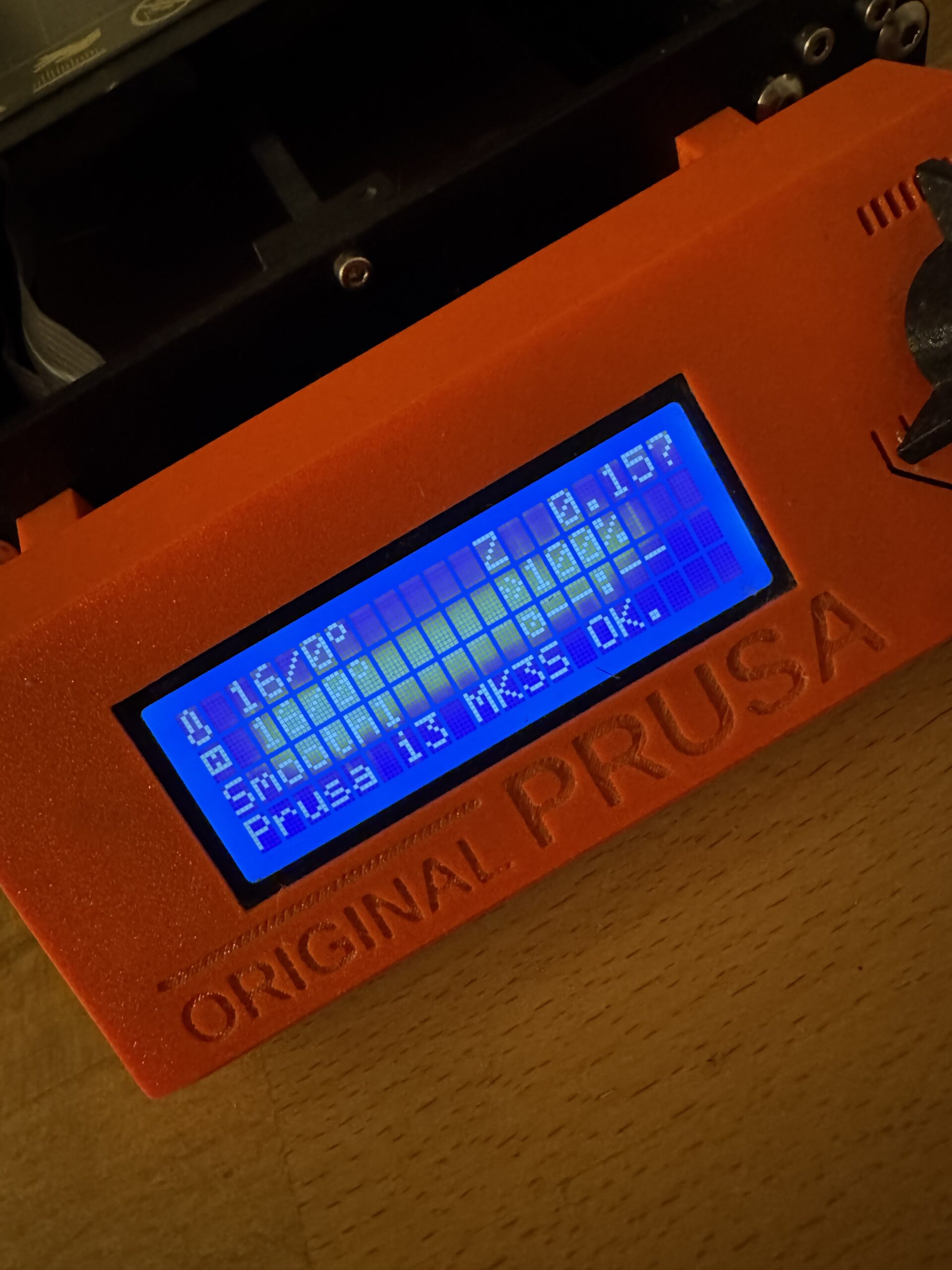

Hello,
Has anyone had similar problem with Prusa MK3S+ display?
What was solution?

When my LCD had a problem like yours I ended up replacing the LCD.
But, first check the LCD cables for any damage and then reseat the connectors on both ends.

You can adjust the brightness of the display at the back, or in the menu depending on your display version.
