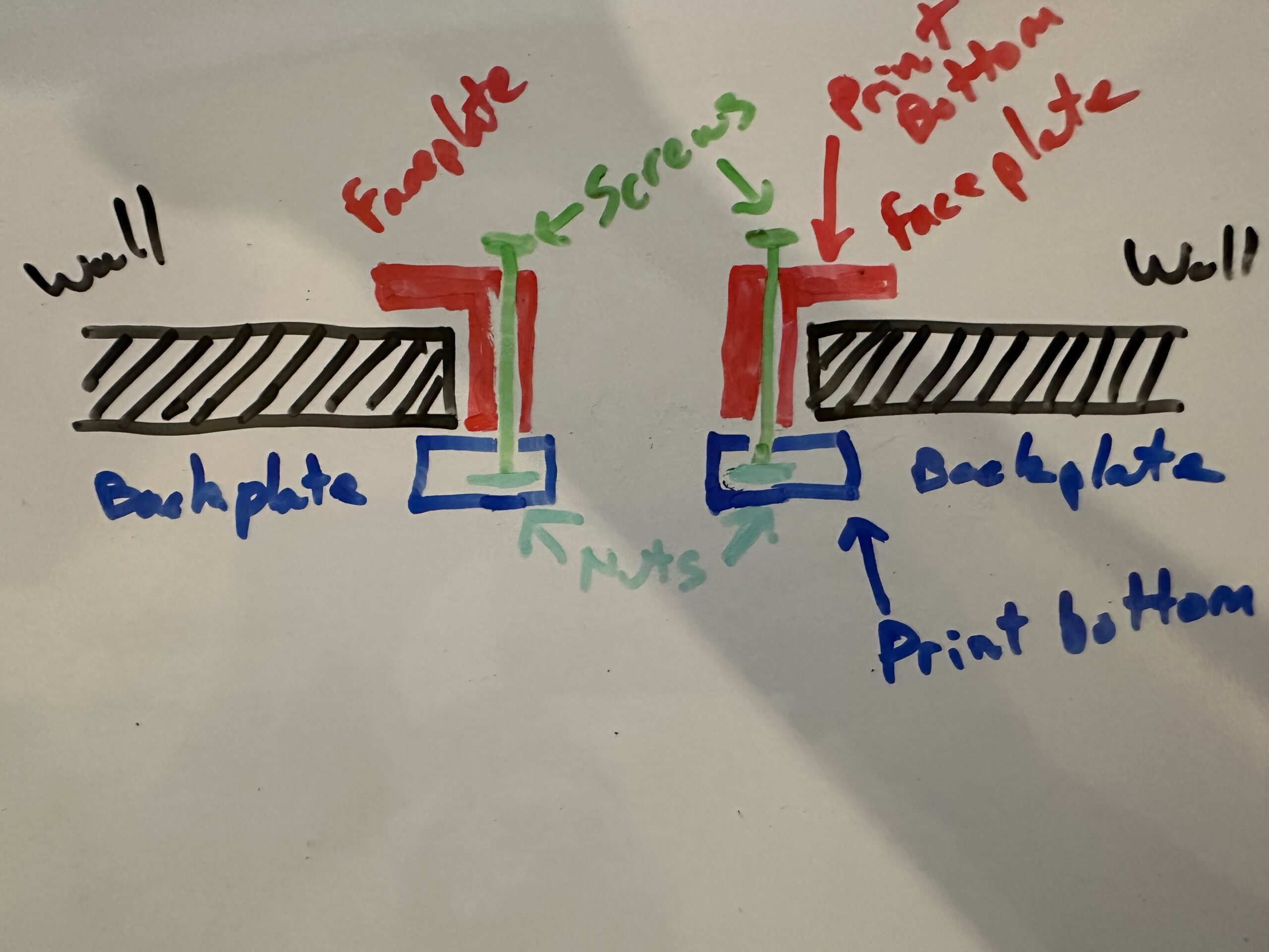

I'm making face plates for a ventilation system and I need to use regular metal screws to fasten the face plate to the "back plate" that goes on the other side of the drywall. Here's the rough sketch I drew on a white board:
Just for reference, of course, the two sides of the face plate and the two sides of the back plate go all around the hole, so it's one face plate and one back plate. The issue I'm having is that I want the nuts in place, on or in the back plate, so when I slide the back plate through the hole and have it on the other side of the drywall and inside the wall itself, the nuts will stay in place and not fall off or turn with the screws. I've seen a number of printed parts that allow a slot for nuts so they can be slid in place. I like that, but my problem is that those slots are always perpendicular to the "print bottom" of a piece. For reasons I don't want to go into here, the part of the back plate that has to go on the print bed (which is labeled in the pic) is parallel to the nut, so any slot I make for a nut will result in either an overhang or bridge inside the back plate. That would mean support material, which would be tough to clean out of a small area.
I'm sure this is the kind of thing a lot of people have run into with printing in the past: Finding just the right place and method to fit a nut into a printed object.
First, I'm open to suggestions - I'm hoping someone has a brilliant idea I haven't even thought of! But if that's not the case, I have a few thoughts I'd like to get feedback on. First, I could use something like a metal screw:
This is a simple solution, but I'm concerned that over-tightening it or having to remove it and replacing it a few times might lead to the threads basically stripping the printed hole it goes into, to the point where it no longer works and I have to print an entirely new back plate. What are your experiences with using this kind of screw on PLA and PETG? Does it strip the hole after a few uses so it no longer holds things in place?
Another idea I had is to pause the printer at a specific level, after it's printed holes in the back plate for nuts, then drop the nuts in place, then continue printing. I have yet to work with any prints where I pause the printer. Are there issues I need to be aware of for pausing a print? Can the printer pause the print and sit for a while until I drop the nuts in and resume? I have a number of these to print and it can be frustrating if I have to stay in the shop and wait for a pause, so it's not a preferred method.

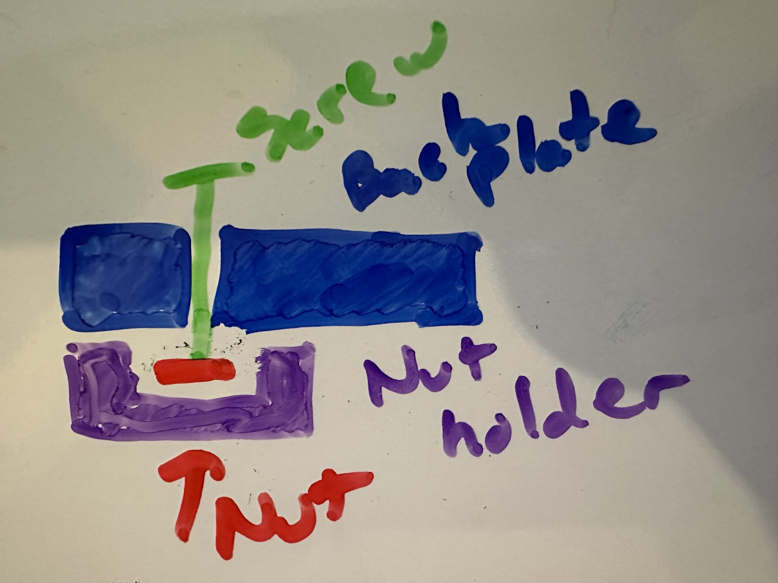

And the last thought I had was to print a nut bracket or holder, like this:
I could put the nut into the holder and glue it to the back of the back plate. Of course the glue has to be strong enough to hold the nut in place when I tighten the screws. (I have a tendency not to trust glue to be but so strong, so I know sometimes I'm underestimating the strength of some glues.) I also thought I might be able to design this so the holder has some snaps on it that would go through holes in the back plate, but that also seems like a lot of extra design and printing work and that there should be a simpler solution.
So what do you do to hold nuts in place in your printed projects?

If the forces used are not high, then you could design your holes and tap the threads into the material.  Add a couple of extra walls where the screws go.  You can also use self tappers into plastic as well.  Many piece of equipment is assembled that way.
In your second image, the nut should pull against printed material.  Or you need to make sure it is glued in place.
