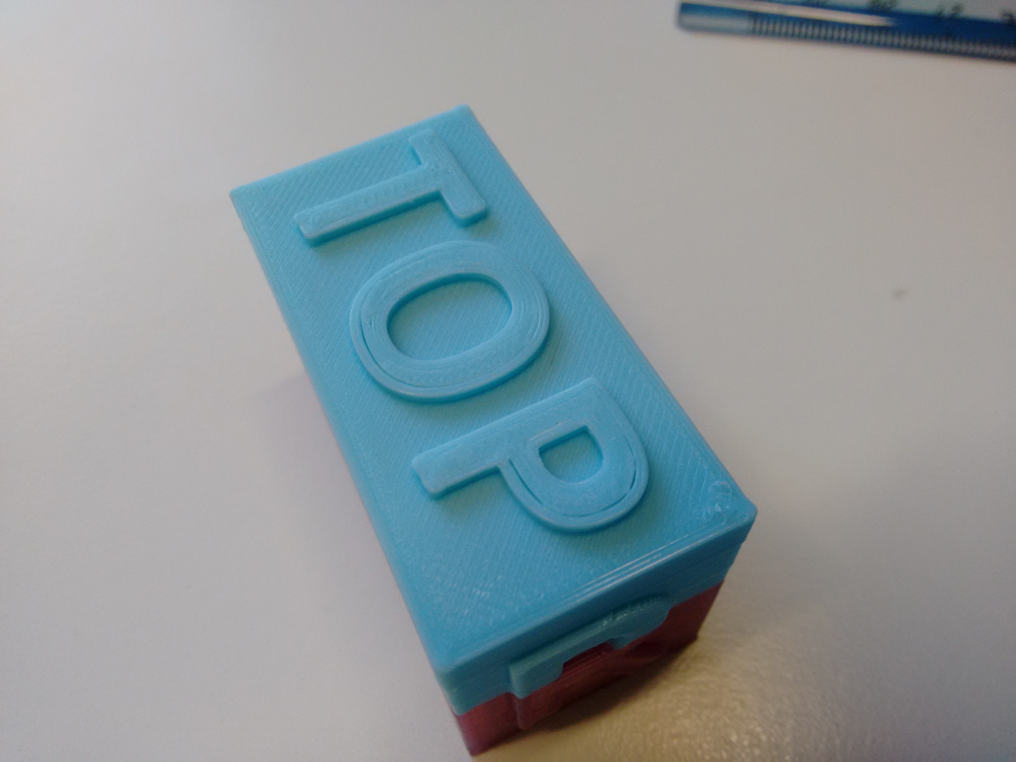

While thinking about glass, I simply tried the oldest trick in the book: heat texture transfer from a piece of glass to a PLA block. Here's a PLA block I printed with some left-overs to give it a try:
the top side is shown. As the texture "donor" I used a microwave oven plate, which had a texture I liked.

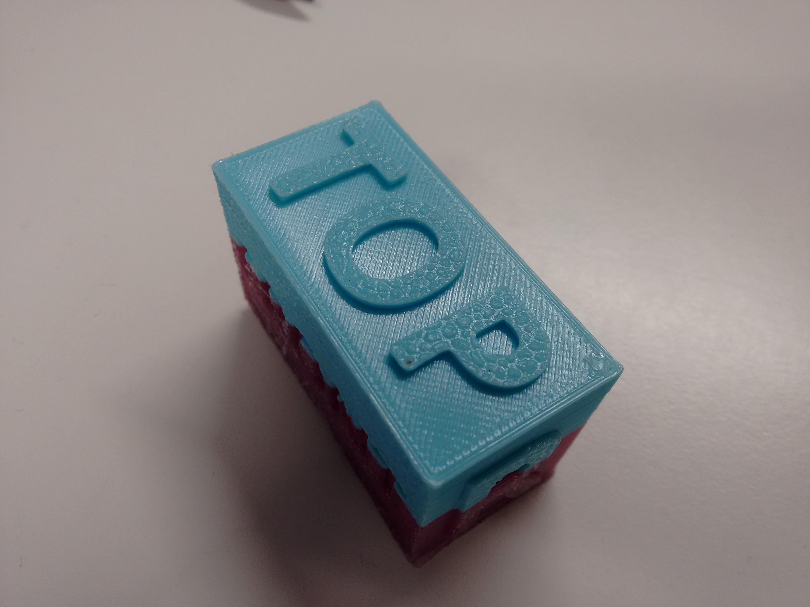

Here's the best result I got, which is on the top face:
Definitely promising. A few notes on the approach:
- The plate was slowly heated on top of an electric stove while monitoring the temperature with an IR meter
- I did several tries on the various faces with various times/temperatures
- Best result was with glass at ~140C, piece applied with moderate pressure for 3 seconds and quickly removed
- Dimensional accuracy wasn't affected (height unchanged when measured with a vernier) thanks to the quick action
After testing, I wouldn't use glass again as the texture donor. As you can imagine, PLA sticks a bit too much to glass and it does melt if left too much or with higher temperatures.
Large flat surfaces are tricky. The front side was "ok" towards the left, but I didn't apply the same pressure on the right, showing a reduced effect.
The obvious advantage of this approach is that you can modify any side of a printed object, not just one face. I think it would be worth investigating 🙂
Comments?
